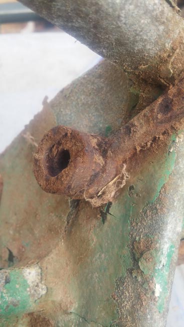

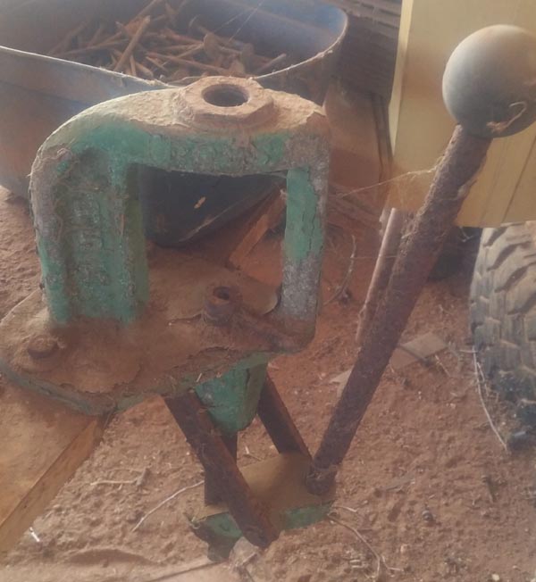

Hi everyone.
I found this press bolted to a table in an old disused shed on a farm i shoot.
The farmer never got into reloading & its been sitting rusting away for the last 20 odd years & he was happy for me to take it. (i cant believe i wasnt nosy enough to see it in the past)
I dont hold much hope for it producing concentric ammo because its well & truely rusted together & nothing moves, even the shell holder is one with the ram as it sits here, so there would be a fair amount of slop in the body where the ram passes, not to mention the shelholder once all the rust is removed.
But im the sort that cant help but grab these things & see if i can get it walking again, even if it is on a zimmer frame lol. Ity just seems a shame to leave it there turning to dust.
Even if it isnt able to work as a functional press, im keen to get it freed up.
Who knows, it might come up ok for a de-capper or priming tool :unknown:
Ill start with the obligatory wire brush & WD-40, but what after that?
I have in the past restored old rusted adjustable spanners by soaking them in a bucket of molasses for 6 six months & at random intervals pulled them out & wire brushed & tried to move adjustable bits.
But i dont have molasses now, & i assume one or more of you would have restored old rusted together things before, so thought id ask you knowledgeable types what might be the best thing for penetrating & breaking down the rust to start to free things up.

You could soak it in a bucket of white vinegar overnight then clean it up with steel wool and WD40. Or try some CLR liquid?

Lanolin works wonders with rust, as its composition stops the rusting process. I have used it on rust and watched it slowly disappear.
However, that press is too far gone to be a precision tool ever again. Once the rust is gone, the tolerances will be too big. Might be handy for something though you never know!!! Cool stubby top remover or something maybe????

You can also soak in diesel, if you have some of that on hand.

Vinegar, the good old diesel. Then oil I guess
I'm interested to see the "after" pics.
Also, tolerances required for a press are pretty loose. You just might get a surprise. Does look pretty rooted tho.

Take it to someone with a big ultrasonic tank or have it media blasted.
It might not be as bad as it looks and might be able to be used for things like depriming.

Like wannaroo said i would suggest getting a large ultrasonic cleaner the ebay ones might just do. Try Vinegar and water solution. If it doesn't work you can always use it to clean your cases
But soaking in wd40 with a green kitchen scourer or steel wool would be a good start too.

Vinegar dissolved rust. I read it on face ache, so must be true. Lol
It actually is true. Used it a couple of weeks ago. Got a great result.

I did an old BBQ plate like that a while back & it seemed to aid. Still takes some scrubbing though, but at 60 cents a litre you cant argue with its usefulness hey, ill probably give that a go & see what happens.

Google rust removal and restoration with molasses
It's the bomb

Yes i think ill try the molasses again. Ive located a supplier around the corner & can get it in small quantities for a couple dollars per litre.

Molasses is definitely the way to go. It's a slow process but gives really good results - does work quicker if you put it in a warm place like a small tin shed but good idea to cover your container with a hessian bag or something else that breathes to let the fumes out and to stop nasties getting in. Worlds best cockroach trap.
