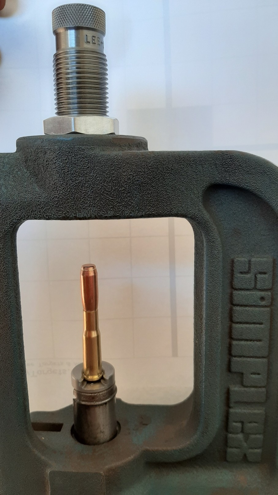

So I've just bought a lee pacesetter die set for 25-20 and last night realised they don't use a separate expander die, so I looked on the net and I see pretty much all the die makers don't.
I'd like to flare the cases for cast projectiles, so I'm wondering, do you blokes use a universal flaring die or should I buy a specific expander/flaring die for the 25-20?

So this might be a bit of a farmers solution haha, but I was able to expand them by taking the guts out of the seating die, and used a .308 168gr boat tail hollow point to flare the mouth.
The boat tail bottomed out on the narrow part inside the die and centered itself so left a perfect flare. Doe the job until I get a universal flaring die anyway
