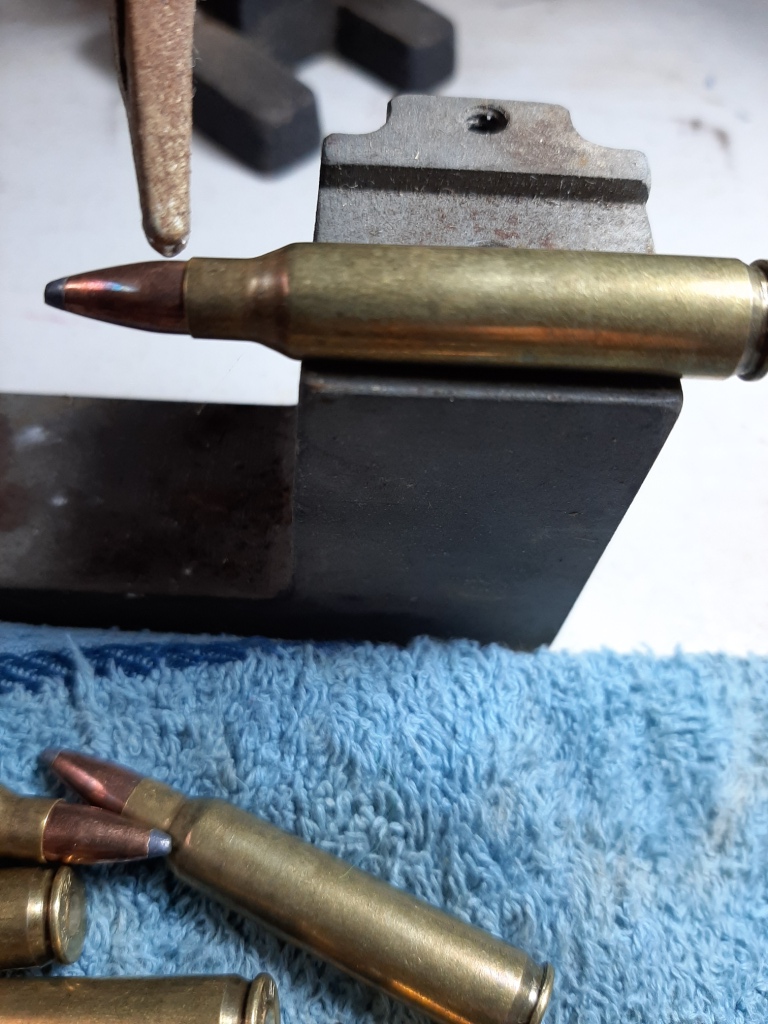

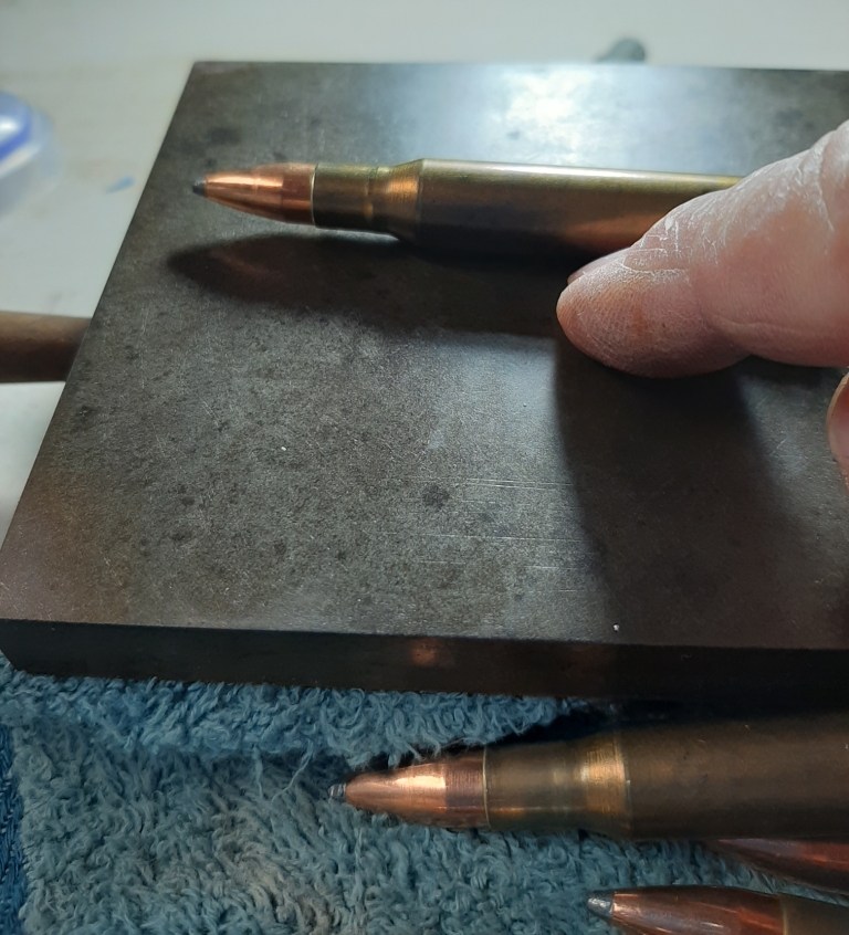

Post by Oldbloke » 23 Aug 2020, 1:06 pm
So, I tried two things.
Method 1.
A surface plate set up on a slight angle.
Using my finger I controlled the speed the case rolled down the slope.
Focusing on the light (desk lamp) shining between the bullet and plate I thought I would see an obvious variation. I think
you would only see variations of 0.010" or more. So of pretty limited use.
I reckon you could also use a piece of glass painted black to do this.
Method 2.
Rolling case on a small V block with a "pointer" very close to the bullet.
I could see 2 bullets that had some run out. TBO just a guess about 0.005"
I have put the dodgy 223 aside. I should have put the 3006 aside. Bugger. But it should show up when I complete my DIY Version.
Results
If I'm right with the 0.005" run out I'm not unhappy with the results. But I have no idea what 0.005" run out would result in at the target. MM??
Method 3. DIY
I have an old imperial mitutoyo dial gauge. (No obvious way to mount it today.) It still works OK. I have an idea for a DIY using the dial gauge that I think
will give much better results. Not hugely different to a few designs I saw on youtube. But I need to get a plate of steel to use as a base first.
I have also noticed that MMs system seem to amplify the run out due to leverage. Mine will not do that. So it will be inherently less precise. It will be a
KISS system. LOL But easy to make.
MM should I move this to the DIY thread. I don't want to take over your thread?

l will add a pic to show what is not seen in the original photo's
if when checking runout of the bullet you are having more than 0.0002" your case will have a big probability of being a flyer out of the group, not good
0.0005" is for plinking at best not for small groups, this may not be because of a case problem, it can happen from sizing or seating techniques
IMO to check for asymmetrical case wall thickness without the proper gauge you either check for overly thick necks on one side or after firing before sizing with your case between two v blocks check for wobble in the middle of the case with a dial indicator
or do what the old timers used to do, cull flyer cases out of the group? probably the reason they did not have huge amounts of cases, maybe 20 or so at a time
your methods eg.. rolling a round across a pane of glass is a good one for checking bullet runout because the glass will be super flat, if you paint it you will corrupt the flat surface

The design is basic. But I'm sure it will work reasonably well. Keeping in mind I probably only load about 100 rounds a year.
