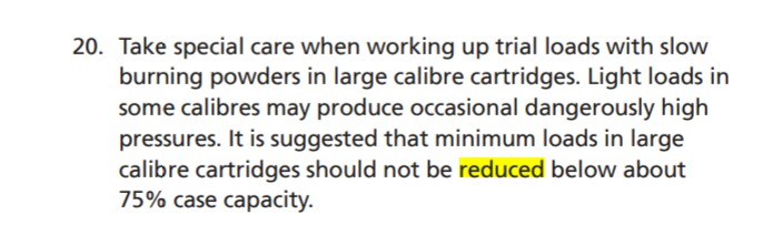

Post by Oldbloke » 04 Jan 2020, 7:57 am
Straight out of the ADI manual.
reduced loads .jpg (39.15 KiB) Viewed 5519 times
Reduced loads 60% max 2206H.JPG (72.59 KiB) Viewed 5519 times
