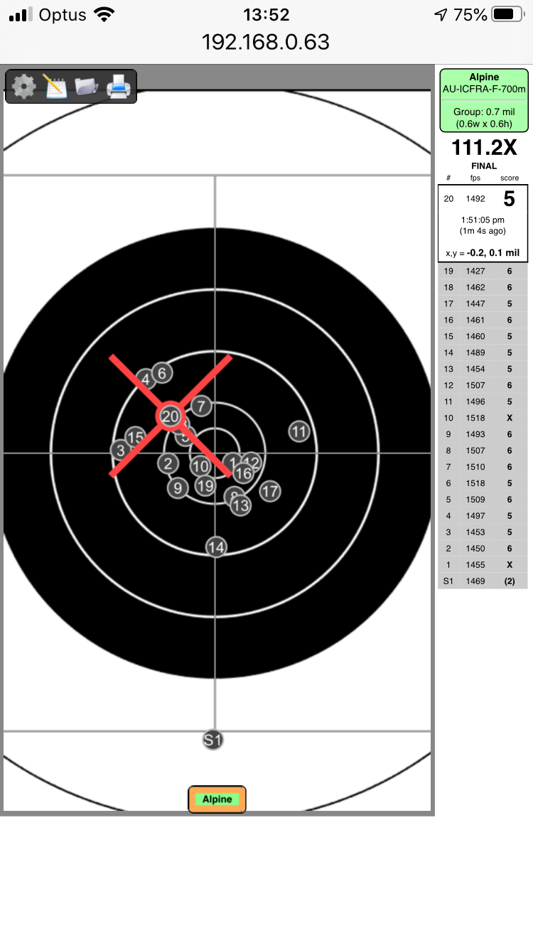

Overall, I am very happy with the chassis! I shot a 111 out of 120 at 700 in F-Class (Sporter/Hunter) this afternoon at Malabar.
I think the bedding is fine (I am always prepared to be wrong!) . When I installed it, I could feel the recoil lug engage with the action screws in - it had about 1mm movement forward and back. I ensured that it was to the rear as I torqued the screws.
Are there any telltales I can look for to tell if it is a bedding problem?

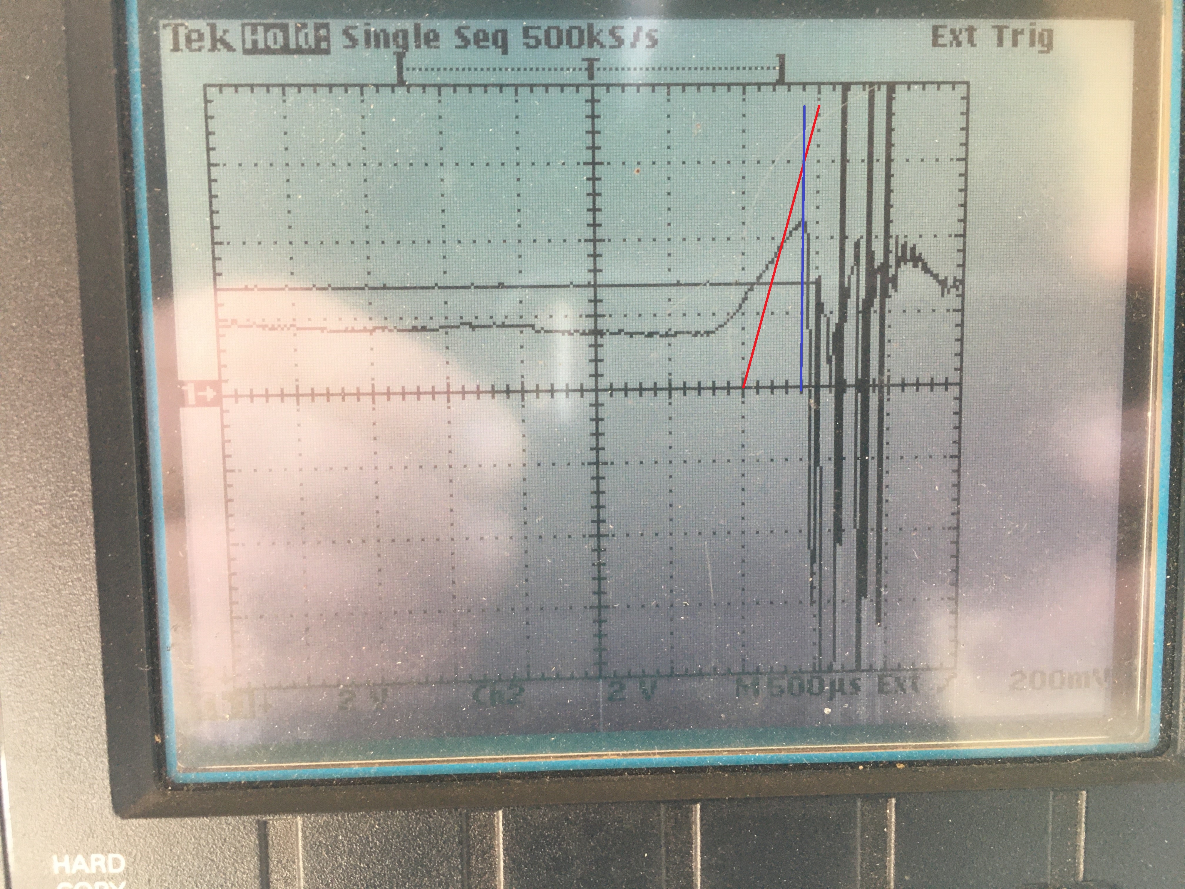

A semi success this morning. I managed to capture one trace on the 6.5. I planned to measure 10 shots to verify a consistent measurement. After the muzzle blast knocked the bullet exit sensor off the bench I decided I would do just that one shot and come back after finding a better attachment method.
The red line in the below image is the calculated rate of upward barrel flip I need to completely compensate for poi changes due to varying muzzle velocity.
The blue line is where the bullet left the muzzle. It is 1/10 of a division to the left of where the bullet sensor trace drops- that is because I have it 3.2 inches from the end of the barrel. Trust me on this...I laboured over the math for some time.
This trace makes me think I didn't need the bullet exit sensor anyway- as you can see the muzzle flip down rapidly when the bullet leaves.
What I can conclude from this measurement is:
1. I am not achieving complete positive compensation. I need to find a spot with a faster rate of upward flip.
<or>
2. I did the maths wrong and calculated the required rate of change incorrectly. I will redo the maths with a clear brain and a fresh sheet of paper.
I know......this isn't really a conclusion....... :?

Jarhead can you see any harmonics (ringing of the barrel) or are you just seeing the muzzel jump. The two are quite separate.
Posts: 939
Re: Load dev-how many shots does it take to dial in a rifle?
Post by Larry » 04 Sep 2020, 11:32 pm
The harmonics of a barrel have often been compared to that of a tuning fork. I wonder if you hit the barrel with a hammer or perhaps something a little less intense perhaps a steel bar if you could see the barrel actually resonate. On the scope you could work out the frequency this then could be used in all the maths and accomplish what you are after. Also offer a proof to some of the theories out there.
Posts: 939
Post by Jarhead » 05 Sep 2020, 6:45 am
Hi Larry,
I can assure you I am measuring harmonics and not barrel jump. The barrel jump on this plot occurs after 4.5 msec, when the CH1 plot goes off the top of the screen.
The instrument is so sensitive I could see my barrel harmonics on the plot when others nearby would let off a round. It was resonating with a stable waveform diminishing in amplitude.
I am measuring in the time domain, instead of the frequency domain. I can do both. On the trace, you can see the barrel ringing due to internal ballistics. It is not perfectly clear as the amplitude changes over the plot but there is a clear sine wave from 0-4 msec (green waveform) , and then another faster wave from 4-4.5msec (purple waveform).
You can calculate the frequency with formula:
F= 1/t
t being the time between two peaks of the wave.
So the green wave frequency is 1/2msec = 500 Hz.
The frequency of the purple wave is higher at 1/.3msec = 3.3kHz
The desired rate of change of the muzzle upwards has been calculated- 15.75 volts/msec. This can be represented as a tangent line on a time domain plot (red line). To improve accuracy I need to get the measured signal as close to the rate of change of this tangent line as possible. It looks to me that the measured waveform is steeper at 3.5 msec. So if I can make a load that brings the bullet exit closer to that, the vertical stringing should reduce.
I am not sure how a frequency domain measurement will make this easier to express but I am always willing to learn something new.
The theory of the barrel resonating prior to bullet exit is proven- this has been measured and it is consistent.

Post by Larry » 05 Sep 2020, 11:00 am
I understand what I am looking at mostly having been in the electronics field of work for 40 years. I think the time domain is the way to go. Using a spectrum analizer just looking at amplitude of frequencies would be very hard to decipher the timings of the different actions.
So did you pull the trigger at 3.4ms and it took about 0.6 ms to travel down the barrel exiting at 3.8 ms? and you wish to have it exit at 3.4 ms? if that is all true knowing the barrel length distance traveled of the bullet the speed can be calculated compared to the chrono for calc checks. The change in velocity that you want to occur can be pretty easily worked out and converted to a charge weight change, then tested both using the same setup you have now and verified using the chrono. I love the project hope it all works out for you. Keep us posted.
