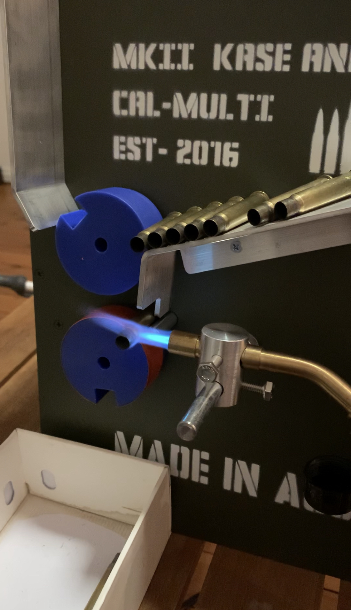

Just bought myself one of these:
Kase Annealr
I shoot Service, so benchrest precision is lost on me. Nevertheless I often seat rounds with the Lee hand press and an automatic powder dispenser, and I can literally “feel” when neck tension starts to go astray. Happens after recycling quite a few times.
The hand annealing approach with the dish of water on a turntable is not uniform. It might rejuvenate, but I have felt the necks just aren’t that uniform. Human error I suppose.
This machine was $500 and whilst it’s early days, the results seem promising. I annealed some x8 recycled 303 brass and seating feels good - nice and consistent, much better than the state they were in. Certainly breathed some life into the old brass.
In2.

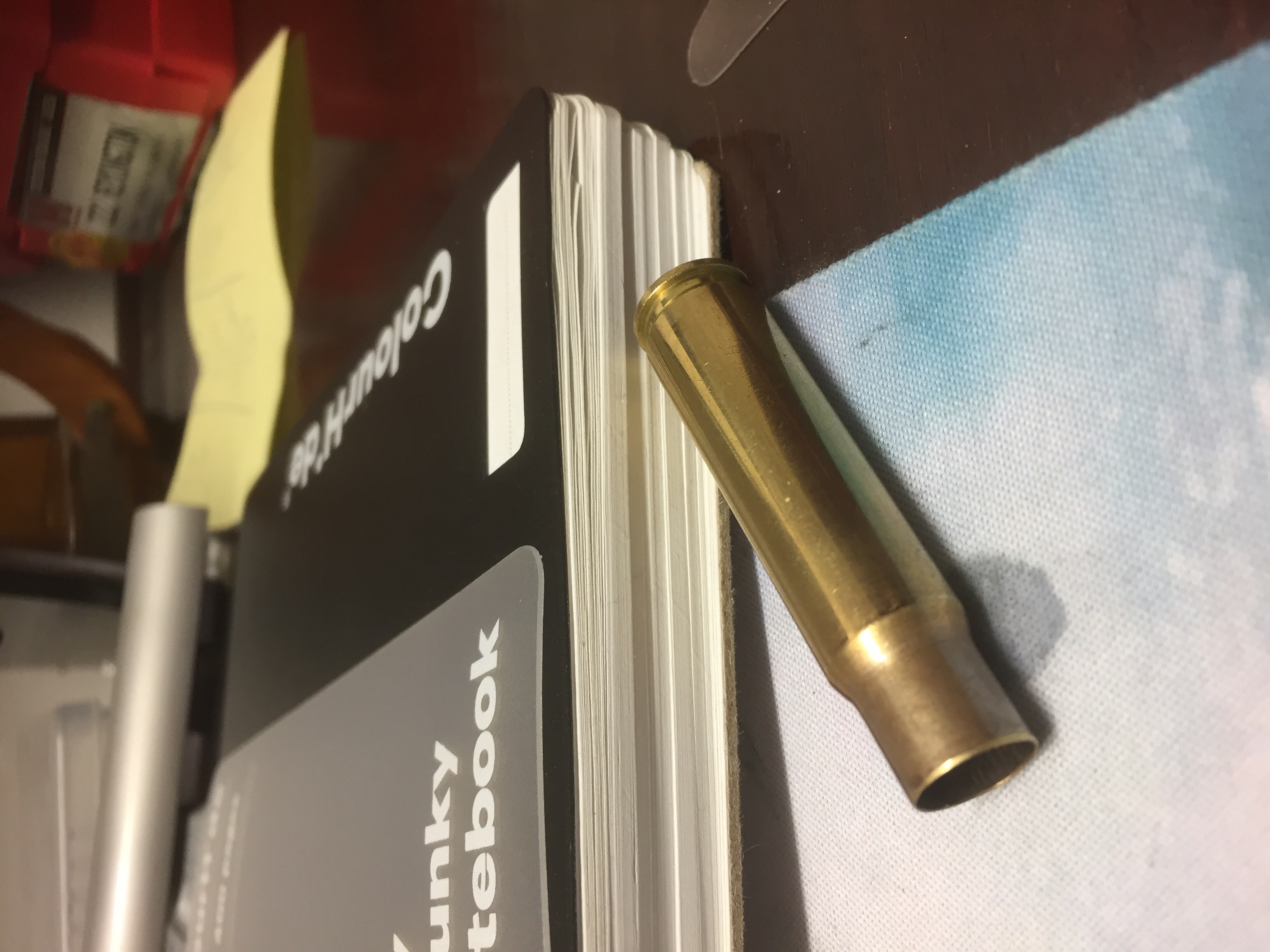

my annealing process is simple and appears to work. for anyone who is a tradie or has a decent amont of common sense, try this method
i got a adaptor that fits in the drill chuck for my ryobie battery drill i bring home from work , that takes normal hex sockets . the depth of the socket is important so as you spin the drill on low speed the rifle case sits in the socket without wobbling .using a $33 bunnings gas torch i hold the case to the inner flame as seen on another posters annealing machine . i count one mississipi, two mississipi etc , until the case turns a dark blue and is on the verge of starting to glow . then i tip the case into a bucket of water and start again . once the length of time is worked out for the right "color" on the case i repeat the same count with every case after . 308 PPU cases needed a count of 11 mississipi's to get the right look this is hardly a high tech way , but as accuracy has been excellent after resizing and annealing it seems to work . i hope this helps
:drinks: :drinks: :thumbsup:

It’s been tumbled after annealing, this is one of the cases discussed

Yeah nice BR, don't doubt that it's "good enough". You can also use a 2000w heat gun that produces temps up to 600 deg. The Ozito one will do it. Using a pair of pliers, hold the case by the base and shove the neck into the spout of the heat gun. Using a metronome app - for a .308 I hold it in there for 8 seconds, a .223 5 seconds and a 303 10 seconds - you should see the correct colour change.
