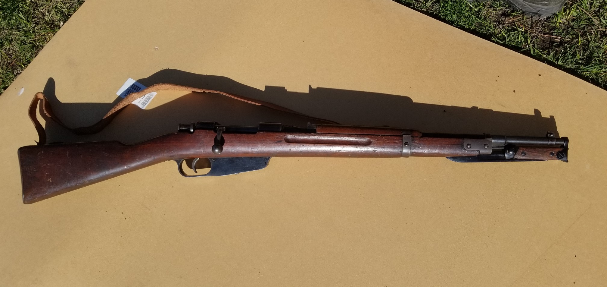

Post by bladeracer » 13 Aug 2020, 10:07 pm
Posts: 14002

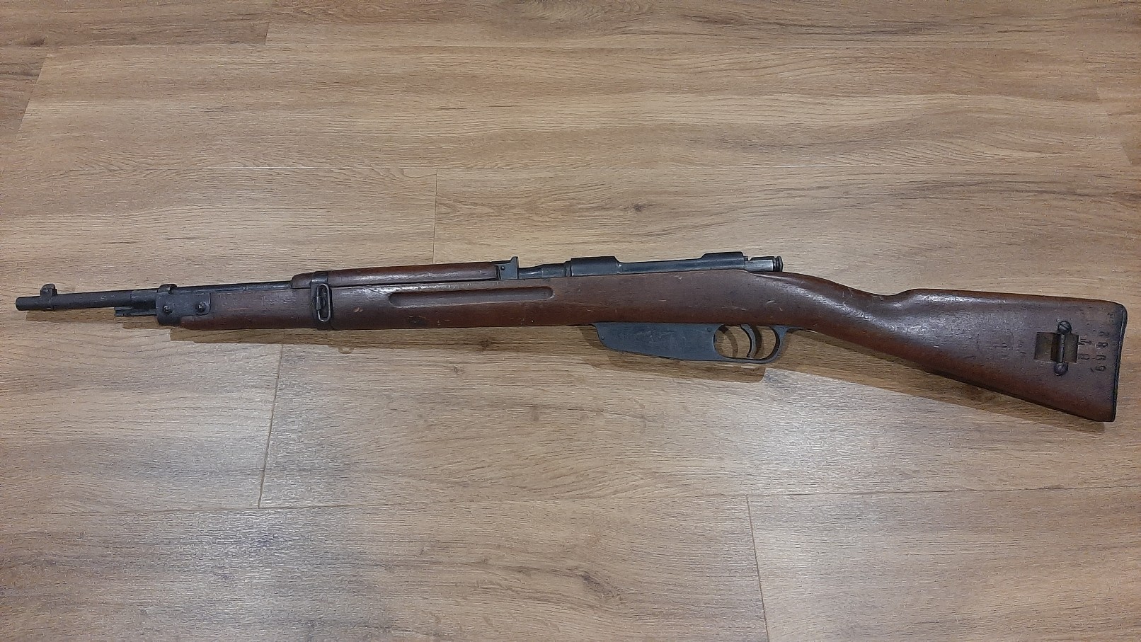

Post by Kelsey Cooter » 06 Sep 2020, 8:44 pm
Finally got it home today
