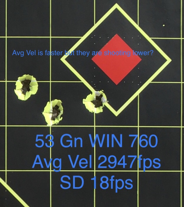

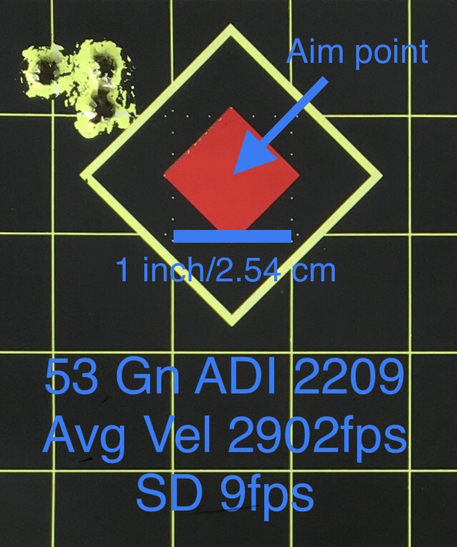

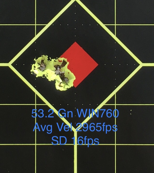

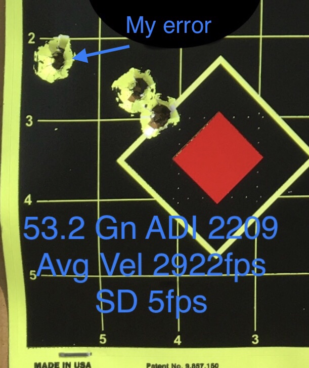

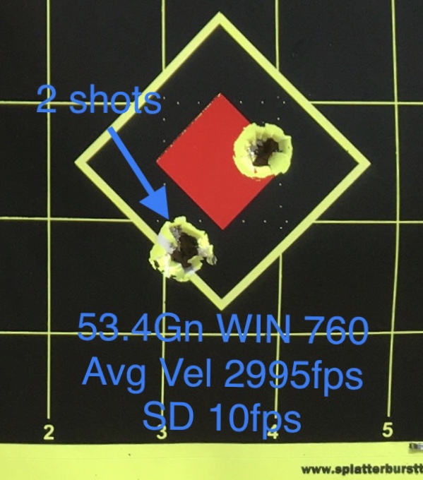

Post by Huntertt270 » 14 Sep 2020, 7:55 pm
Hi forum gurus,
I’m fairly new to reloading. I have a weird one.
Shooting a 270 Win, doing some load development.
The WIN 760 powder was giving higher velocities than the ADI powder but was shooting lower on paper. .????
I was shooting at 100yards.
Waiting 5-8 minutes between groups to let the barrel cool.
Chrono seems all good and consistent. I checked it against a mates rifle with his ammo.
Below are some photos to help describe things.
Any suggestions regarding what is going on would be appreciated.
Thanks
Huntertt270

Differences in velocity can change the barrel harmonics, resulting in higher or lower points of impacts.

It’s a fairly small sample size to be conclusive. The difference in charge weight between 53.0 and 53.4 is also pretty negligible - It might actually be an immeasurable difference at only 100yds (given the rest of the puzzle).
Could it be just that if you overlayed all the rounds on top of each other - that’s the inherent consistency of the rifle?
Also was the barrel stone cold after five minutes?
Also could fouling be effecting your groups? Is a freshing cut barrel?
People may put it down to harmonics, but the charge difference is just so small, I’m not sure how much harmonics would come into it?
Have you shot the rifle much before this? Does it group very differently with say factory ammo? Have you ever pushed it a bit more say 10 shots in blunder five minutes?

Probably just barrel harmonics, but I would not be basing any load development on three shot "groups". Fire at least two five-shot groups with each load, preferably staggered through the session, don't fire both groups of the same load consecutively.

Call it harmonics, if you want. Although in some circles, harmonics more refers to the identification of “nodes” often half or whole grain(s) apart (particularly for that volume of powder), where the gun has a tendency to group, measured over a larger sample size. The data up above is not that. The mere fact that you have two different outcomes from the same 53gr load indicates you have more work to do.
If you’re set on that general 53gr area, I’d run the exact same test, all over again. I bet the outcome is different, but basically the same, and that is, around 53gr of the win760 under chosen pill, averages (give or take) 2moa (or a bit less, if you take the other hidden variables out, like shooter error and perhaps a touch of windage). It is what it is.
BTW in my books that’s really not terrible, depending on your perspective. For a non-competition sporter rifle, to me that’s adequate. You're doing pretty well to consistently group under 2moa from any (and all) field positions, out in the sticks. I'd call that an adequate hunting accuracy,

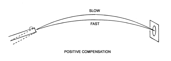

Try again at 200 or 300......I am sure it is barrel harmonics, you are firing while the barrel is swinging up so faster rounds are hitting lower as they come out earlier when the barrel is pointing lower.
A picture is worth a 1000.....
Postive Compensation.png (20.86 KiB) Viewed 4766 times
100 meters is in the middle of this picture, 200-300 is on the right. You are achieving perfect compensation when both powders are hitting the same spot.

I can see that some groups have one MOA horizontal dispersion from a three shot group. The last group has a MOA of vertical from a SD of 10 fps. From such a small sample it is hard to draw conclusions. Your results from the Chrono are half decent but the groups need work. Reshoot the best Group that used ADI powder. Use the Winchester ball powder in something else.
It doesn't matter where the bullet goes, as long as they all go into the same hole.
It looks like you might have had some wind on the day, get yourself some sort of wind flag that will indicate if the conditions are changing. Even a bit of flagging tape is better than nothing.
