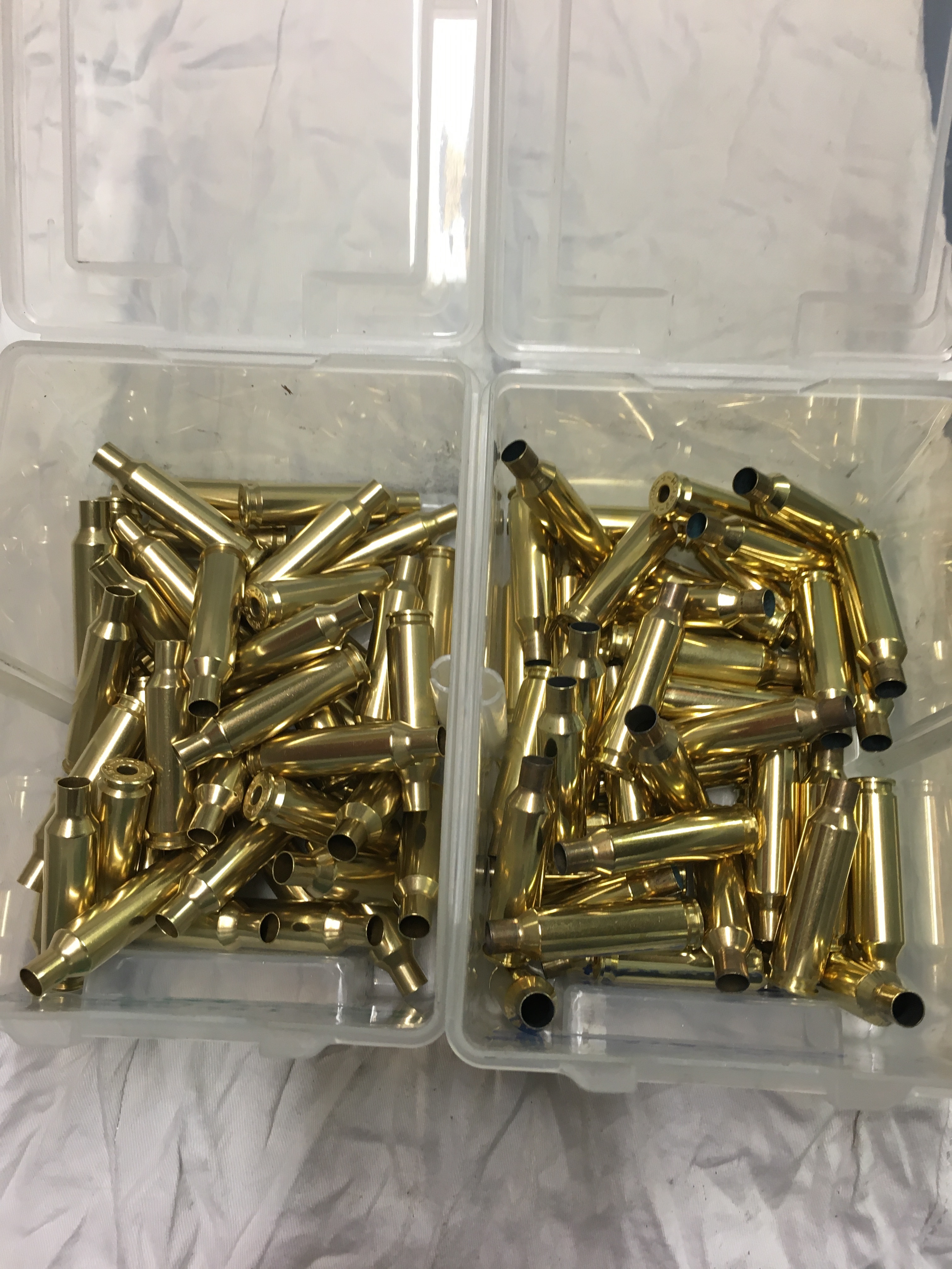

I am happy with the results I am getting- though the primer pockets have some residual crud on them. I suspect they will clean up with a few wet tumbles.
One is wet tumbled- one is dry- can you tell the difference?
Regards,
Jarhead
Savage MkII .22 (1040 fps)
Tikka T3 6.5 CM (2660 fps)
Jarhead
Posts: 187
Re: Wet tumbling- what is the Australian magic mix?
Post by marksman » 26 Aug 2020, 12:54 pm
the left are wet tumbled?
the primer pockets should clean up every time, if there are not you are not leaving them long enough
Post by Skinna » 26 Aug 2020, 2:34 pm
Left is wet.
Skinna
Posts: 238
Post by Jarhead » 26 Aug 2020, 2:42 pm
Nailed it guys!
