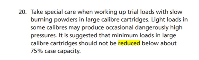

I would not stress.
ADI lists 110 gr bullet for 30-06 start 55gr.
Also,
reduced loads .jpg (39.15 KiB) Viewed 9702 times
Probably just not efficient. Best next time use the right powder. A good reason to use just one powder for everything.

Post by Oldbloke » 19 Jan 2020, 7:46 pm
If you full fill the requirements of 20 above it is safe.
BTW That is straig ht out of yhe ADI manual.
