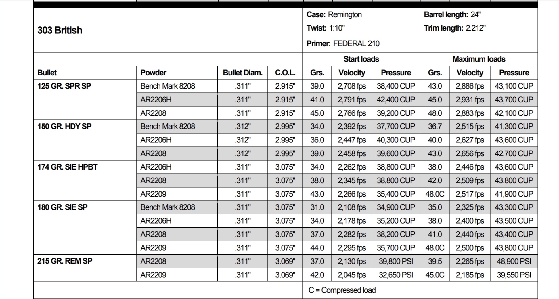

just after some reloading advice. Have a no4 mk1. am going to get a lee loader and will just be using rifle down the range. might get into military comp. does anyone have recomendations as to powder type and projectile type. ambition is to make it as accurate as possible, dont intend to hunt with it.

There are a fair few bullet choices from about 115gn up to 220gn depending on what you prefer. I have had zero success with .308" bullets.
AR2206H and Trailboss are my favorites, but AR2209 is a good choice as well.
Accuracy in the .303's is more about the rifle than the ammo I reckon, get yourself some good books on accurising the Lee-Enfields. If your goal is accuracy you'll be looking at competition bullets, I prefer the cheaper stuff. DocAV does some monolithic brass bullets that replicate the MkVII I think. I have some but haven't tested them yet. Otherwise the Hornady 150gn SP is a cheap choice for putting lots of rounds down range, might be useful for setting up the rifle before trying to develop precision loads.
You can also get a drop-in scope mount that helps you refine your loads during development.

Forget accurising your rifle if you think you may want to get into competition shooting with our club (Military Rifle Club) as we do not allow accurised rifles to compete in most comps, especially our monthly 3P comp. As for powder, most of us use AR2206H, with a few getting good results from 2208 especially with the heavier 180g + projies. What make is your No4? British, American or Canadian? The number of grooves may have an impact on your projectile choice with 2 groove barrels usually preferring a 150g flat base and many 5 groove preferring heavier. For best results you will need to go through the process of slugging the barrel and matching bullet diameters to suit. One "trick" of No4's is that some will not shoot well with flat base projectiles and some will not shoot with boat tails, so try both when you are load developing and see if your rifle is going to be one of the fussy ones. Our next comp day at Little River is June 2nd, if you are in the Melbourne area drop in and ask around the No4 shooters, we will be happy to answer any questions, Cheers.

I use the Lee loader/ Lee collet die in the press and 2208 and Trailboss in 303.

I loaded up some 180gr Speer RNSP using 34gr of 2206H, giving a tad over 2000 fps (basically a 30/30 equiv) Took it to the farm and tried it at 100m. Surprisingly, it gave me a 3 shot group of just over 1" , repeated, then on the third group it through a high flyer, litterally 3" higher than the group, repeated, did it again. Windage is perfect, just throws elevation. It concerns me a little as i like to have reliable hunting accuracy. Took the same load to St Marys 50m indoor range today, same thing. Nice 1/2 " 4 shot group, but with one with a 3" high flyer. Its got be beat. It seems like a load with hesps of potential, but the rifle seems to consistently throw the high flyer, usually just the one. Any thoughts ?

My .303 loads are 174 grain FMJ over 43grains of Win 760 for combined Services comp, 174 grain FMJ over 38 grains of AR2208 for my Martini Enfield and 150grain soft point over 38.5 grains of AR2208 for mucking around. These are mild loads, but I've managed to pick up a trophy or two in competition. With these old battle guns, fastest isn't always bestest.

Remember reading through a brittish forum when I was looking for the same thing,
A guy tried a lot of different combinations and settled on 180 grain projectile with 41 grains of 2208, I've been using it since and it's done well enough for me

Farmerpete wrote:180 grain projectile with 51 grains of 2208
Farmerpete do you mean 41 grains. I doubt 51 grains would even fit, let alone be safe.
Re: 303 british reloading advice
Post by Oldbloke » 17 Dec 2020, 9:19 pm
Must be 41gr.
Post by Farmerpete » 19 Dec 2020, 12:51 pm
Sorry I didn't reread before posting and my fat fingers hit the 5 I'll edit the original post now
