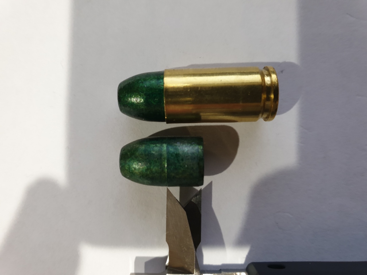

Post by Bsoamab » 22 Sep 2020, 10:29 am
Greatings everyone,
First time posting and just getting into reloading my own ammunition. Currently I am experimenting with developing my own load for 9mm shooting out of a CZ SP-01 Shadow using -
ADI APS450N
125gr Black widow LRN
Does anyone have any suggestions on -
Optimum loads for 130pf using the above powder
1.OAL
2.case mouth crimp
The OAL I have at the moment with a positive plunk test is 1.076-1.078 with a crimp diameter of 3.75-3.76.
Can anyone verify this data and provide some hints on powder grains for reliable loads?
Kind regards,
Ed
Bsoamab

You can of course experiment with longer length which means given the same powder volume, you will have less velocity. My suggestion is to arbitrarily pick a seating length as you have done and just keep the powder level the same while trying shorter seating lengths to see if they help or hurt your accuracy.
I personally always do it the other way. I always seat any bullet to cover the straight barrel. Then make small changes to powder load till I get what I want in terms of accuracy while the gun cycles correctly. I always start at the low end of the powder load and build up one tenth of a grain at a time.

Post by Zappa » 13 Jan 2021, 4:28 pm
"I always seat any bullet to cover the straight barrel."
pardon my ignorance. What does that mean?

Post by vmaxaust » 13 Jan 2021, 7:50 pm
Zappa wrote:"I always seat any bullet to cover the straight barrel."
The straight cylindrical (barrel shape) portion of the bullet before it reaches the ogive (slope). By the way, it doesn't have to be dead accurate but you should ask the bullet makers suggestions for a start point seating depth. By all means do the simple drop it in the barrel test to make sure it's not hitting lands. If it's a light weight bullet you don't have enough length to poke it right out close to the lands.

Post by Zappa » 14 Jan 2021, 9:11 am
gotch. thanks for explanation.
