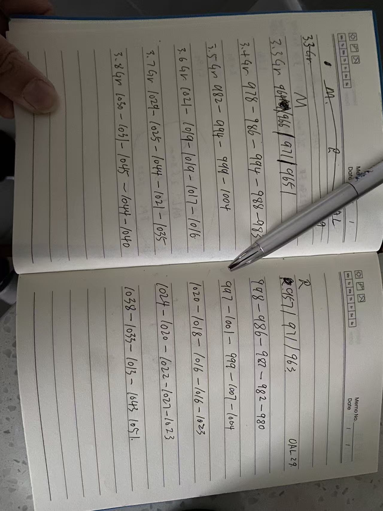

Post by Bruce.Z » 30 Oct 2025, 3:24 pm
Hi, everyone
I did some 9mm load with the below result. Hope this can give you some clue.
Pistol: G34 gen5, all factory.
Projectile: 123gr Tigershark cooper glad
Primer: Left side in the photo is Magtech small pistol primer, right side is RWS small pistol primer
From my own experience, it works on my G34, but really need grip firmly or it will have a cycle problem. 3.8
3.8gr load with no over pressure sign on case. And this just reach the minimum PF for ipsc.
