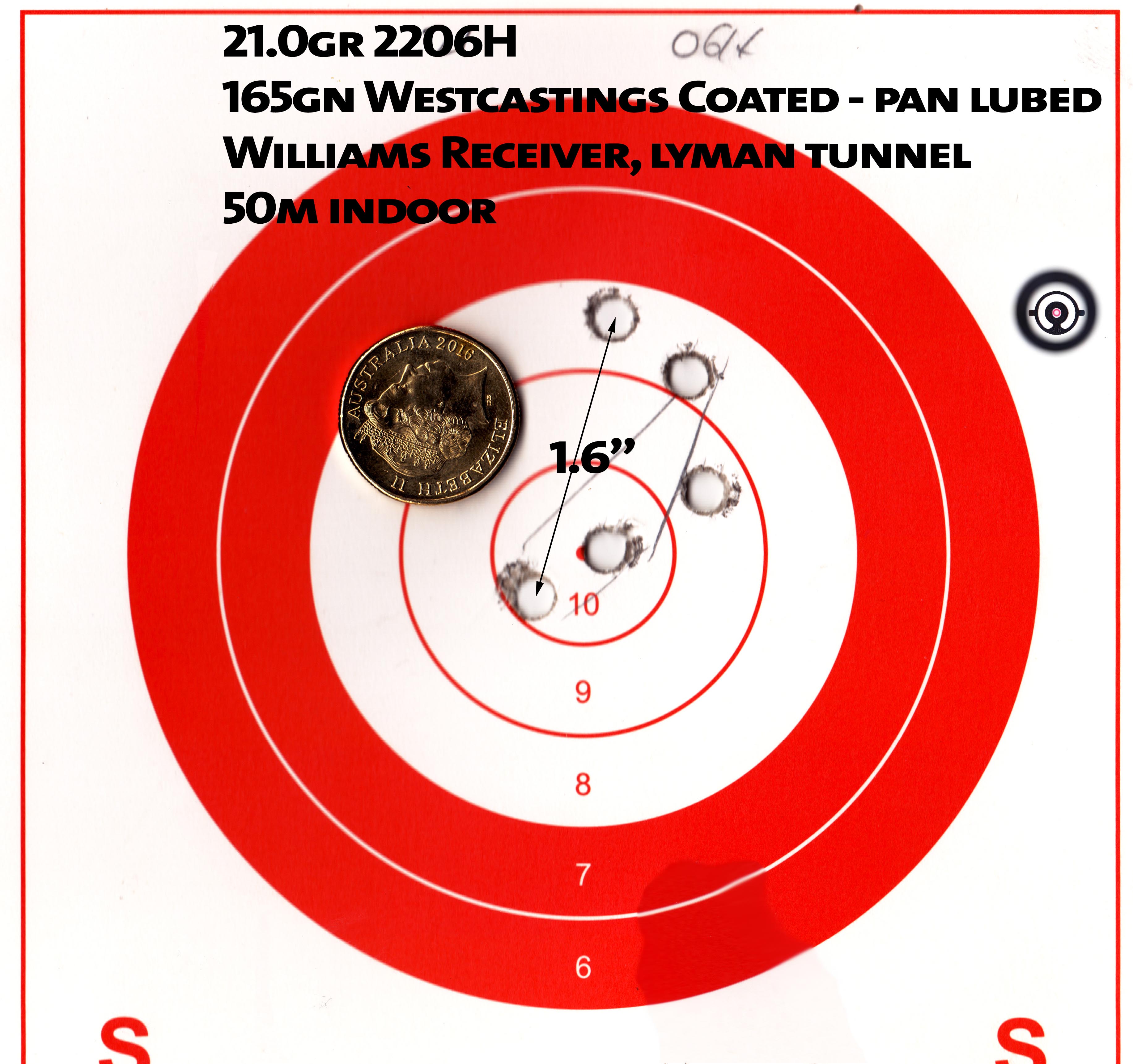

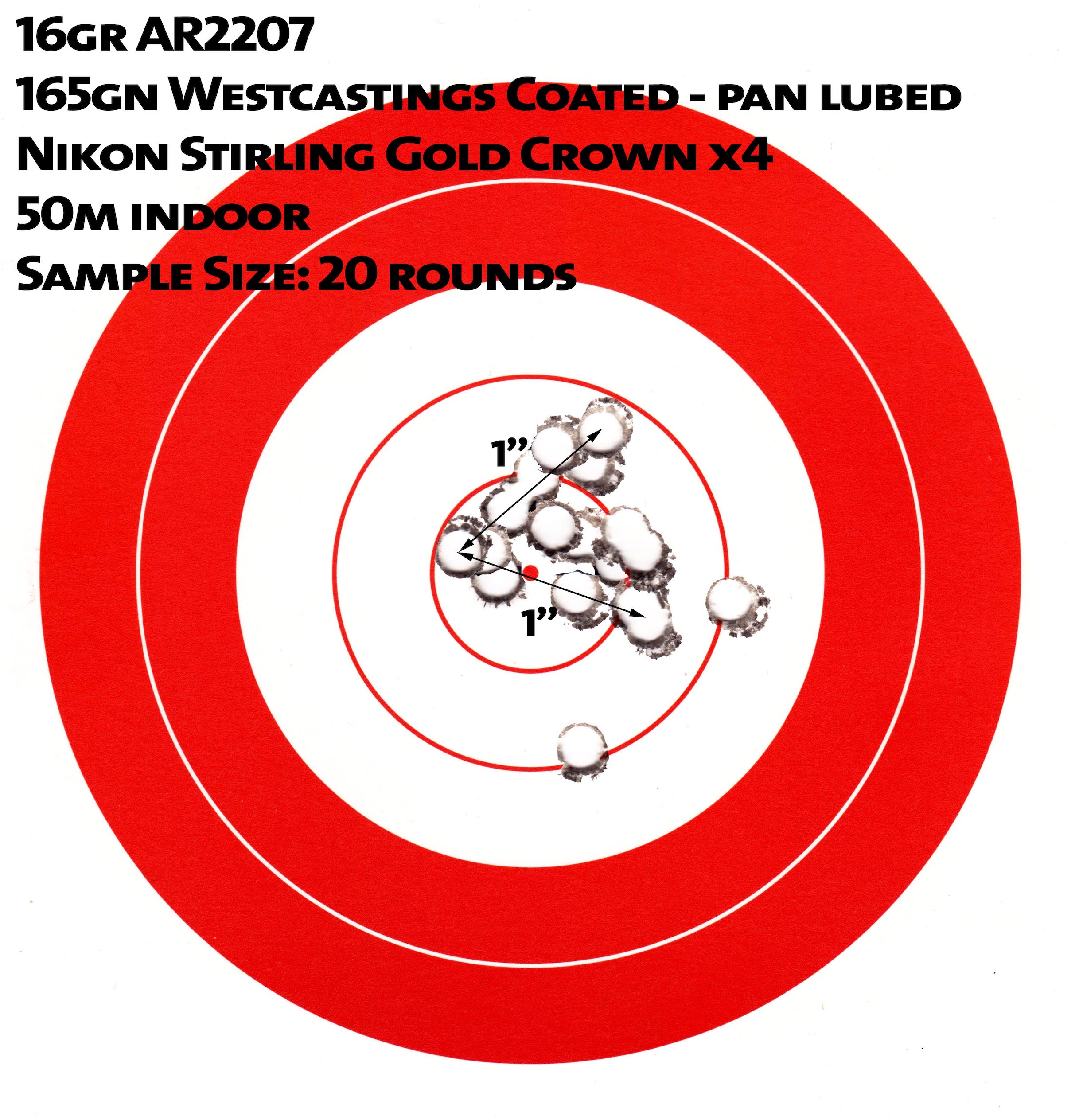

In a microgroove 30/30, using checkless lead, AR2207 is better. AR2206H is just fractionally too slow burning.

Post by LawrenceA » 25 Apr 2021, 8:58 pm
In a microgroove 30/30, using checkless lead, AR2207 is better. AR2206H is just fractionally too slow burning.[/quote]
Damn I like that!!!
Gunna have to try for myself.
Any idea of the velocity you are achieving?

Post by in2anity » 25 Apr 2021, 9:00 pm
Damn I like that!!!
Any idea of the velocity you are achieving?[/quote]
Was about 1500fps, from memory LawrenceA.

Post by in2anity » 25 Apr 2021, 9:04 pm
LawrenceA wrote:Can run pure lead at that rate!
:clap: Sweet!
They were hard cast alloy, not pure lead. BH of around 15.
Also, before each shot, try bumping the buttstock on the ground to get the powder stacked back onto the primer.
