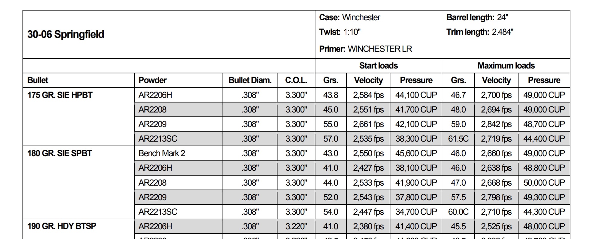

Pick a powder to use probably ar2208 work on a ocw (optimum charge weight) in 0.3grain increments i usually set the bullet 20thou off the lands and usually find something that shoots under a inch easily if not half moa. It can be a fiddly game but well worth the effort. I have found that the 168g proj seem to be the sweet spot for most of my 30 cal rifles and anything I've played around with.

Yes, generally you improve accuracy by reloading. Both my 30.06s like 150 to 180gr bullets with AR2208 behind it. My 3 centre fires are all abt 20 though off the lands. In all cases a tad under MOA for 4 shot groups.
As Azza said, start at the low end and work up abt 0.3gr at a time. Watch for pressure

I’ve loaded the 178 EldX in 30 06 with AR2209 with around 1 moa at 100 metres performance. Rifle was Tikka lite. Never tried the factory loaded offering. Quite interested that more than one person has suggested AR2208 for the 30 06. I kinda though ar2209 would be the goto powder for a 30 06

Yep, 2209 does have advantages esp heavier bullets.
But 2208 is more versatile
