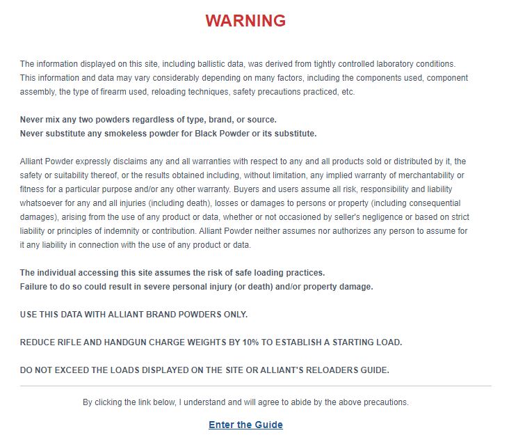

I don't know, but 2400 is similar to AR2205 in burn rate, which would be my choice anyway. ADI list 20gn max of AR2205 in pistol and rifle loads with 125gn jacketed bullets.
Alliant's 17.5gn 2400 load lists 1409fps, ADI's 20gn load of AR2205 is 2122fps in rifle, and 1849fps in pistol, so a 1409fps load doesn't sound very hot.
From Alliant's website, start 10% lower than spec, so 15.75gn.
Alliant Load Development.JPG (86.14 KiB) Viewed 8249 times
