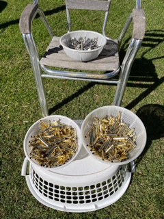

Post by Bello » 26 Aug 2021, 5:55 am
Hi Mate
Clever firearms had a special on a Lyman tumbler, it included stainless media and one portion of cleaning solution.
Being lock down, I couldn't resist and bought it. :D
I will have to see what size the media is and get back to you. But it was Lyman media.
You have to watch the stuff, it's like an escape artist, I am finding it everywhere :lol:
Does a good job. I bought the Hornady tumbling solution and they come out nice and shinny (I only use a cap full of solution per wash in hot water).
I tumble for an hour.
The case do go dull over time.
It can be a little hit and miss with primer pockets. Some get cleaned really well and others not so much.
Untitled attachment 00017.jpg (62.93 KiB) Viewed 2385 times
