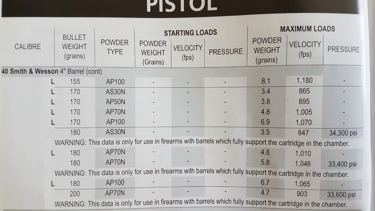

This is all I have for the 40 Smith and Wesson , 10 mil as50 is too fast understandable ap70 would be your best friend and most of calibres that is like rocking horse s*** at the moment.
Posts: 2822
