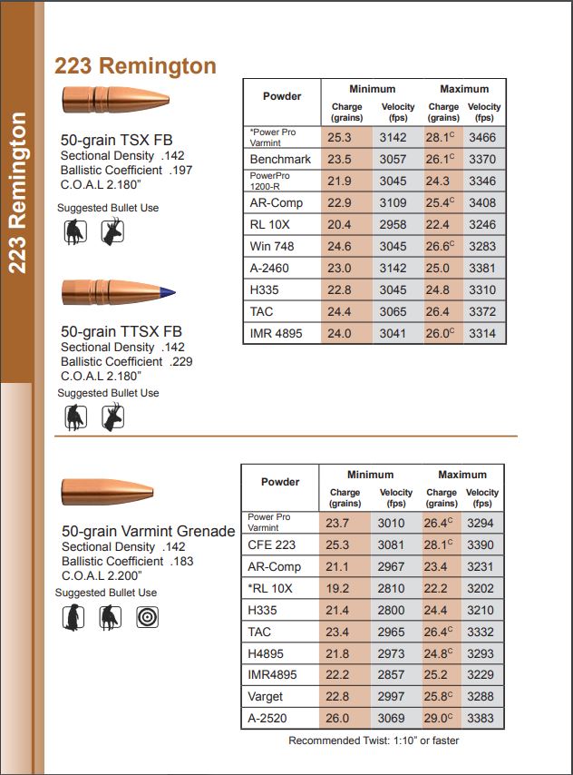

Anything over about 25gn of AR2206H is likely to be compressed if the bullet is seated to the standard 2.260", if you can seat longer it will give you a little more capacity.
Check the case length is within spec, if it gets too long it can crimp the bullet into the rifling.
I don't think magnum primers would offer a significant benefit, but there's no harm in trying them if you want to.
This is Barnes' load data page. https://www.barnesbullets.com/wp-content/uploads/2021/05/223RemingtonWeb.pdf

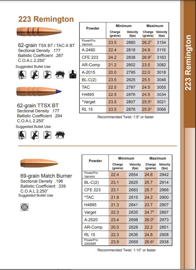

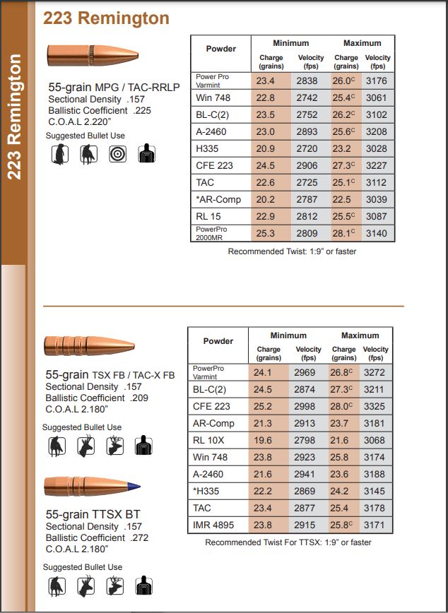

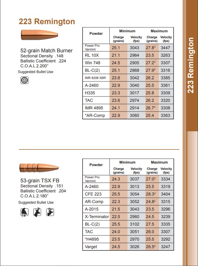

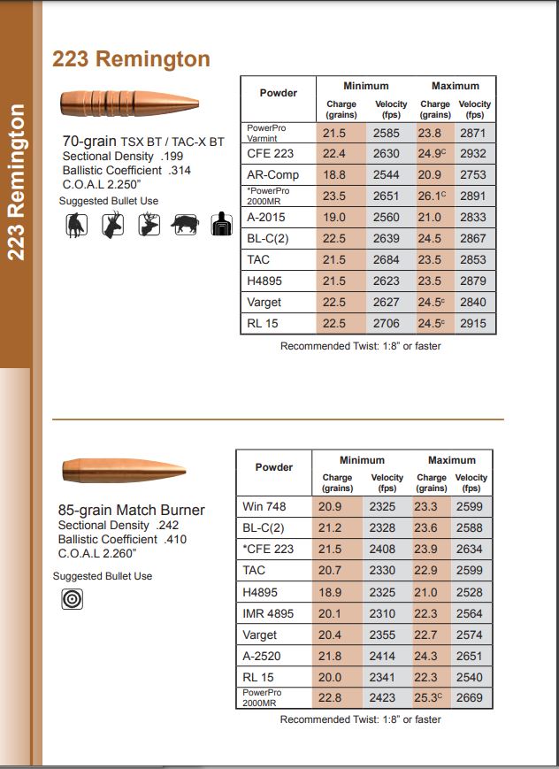

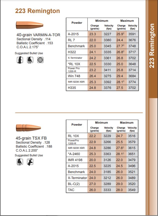

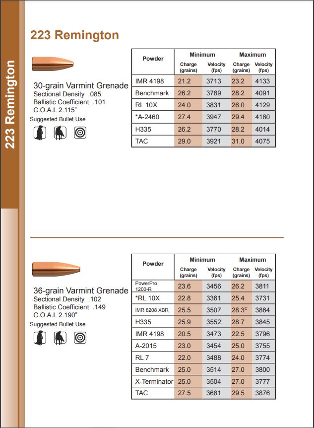

ADI AR2206H is sold by Hodgdon in the US as H4895. They don't list it for the 45gn TSX, but do list if for the 50gn TSX/TTSX and heavier, so you can extrapolate from that. If you study the 50gn data page you'll see that the monolithic copper TSX/TTSX bullet generally uses a larger charge (up to 2gn more) than the copper-jacketed lead Varminator bullet. Keep that in mind if you decide to switch to a 45gn copper-jacketed bullet in the future, you'll want to reduce the charge and work the load up again.
Barnes 223 30-36gn.JPG (90.09 KiB) Viewed 5629 times
Barnes 223 40-45gn.JPG (98.84 KiB) Viewed 5629 times
Barnes 223 50gn.JPG (106.95 KiB) Viewed 5629 times
Barnes 223 52-53gn.JPG (94.54 KiB) Viewed 5629 times
Barnes 223 55gn.JPG (112.57 KiB) Viewed 5629 times
Barnes 223 62-69gn.JPG (108.33 KiB) Viewed 5629 times
Barnes 223 70-85gn.JPG (100.05 KiB) Viewed 5629 times
