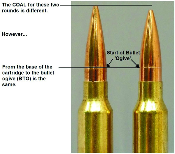

Post by Yelp » 08 Aug 2014, 11:04 am
barrafishing0 wrote:Projectiles are sierra 165gn spitzer boat tails and a box of Barnes tsx 168 boat tail ( because i could on the day)
You'll see with those how much of a difference there can be with different projectiles.
As everyone has said there are a few different tools or techniques for finding the right seating depth, I'll try and give you a bit of general info though to help you understand the concept of your seating depth though...
Standard COAL (cartridge overall length) for the .308 is 2.800". The Game Kings are a pretty good example of an "normal" size and shape bullet and if you seated them so your COAL was 2.800" they'll probably be about right and the bullet would be 'just off' the lands.
That's a bit of an assumption but for the sake of example lets say the above is correct and when loaded like that the GK's are in the sweet spot.
The Barnes bullets are about 1.5mm longer and have a sharper OGIVE (the cone/front of the bullet). Because of this if you load a cartridge with the Barnes to be the same 2.800" length the OGIVE will be further back from the lands so the bullet will have a small amount of 'jump' into the throat when fired. This jump can reduce accuracy of the cartridge.
Because of this the Barnes bullet would need to be seated higher for a longer COAL to bring the OGIVE up to be closer to the lands.
This is a picture of a pair of Berger bullets off their website but you'll get the idea.
berger ogive seating depth
Your Barnes bullet would be the left and your Game Kings would be the right bullet if you get what I mean. As you can see if the left bullet was seated to the same depth as the right bullet the OGIVE would be too far back.
All make sense?

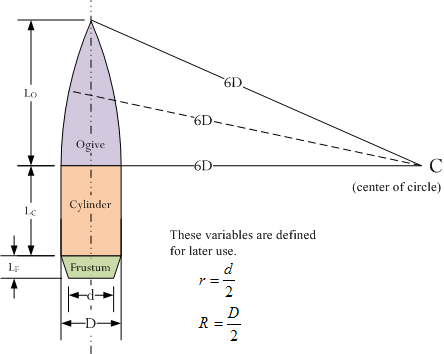

Post by barrafishing0 » 09 Aug 2014, 7:12 pm
Thanks Yelp for the drawing and your explanation, you have hit the nail on what I was asking. This Ogive is not easily defined and you photo shows this.
Is there a way of determining the point as which it is called the ogive of a particular projectile. If I was to enter a projectile point first in to a fresh case to the point that it stops be its ogive? Being the shell is 308, the bore is 308 would the point of contact on the projectile be where it curves away enough to be its shoulder or ogive?
Or do I just pay money for a tool/calipers that read it. The deeper you go with reloading the more I should follow my previous replies on finding coal with a push back projectile into a loose case, bring it off the lands may be .002 in .004in .006 inch for starters, waist $100 of ammo into paper getting used to the gun and never ever change load, projectile or powder. But what if I got a chance to hunt deer or chase long range goats? It doesn't end this shooting stuff does it.

Post by Yelp » 11 Aug 2014, 11:43 am
You're basically right, where the curve of the bullet ends and the straight body behinds that's the end of the ogive. Like this...
Putting a projectile in upside down won't quite work like that though. The neck of your brass will be a fraction smaller so there is tension to hold the bullet in place. Putting the bullet in upside down it will stop slightly before the body of the bullet begins.
There isn't really any point in doing that though other than curiosity.
Just to make sure... It sounds like you're trying to get the bottom of the bullets ogive to line up with the top of the case neck. Is that what you're asking? Because you don't need to do that. It's fine if part of the straight body is above the neck.
It's about getting the top of the bullet to me just off the rifling. If this means some of the bullets body is above the neck that's perfectly common. I guess you've got that by now? Let me know if I misunderstood and if we're on the same page.
