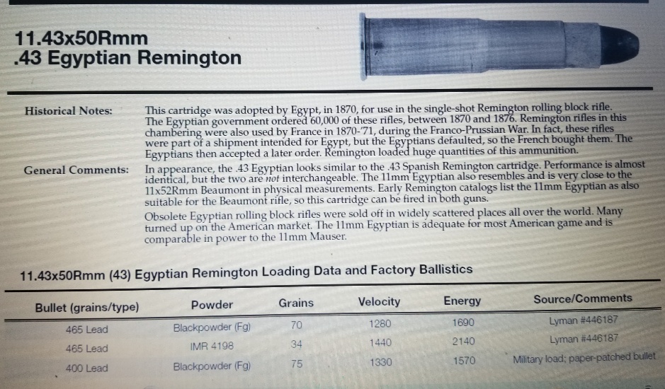

This is from Barnes' Cartridges of the World 13th Edition in case you don't have it.
Depending on actual bore diameter you could also make up some chamber adapters and shoot a cartridge easier to get/make, at least until you get dies.

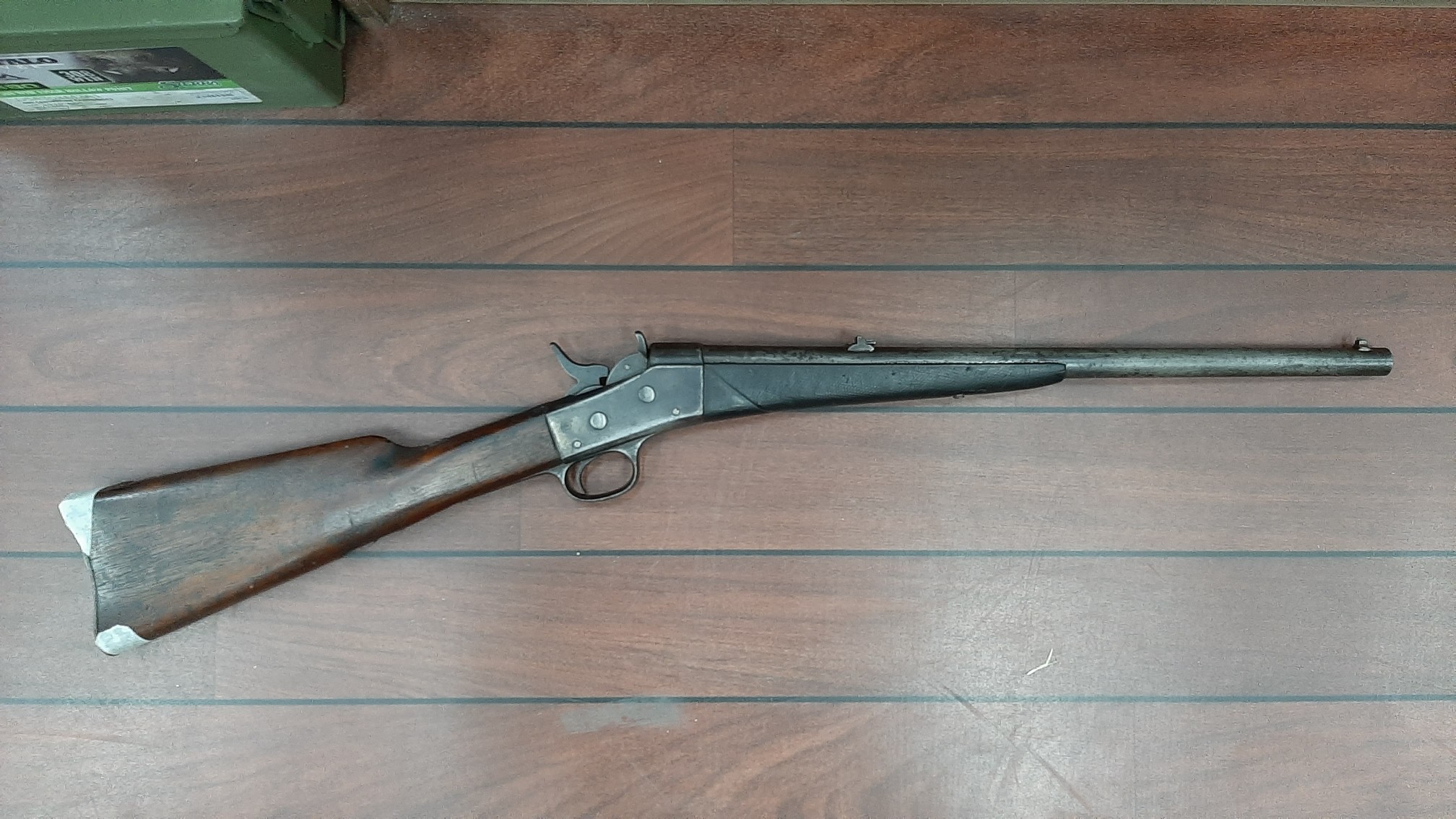

Yeah so the chamber is almost perfect .43 Egyptian measurements, but then the bore is only .439
I got talking to some guys on a rolling block forum. They said this is fairly common as 43 spanish barrels were used to get Egyptian rifles out the door fast.
Mine has been cut down to a carbine. All it's military markings have been/ tried to be removed

Is No1Mk3 shooting .43 Egyptian?
