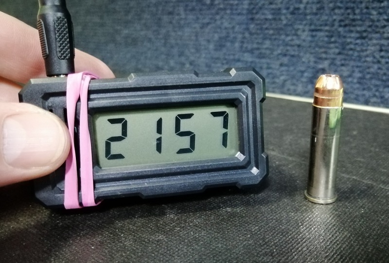

Post by Bill » 01 Mar 2022, 7:57 pm
Send em my way Jimtom :thumbsup:
I'm onto my 7th reloading for 30 x Federal Nickel cases I'm using in my Ruger Carbine, 158gr at 1960fps and 140gr at 2150fps. Primer pockets are still sweet and Im only using a lite crimp. I rate em highly, :drinks:
