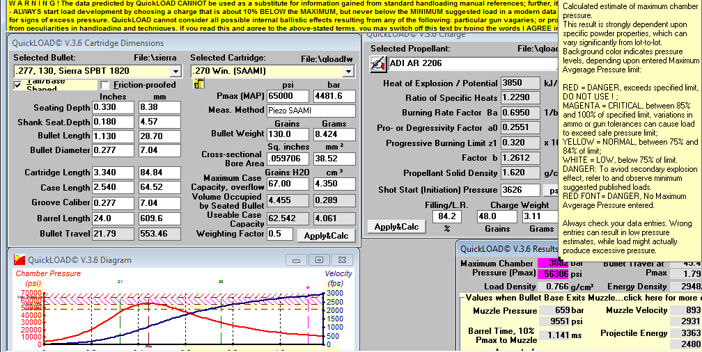

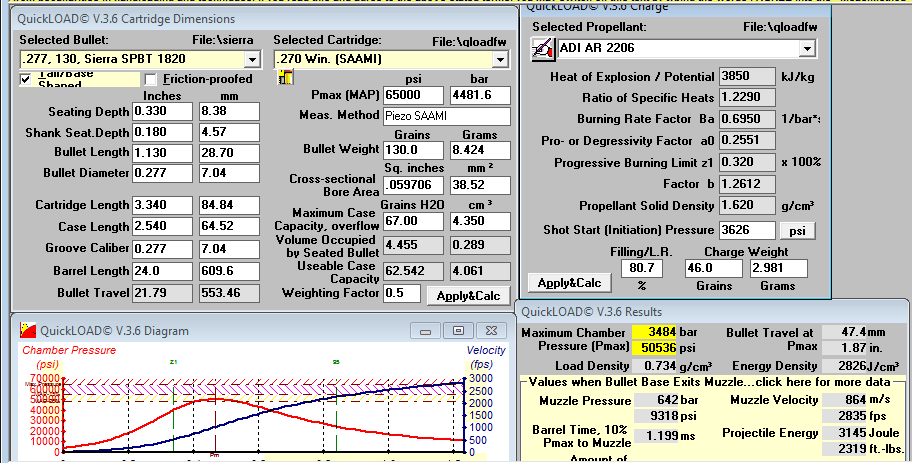

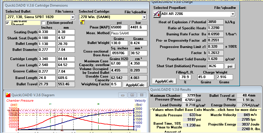

I ran some numbers in Gordons reloading for you to give you some idea's. No1 49 is close to the mark.
These are getting close to max. So start about 7 or 10% lower to be safe.
22" barrel 130gr Hornady SP 2730 AR2219 45gr 2753fps
AR2206H sits in the middle ...more or less.
22" barrel 130gr Hornady SP 27300 AR2206H 48gr 2850fps
NOTE; Is only a software program so no guarantees
NOTE; AMENDED DUE TO DATA ERROR
270 130gr 48gr 2206H.JPG (176.08 KiB) Viewed 7553 times
270 130gr 45gr 2219.JPG (178.67 KiB) Viewed 7553 times

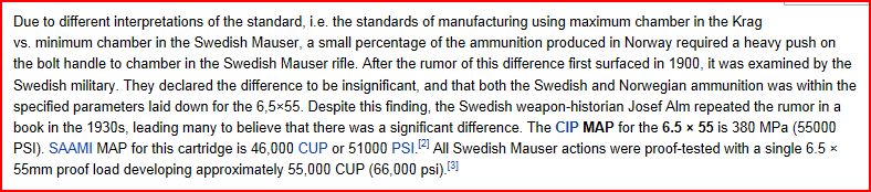

Just to add to the discussion regarding the strength, or otherwise, of small-ring Mauser receivers, here's a bit of info' on the Swedish version and its proof load test. I wish I had noted the forum from which this scan came, but I note that it was saved to my PC back in 2012.
Note that there is quite some difference between the CIP and SAAMI MAP's.
6-5 x 55 SKAN proof load.JPG (68.15 KiB) Viewed 7575 times
