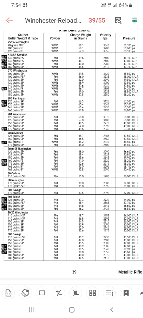

Post by Oldbloke » 22 Jun 2022, 7:56 pm
Here, in an old Winchester manual.

Post by bladeracer » 22 Jun 2022, 8:22 pm
Oldbloke wrote:Here, in an old Winchester manual.
Thanks OB, that's the 15th Edition Winchester manual, one of the few sources I found for it.
They seem to prefer the W760 for the heavy bullets, but W748 is what he has access to at the moment. Hopefully he can get enough to last a few years and maybe powder supply will have righted itself by the time he needs to find more of it.

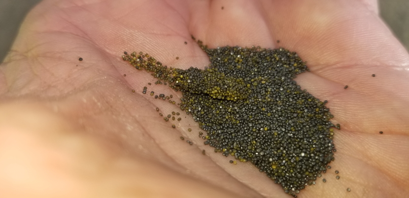

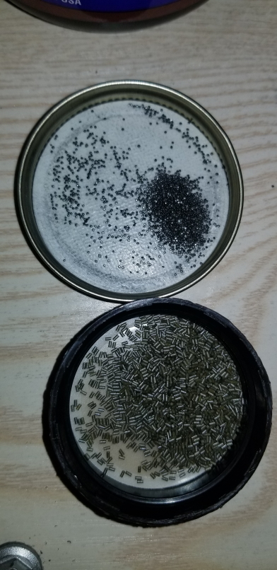

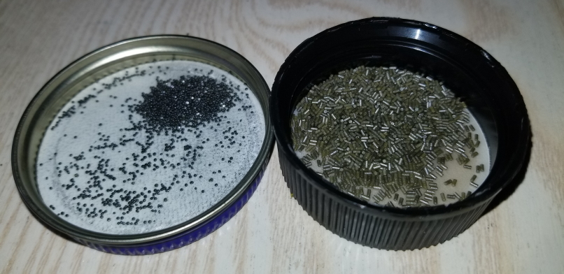

Can somebody that uses this stuff confirm that this is what W748 is supposed to look like?
Compared to the AR2206H I'm used to the ball powder looks like extremely fast pistol powder, as if from a .22LR cartridge - is this the right stuff?
I Googled pics and it does seem to look right but it'd be nice to confirm it with somebody who actually uses it.

Post by northdude » 30 Jun 2022, 4:49 am
Yep that is what it looks like. I use it in my 6.5 grendel
