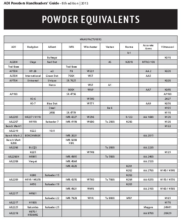

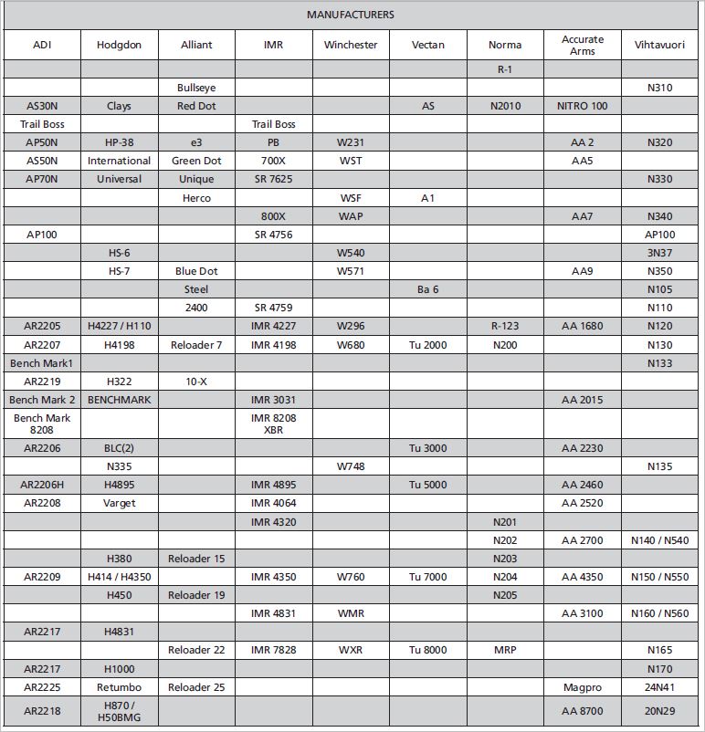

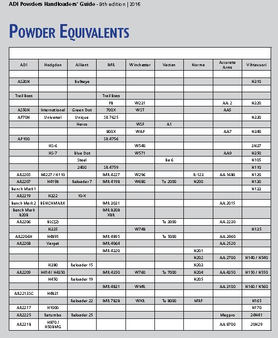

I posted it in good faith. Not sure I would call it "dodgy". Seems to me ADI have changed the burn rate slightly over the years. I have re-copied the same one (2013) to also include the year/edition at the top of the page, Also including the later 2016 ed.
I find this very interesting. I always understood they never change burn rates once they develop a product.
ADI Equivalents 2013 6th Ed.JPG (103.28 KiB) Viewed 7661 times
ADI Equivalents 2016 9th Ed.JPG (98.33 KiB) Viewed 7660 times
P.S. These pdfs are freely available on the net if you google "ADI Handloaders guide" along with 3,4,5 editions. That's how I got them.
Edit: One of the images was incorrectly named.

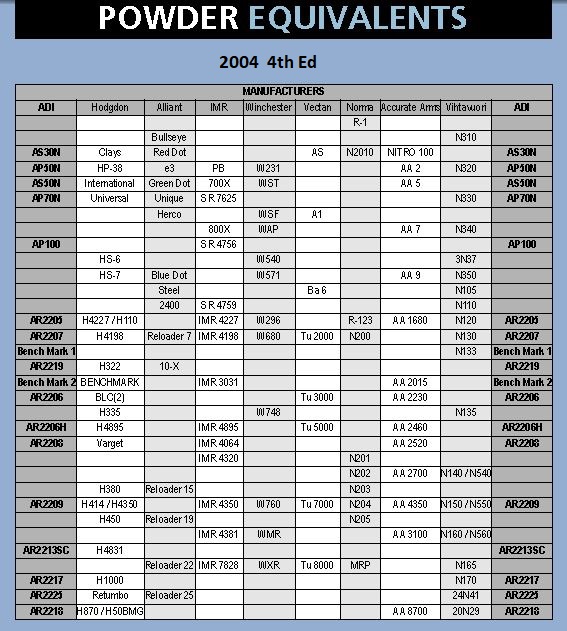

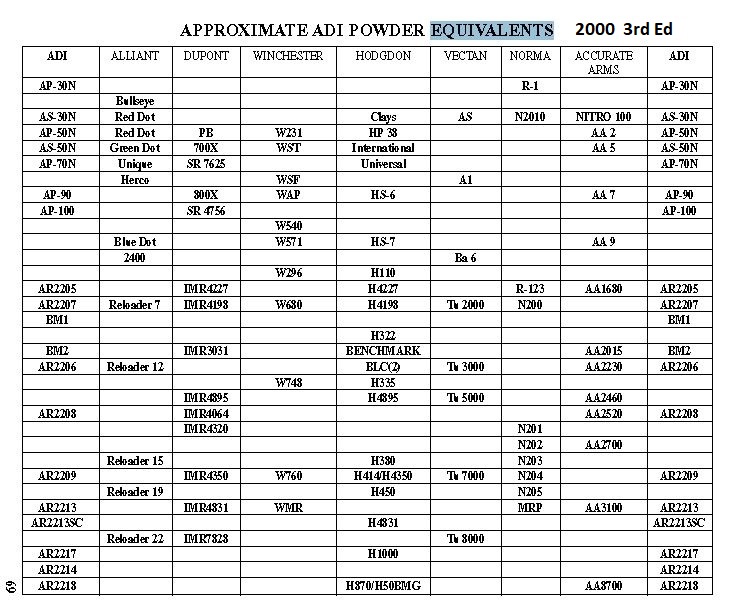

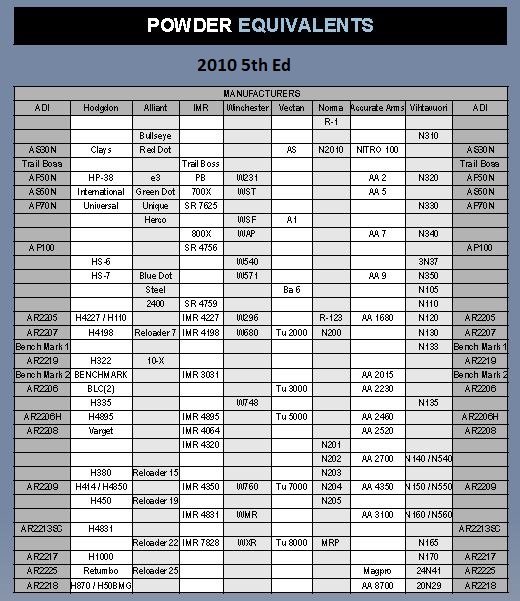

ADI Equivalents 2010 5th Ed.JPG (142.86 KiB) Viewed 7660 times
ADI Equivalents 2004 4th Ed .JPG (158.88 KiB) Viewed 7660 times
ADI Equivalents 2000 3rd Ed.JPG (174.97 KiB) Viewed 7660 times
