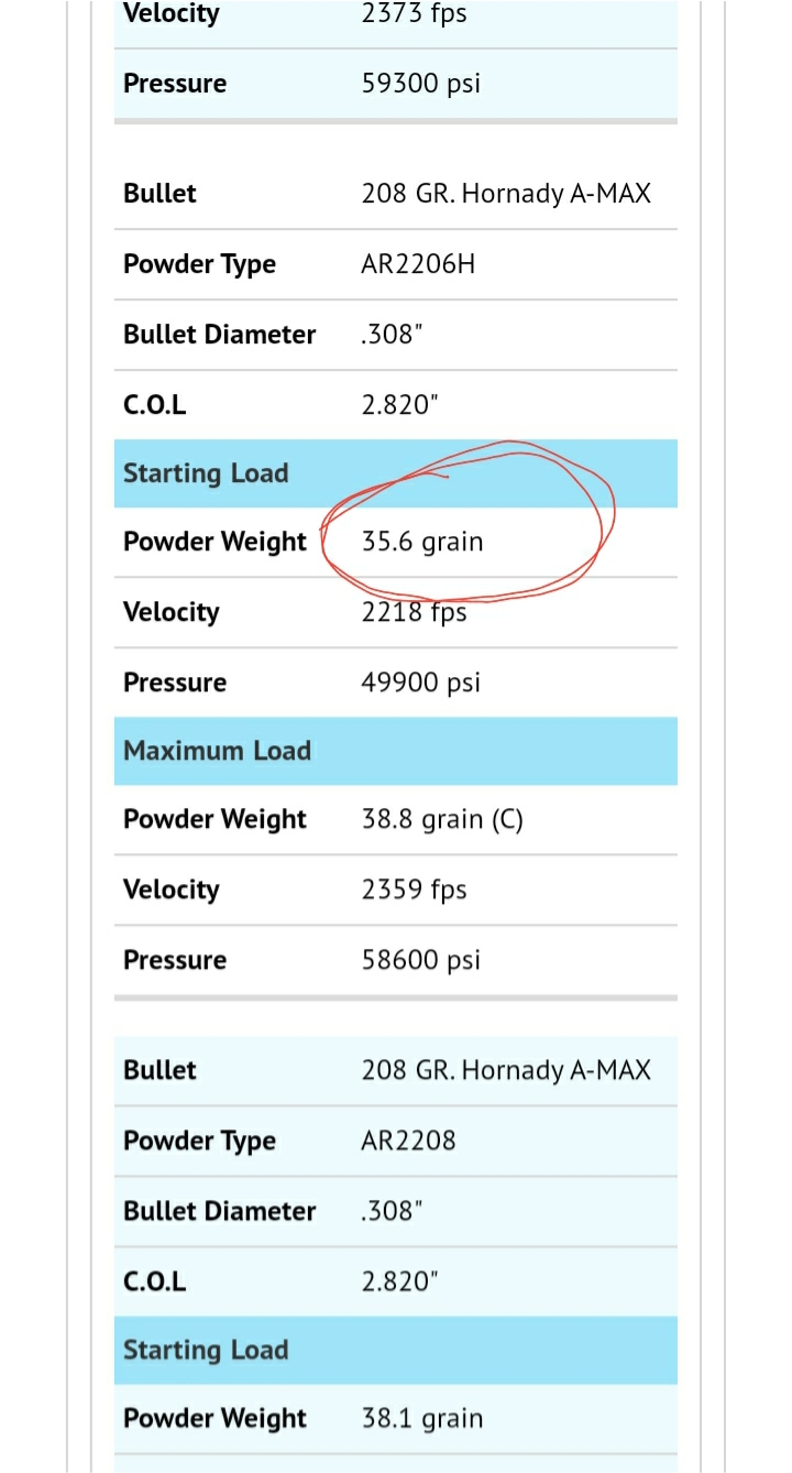

Apparently not. I'd probably start 2 grains lower than the starting load for the 208gn a max

straightshooter wrote:If you are loading for a standard COL I would suggest 38gn of 2206H or 40gn 2208 as starting loads. Hotter loads should be possible but will depend on how much freebore you have.
I believe thats more than the starting loads for the 208gn projectiles......

Post by bigpete » 10 Jul 2022, 8:12 am
Screenshot_20220710-074114_Samsung Internet.jpg (207.23 KiB) Viewed 10558 times
Yep,its nearly 2.5gn more than the start load for a projectile 12gn lighter !

Billywillinga wrote:Thanks Straight shooter,
apparently there is a 2208 load which a mate of mine thinks he has somewhere. I may have to bite the bullet and buy some 2208, although I'm still convinced 2206H would work well
It will,but not if you load a near maximum charge for a 12gn lighter projectile under your 220gn pills lol
Posts: 4190

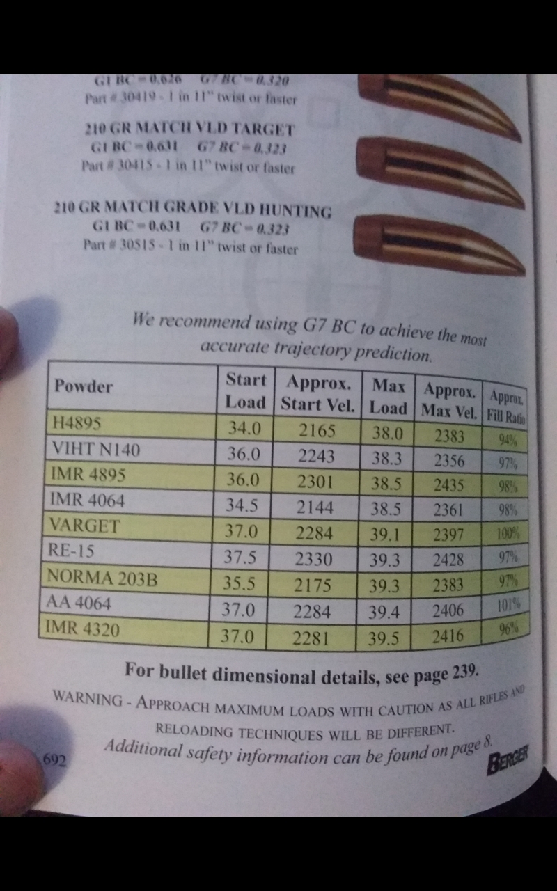

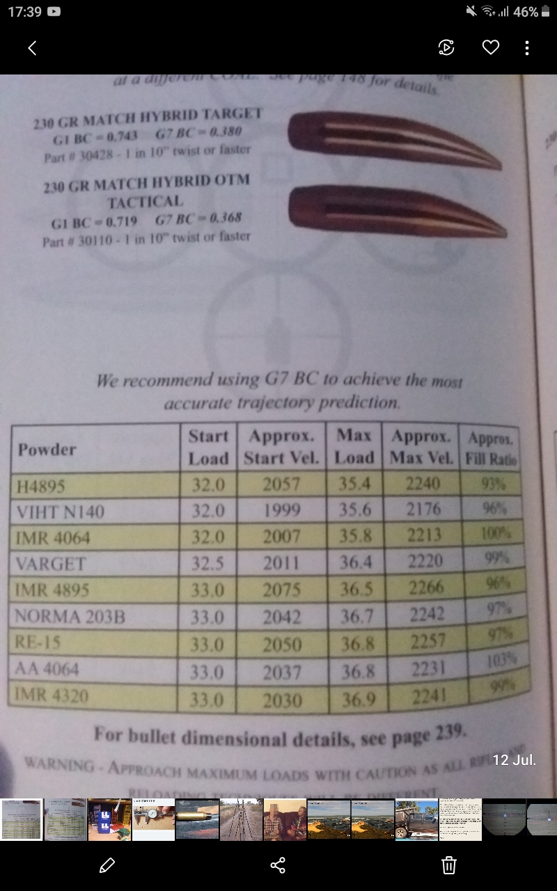

Post by deye243 » 12 Jul 2022, 5:46 pm
As this data out of my Burger loading manual shows for 210 and 230 grain and you will be in the middle of that the 06h (H4895) will work fine albeit a slight drop in feet per second I don't think an animal would tell the difference .
Posts: 2822
