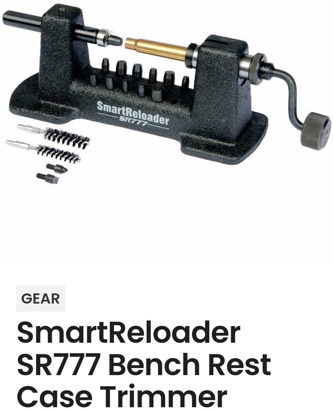

Post by Oldbloke » 05 Sep 2022, 5:51 pm
These are cheap and cheerful.
Come with just about everything.
There is very little science in trimmers. So, don't listen to the "cry once " boys.
Not sure if they are still available though.
https://sportingshooter.com.au/gear/sma ... e-trimmer/

deye243 wrote:Ok I have been around the block a few times I have had the RCBS hornady the usual brands buy Once cry once just buy the forster .
https://www.brtshooterssupply.com.au/pr ... e-trimmer/
I have been using this for several years and it has not been hurting my long-range shooting .
it is up to you I am not one for buying cheap crap and then upgrading later after that , just buy quality first don't look back.
It is like this really flash term they have today entry-level I do not buy that one , neither did my kids they just kept saving and bought quality from day 1 man are they happy they did not muck around with rubbish .
Up to you , how much money do you have buy quality first up money well spent I don't see the value in buying cheap stuff and then upgrading later .
I was stung back in the 80s never again .
I judge quality by how well it does the job, not how much the company thinks they can charge for it.
