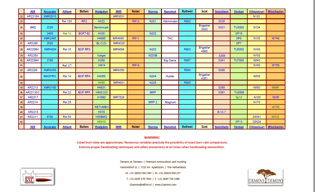

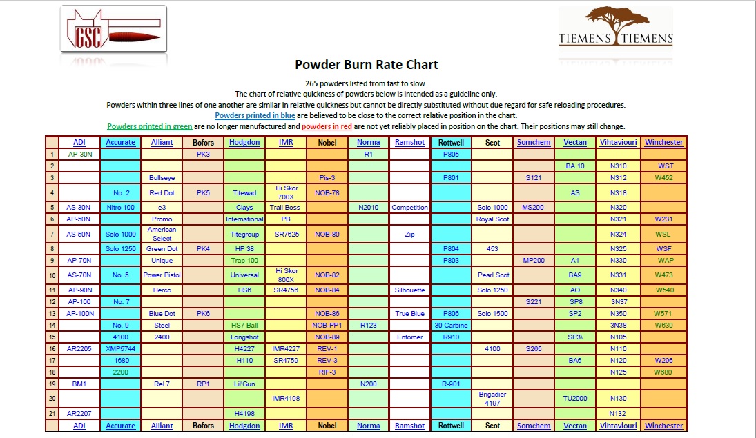

Post by straightshooter » 02 Aug 2022, 8:34 am
These burn rate charts might help.
I couldn't make the pdf upload work so I turned it into two jpg files.

Post by Diamond Jim » 02 Aug 2022, 8:06 pm
Thanks SS, that's exactly the sort of information I need for this experiment.
