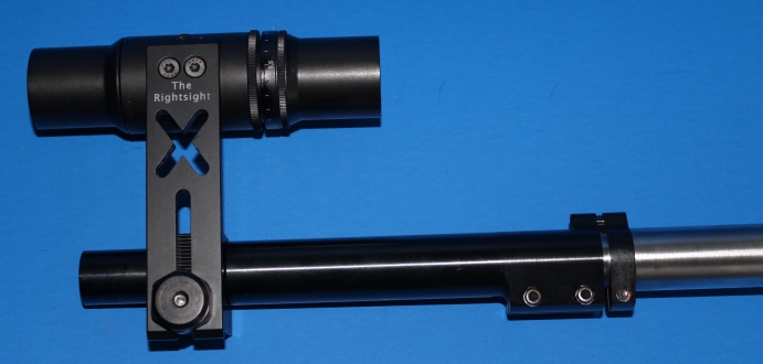

In2anity dont think I have never seen a removable bloop tube. All the ones I have seen a considerable number (s**t loads) the bloop tube or extended part of the barrel has always been an integral part of the barrel. For those trying to imagine what this looks like it looks like just a ordinary barrel with the inside or the bore drilled out to leave only a thin portion of the barrel remaining like a silencer. For all intensive purposes from the side you would never know it is different from the bore of a normal rifle from the outside. The barrel is bored out to leave just the outside thinish tube. Allowing a sight to be fitted to the end of the barrel.

Larry wrote:In2anity dont think I have never seen a removable bloop tube. All the ones I have seen a considerable number (s**t loads) the bloop tube or extended part of the barrel has always been an integral part of the barrel. For those trying to imagine what this looks like it looks like just a ordinary barrel with the inside or the bore drilled out to leave only a thin portion of the barrel remaining like a silencer. For all intensive purposes from the side you would never know it is different from the bore of a normal rifle from the outside. The barrel is bored out to leave just the outside thinish tube. Allowing a sight to be fitted to the end of the barrel.
Gotya. That makes sense and probably are fairly robust.TBH i've never paid really close attention to them, other than the time i saw one fail during a Queens. His one was like this:
Bloop Tube.JPG (87.08 KiB) Viewed 2968 times
Seems... fragile, under 30 cal recoil. 223 different story. :unknown:

Point taken however, they'd probably be fine. Check your screws regularly etc.
