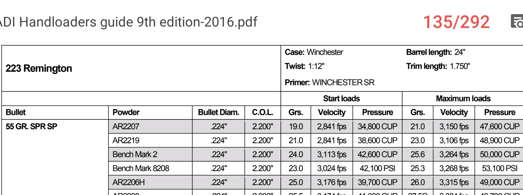

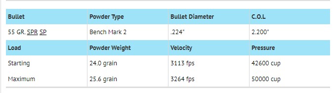

for some reason does not show any load data for Hornady V-max 55grain so I have to choose other bullet type as:
Bullet Powder Starting Maximum
55 GR. Barnes TSX FB Bench Mark 2 20.0 grain 2885 fps 47600 psi 22.2 grain 3066 fps 52200 psi
55 GR. Sinterfire Bench Mark 2 21.0 grain 2903 fps 42600 psi 23.4 grain 3128 fps 51000 psi
55 GR. Speer SP Bench Mark 2 24.0 grain 3113 fps 42600 cup 25.6 grain 3264 fps 50000 cup
I look at those projectiles above and they look completely different from the V-max..not too sure which to pick up...
if I start with 20grain i am afraid I could be undercharging my ammos and create a big pressure issue ... talking of which...

Stick with the recommended loads from ADI for 55gr bullets and that powder. Start at the minimum and work up.
Loads will also be different due to rifle chambers, different brass and so on. Hence start low and work up.
As bladeracer said, use it as a guide. But ignore at your peril, especially if you lack experience.

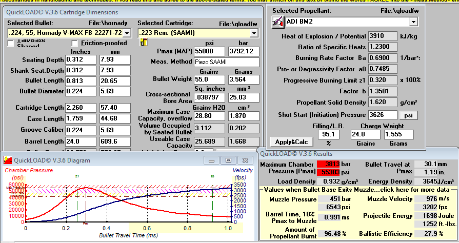

i have a 1-12 tikka t3 and i load 55 vmax with 23.8 gn of BM2 with adi brass for outstanding accuracy . according to some data this is a starting load . shoots very accuratly out of my rifle and is easy on the throat . win-win :thumbsup:

Use the Hornady V-max 55 & BM2
ADI lists
Min 24gr
Max 25.6gr
Just load 24gr and work up in 0.3gr steps. (It's a small case)
Look for signs of pressure.
First good accurate load stop. No need to
chase velocity as mentioned.
Your learning, personally I'd stop at 25.6gr
Suggest 4 or 5 shot groups. And you will find one plenty good enough for hunting.
P.S. suggest a 0.5mm bullet jump
NOTE: Post edited. Data/load was incorrect.

The load data you appear to be quoting is for the 55gn Sinterfire, which is a monolithic copper bullet - the VMax is a conventional jacketed-lead bullet. For the VMax use the 55gn Speer SP data - 24gn up to 25.6gn.
ADI .223 VMax 55gn BM2.jpg (26.86 KiB) Viewed 14276 times

bladeracer wrote:The load data you appear to be quoting is for the 55gn Sinterfire, which is a monolithic copper bullet - the VMax is a conventional jacketed-lead bullet. For the VMax use the 55gn Speer SP data - 24gn up to 25.6gn.
I'd run that through a target action, like a Barnard. But I certainly wouldn't do it in some older, or cheap thing. Nevertheless I presume the Tikka action is pretty strong by today's standards, but they are still a lot lighter than a dedicated target action. Yeah sure the actions are probably proofed well over 60kpsi, but your window for error gets smaller up that top end - like condensation or oil in the chamber can to bump your pressures up even more. Unless he's shooting OPM comp (55gr? nope), I don't see the point in pushing this envelope...

Post by Oldbloke » 26 Jul 2022, 8:06 am
My error. I have edited the post.
