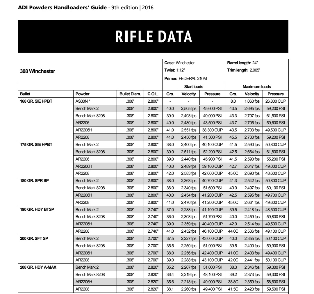

Always been a fan of heavy for calibre projectiles and I m currently using 185gr bullets out of my 308 and I started thinking about 200gr bullets as an all rounder for my stalking rifle.
Will be used on everything , anyone got a fav bullet or load ?

Old bloke every goat, pig and deer I've shot in the last 10 years has been 150m or less, 1 exception was a 200m shot earlier this year.
Howa make the current Super lite with a 1:10 twist, is 25-2600fps really a rainbow ??

Nope, nothing wrong with the trajectory on those. Zero around 150m, should be about 50mm high at 80m and about 150mm low at 200m, depending on the bullet you use. A round nose would be more curved, an ELDX would be flatter.

Yeap 20" and 1:10 twist, thinking of putting on a Waters Gas monkey Muzzle brake to tame the recoil.
Yeah Bladeracer 150m zero is where its at, just noticed plenty of cheap 180/200gr 308 pills sitting unloved on gunshop shelves and the goal is to nail a few big boars and a red or 2 over the next 12 months. Might even throw it in the bag for an NT hunt in September :drinks:

Your closer than I was. I was expecting about 8" or 9" @ 200yards. Its just under 6". Assuming 2300FPS @ Muzzle.

Billo wrote:Old bloke every goat, pig and deer I've shot in the last 10 years has been 150m or less, 1 exception was a 200m shot earlier this year.
Berger Bullets - Extreme Long-Range Bullets _ Target _ Tactical _ Hunting.pdf
Hey old bloke I few got a few tins of pixie dust sitting under the reloading bench, should go close to 2500 fps :lol:
I noticed the.200gr Speer Hot cors have a 0.556 BC, might be too long thou...
