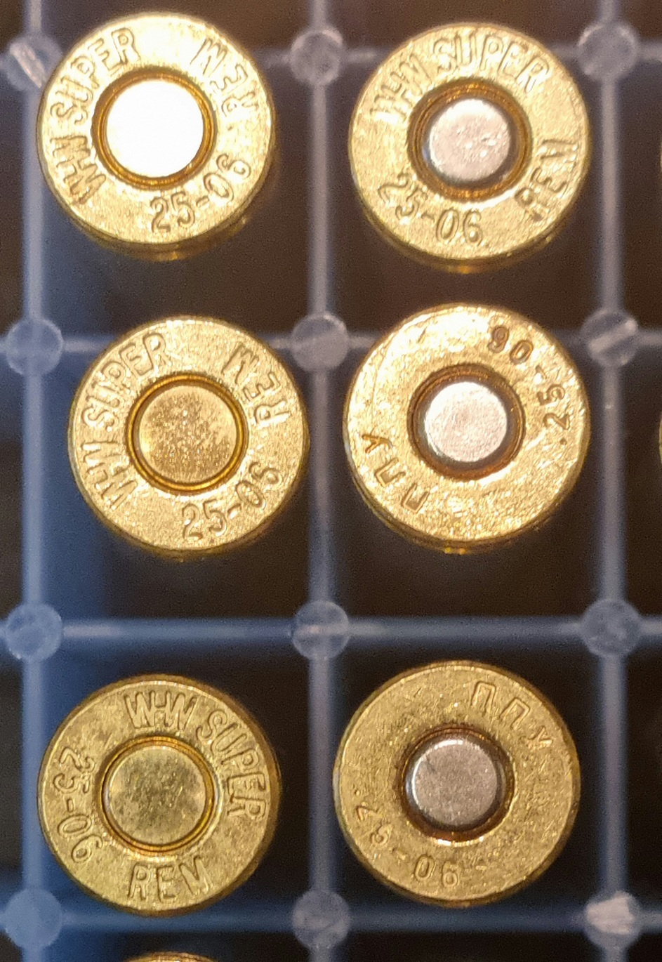

Is it just me or is the 25-06 one of thos rounds with both small and large primers. I was preparing some hand-me-down cases and sort of fell off my perch when I noticed that the primers were a different size. I did measure them.
And can anyone identify the odd Headstamp on the RH side ones?

Post by Jorlcrin » 13 Aug 2023, 10:04 am
The 'nny' is one of the stamps I find in the Highland brass I brought some years back.
I also find some of it stamped 'PPU'.
Turns out the 'nny' is the Cryllic stamp for 'PPU'; they are both made by Privi-Partisan.
From Wikipedia: "ППУ (PPU) Prvi Partizanski zavod ad Užice ("First Partisan" Ammunition Plant) (1945–present) – Užice, Yugoslavia (now Serbia)."

Well that solves that mystery. What about the primer size, either an optical illusion or they are actually different sizes. I'm guessing I will find out when I try and put a large primer into what i think is a small whole.

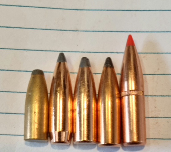

After having a look and a "feel" of the projectile...
The lead tip/point reminds me of a big bore.. Not pointy but rather blunt, not 'neat'
The ogive......not long or elongated
The actual metal jacket not polished as the commercial projectiles are... not as pretty and without correct equip, I'm not able to say if the case is softer or harder.
I reckon they will probably wreck havoc on foxes, goats, PR's etc.
We shall see.
The picture is of my collection
87gr Bertram, 100gr Speers and Sierra's and a 117gr Hornady SST
