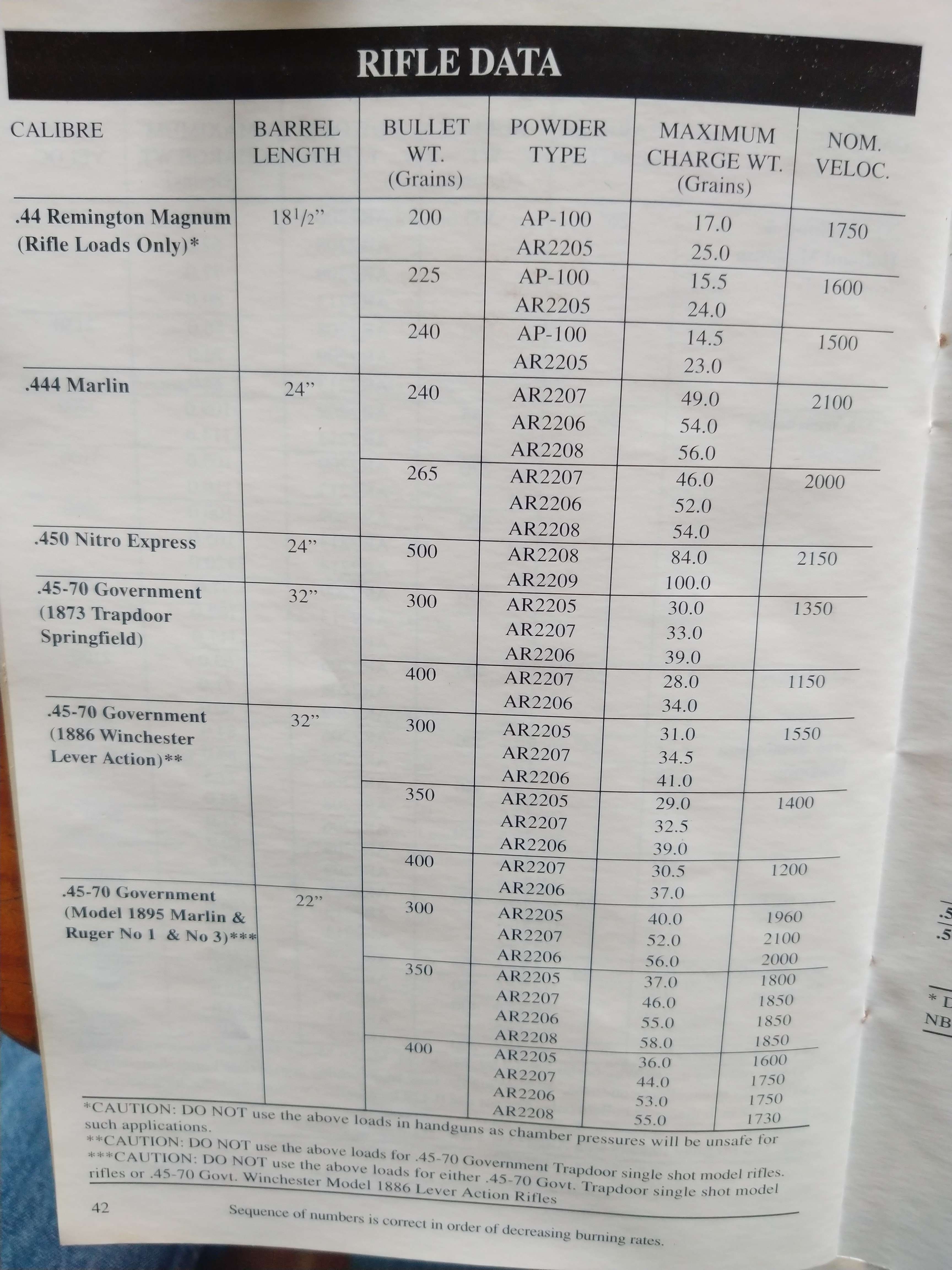

Post by Wallaby stew » 21 Aug 2023, 12:37 pm
I've just answered my own question.
I've got an old (1996) ADI reloading manual and it has the loads I'm looking for.
These loads aren't listed in the 2013 manual strangely, perhaps it's because we live in dangerous times?
Thanks for your input.

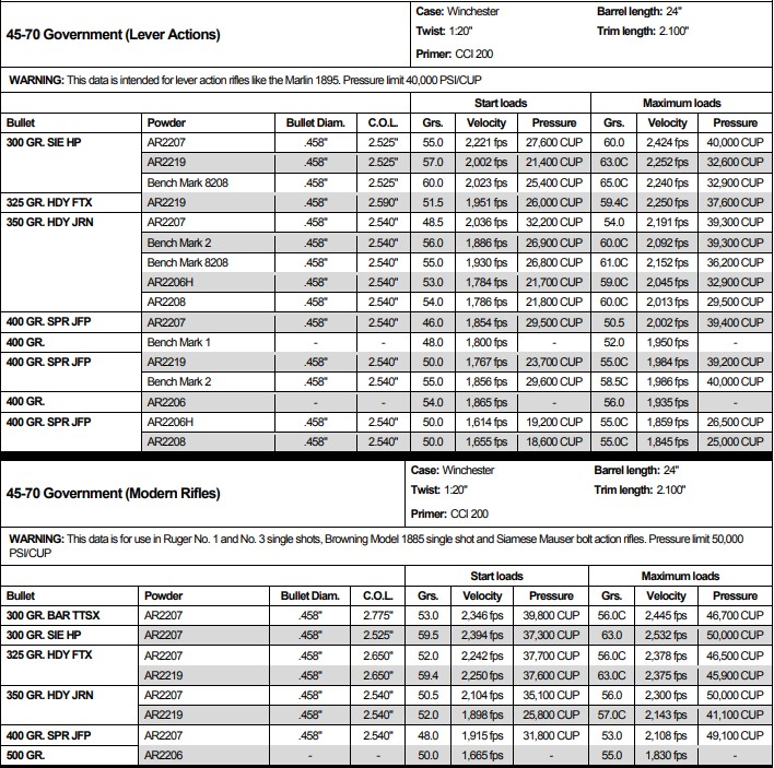

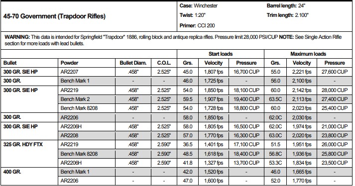

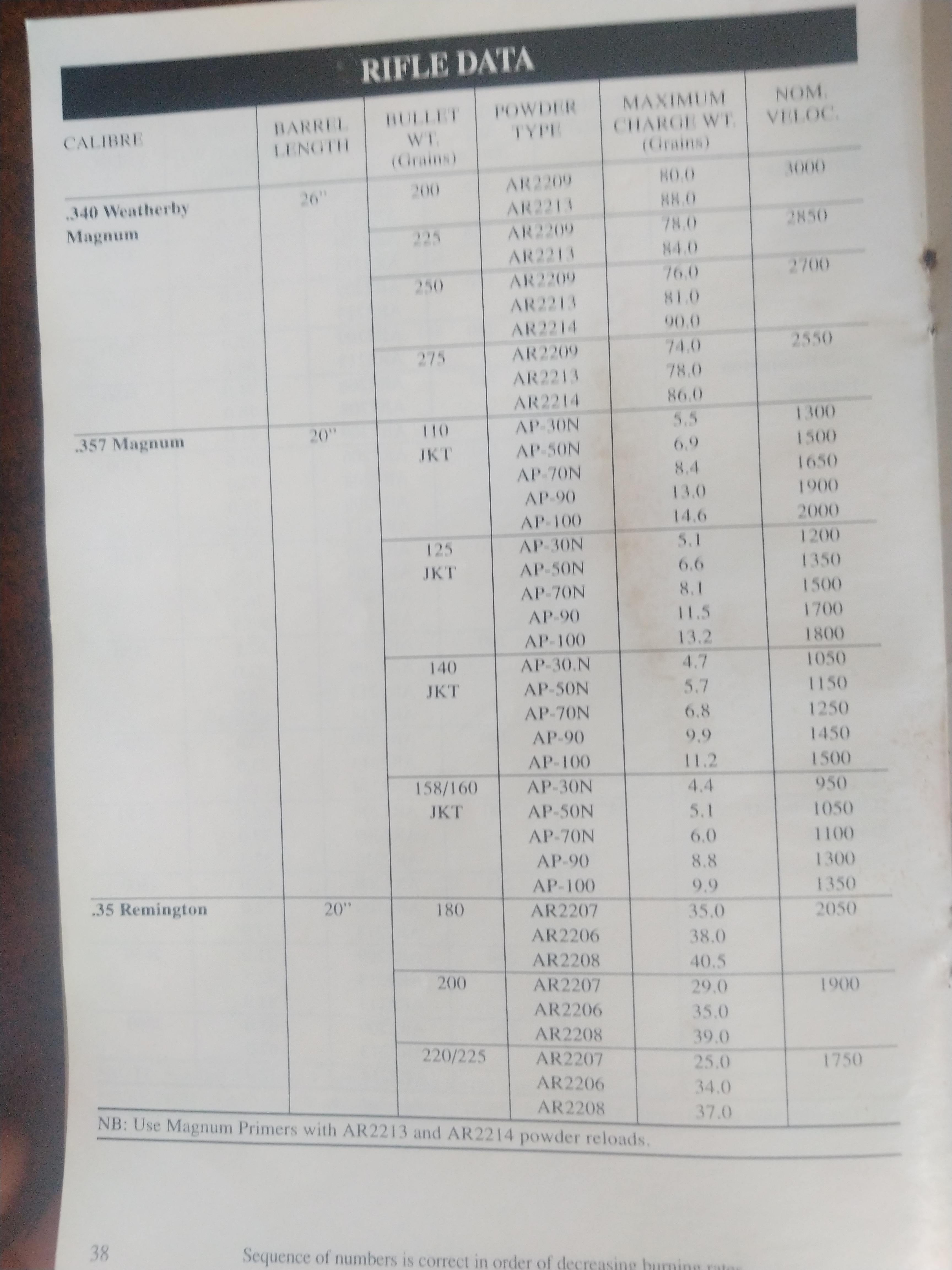

Post by Obie73 » 21 Aug 2023, 2:43 pm
Thanks for that section from the 1996 ADI manual, Wallaby stew! I'm definitely going to get the latest ADI manual. I'm guessing that for .357 magnum it won't have data for 2207 as that powder would be considered as being too slow for that round no doubt. Even though people are using it. Any chance you could confirm that from the '96 manual? Another pic of the relevant page would be really interesting.
Obie73
Posts: 139
Re: 45/70 in AR2205
Post by bladeracer » 21 Aug 2023, 2:55 pm
Obie73 wrote:Thanks for that section from the 1996 ADI manual, Wallaby stew! I'm definitely going to get the latest ADI manual. I'm guessing that for .357 magnum it won't have data for 2207 as that powder would be considered as being too slow for that round no doubt. Even though people are using it. Any chance you could confirm that from the '96 manual? Another pic of the relevant page would be really interesting.
This is the 6th Edition.
https://www.ballisticstudies.com/site/ballisticstudies/files/ADI%20Handloaders%20guide%202013.pdf
Screenshot 2023-08-21 145438.jpg (112.33 KiB) Viewed 6054 times
Screenshot 2023-08-21 145454.jpg (207.54 KiB) Viewed 6054 times
Re: 45/70 in AR2205
Post by Wallaby stew » 21 Aug 2023, 3:23 pm
This is a page from the 1996 ADI manual for .357

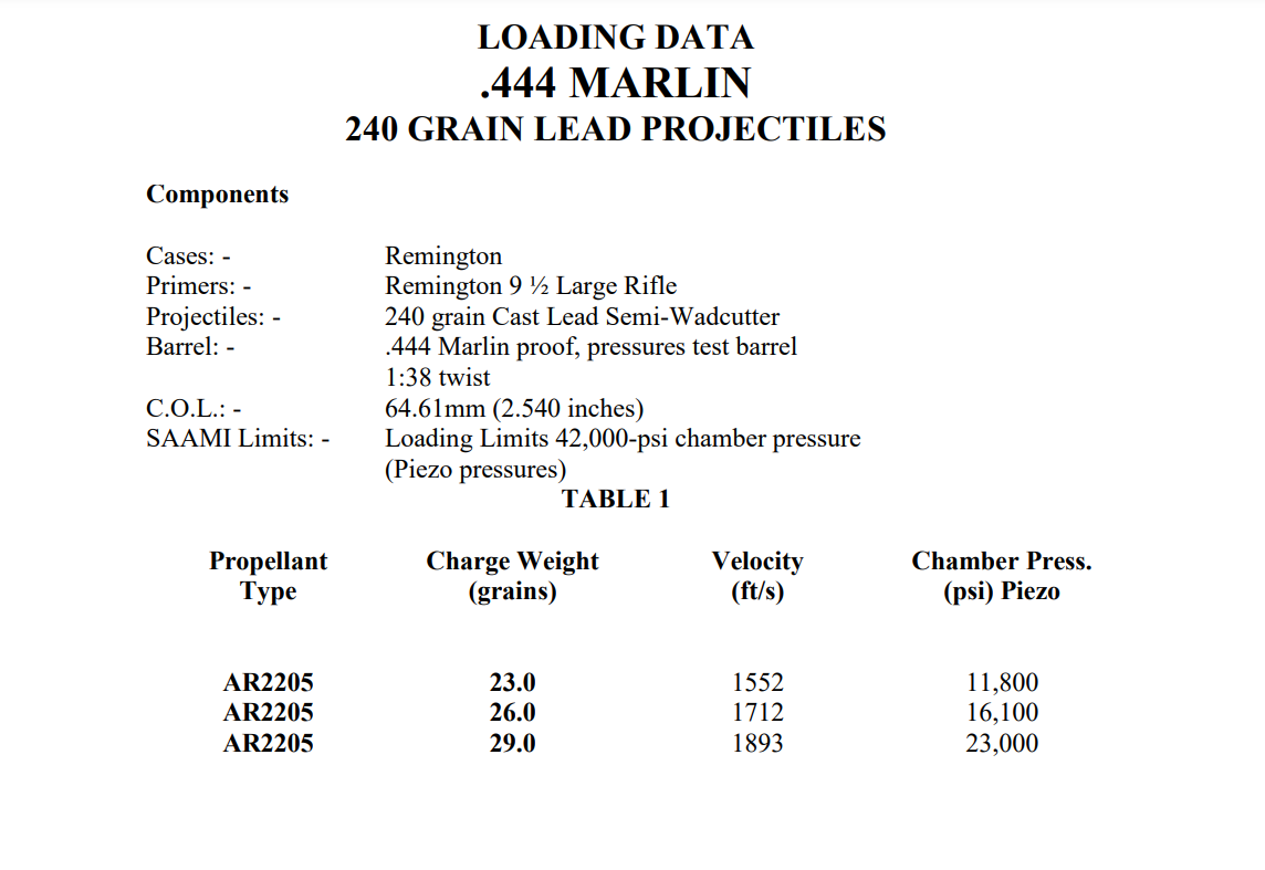

Post by jpsauer88 » 08 Sep 2023, 10:57 am
There is adi data for CAST in 444 MARLIN it was emailed to me by them.
LOADING DATA
.444 MARLIN
240 GRAIN LEAD PROJECTILES
Components
Cases: - Remington
Primers: - Remington 9 ½ Large Rifle
Projectiles: - 240 grain Cast Lead Semi-Wadcutter
Barrel: - .444 Marlin proof, pressures test barrel
1:38 twist
C.O.L.: - 64.61mm (2.540 inches)
SAAMI Limits: - Loading Limits 42,000-psi chamber pressure
(Piezo pressures)
TABLE 1
Propellant
Type
Charge Weight
(grains)
Velocity
(ft/s)
Chamber Press.
(psi) Piezo
AR2205 23.0 1552 11,800
AR2205 26.0 1712 16,100
AR2205 29.0 1893 23,000
marlin 444 cast data 2205.png (125.13 KiB) Viewed 5852 times
