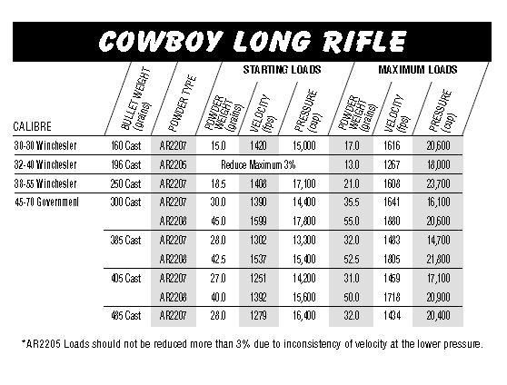

I found this in the 3rd Ed of the ADI manual.
Says 40gr of AR2208 is OK??
Logically 2206H should be ok too.
Old 4570Capture.JPG (62.48 KiB) Viewed 6834 times

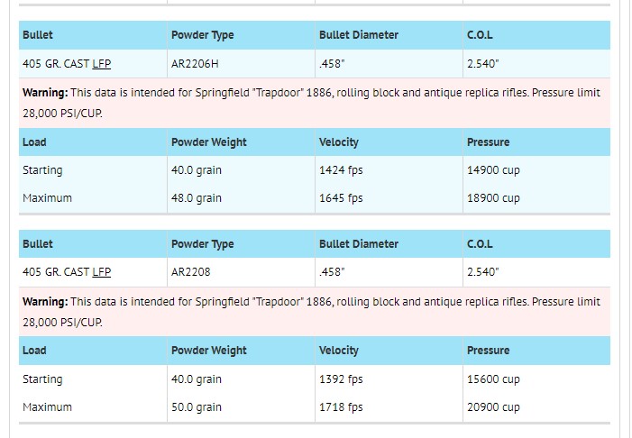

The loads are in the current online manual as well.
Screenshot 2023-08-28 183133.jpg (76.74 KiB) Viewed 6825 times

I dont think it is an amount of powder issue. I would be looking at damp or wet powder. Were your cases completely dry? I have seen a bloke do exactly the same thing his problem was that his cases were not completely dry a drip of water was still left in the primer flash hole.
Posts: 939
Re: Didn't go bang
Post by Wallaby stew » 29 Aug 2023, 8:26 pm
Larry wrote:I dont think it is an amount of powder issue. I would be looking at damp or wet powder. Were your cases completely dry? I have seen a bloke do exactly the same thing his problem was that his cases were not completely dry a drip of water was still left in the primer flash hole.
I never got any water near these, they've been fired a couple of times over the last two weeks and kept in a Tupperware container with the lid on.
