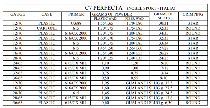

A mate bought some A0 last year which only has load data for .38 Special and .40S&W from memory. Fast pistol powders can be used in rifle cartridges as well, for reduced loads.
Very difficult to find out much at all about C7, perhaps it was made for non-English speaking countries? First thing I would do is email Nobel and ask their advice - it may get you nowhere but I would still tick that box. One reference from 2011 seems to indicate "C7 SV" is used for steel shot? Another from 2013 lists "C7 Perfecta" for 12ga. loads. Using up to 28gn charges under 34gm loads. Comparing it to ADI's 12ga. data I would _guess_ the powder is in the realm of AP70N. I would load a single round with a low AP70N charge weight and test fire it, ideally over a chronograph. Probably about 3.5gn under a 115gn cast bullet in 9mm or a 158gn cast bullet in the .357Mag. I would expect both of those to go well under 1000fps but having an actual velocity measurement should give you some hard data you can work from. Personally, I would prefer to do this experimentation using a Chiappa rifled chamber adaptor in a 12ga. gun to minimise the risk of damaging a handgun. A chamber adapter also allows you to do the testing without having to go to a pistol club approved range every time. If I had access to C7 powder I would happily do the testing for you.
Screenshot 2023-10-06 133028.png (113.58 KiB) Viewed 3099 times

Post by Harrisor44 » 06 Oct 2023, 11:29 pm
This may help. Came from Nobel Italy and has loads for 357 in Italian but fairly easy to work out. Their web site is so slow!!
scheda-tecnica-C7.pdf
(135.74 KiB) Downloaded 1552 times

Post by Harrisor44 » 06 Oct 2023, 11:34 pm
And in English if I had looked at it carefully before posting as well as various 9mm cartridges too.
