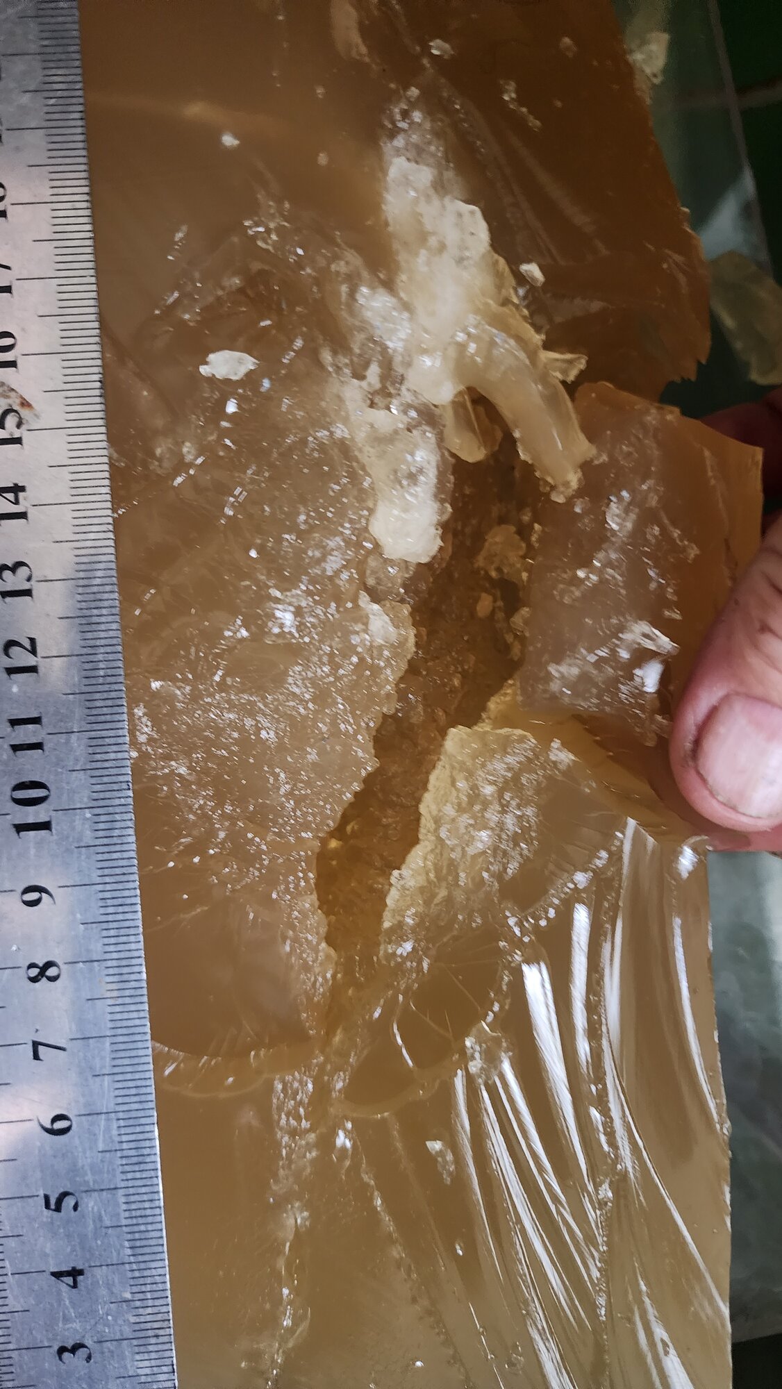

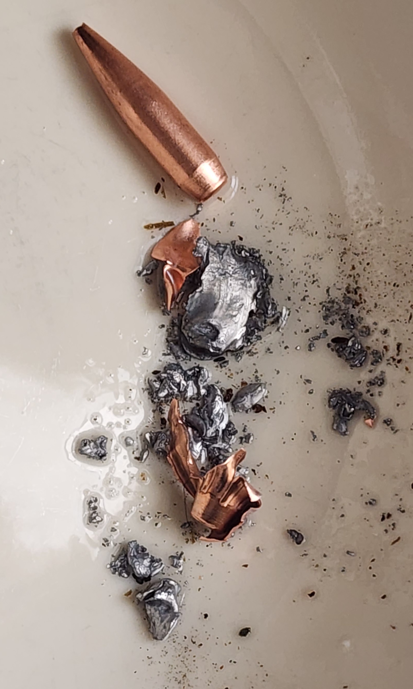

As one of their test shooters, I'm a little biased, but Rexem Projectiles have managed to fit a 77gn 224 pill into the same jacket as their 69gn.
They're an excellent dual purpose target/hunting round, they arrive like a runaway moon and do immense damage.
Below is a wound track from one of the tests I did late last year

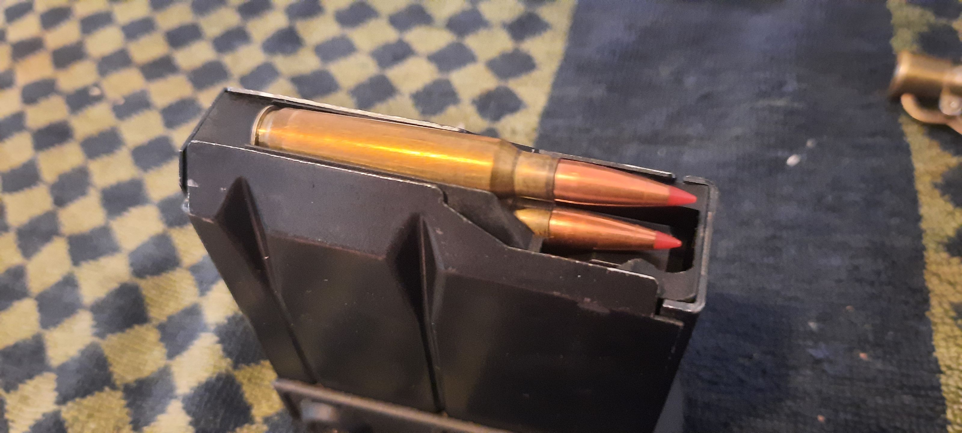

The CTR magazine is considerably longer than factory standard and you should have no issue loading the 80 SMKs in the 223 case and feeding them through that rifle. I run the ELDX which is 60 thou longer than the SMK and have zero issue with length in the magazine to spare. Standard 223 magazine length is 2.240", length on a CTR magazine is 2.560". Just fill the case up with 24 grains of 2206H, load to 2.520" OAL and if it don't shoot sub half MOA, burn it. Just about every FClass shooter in the country that runs a 223 uses that bullet and load.

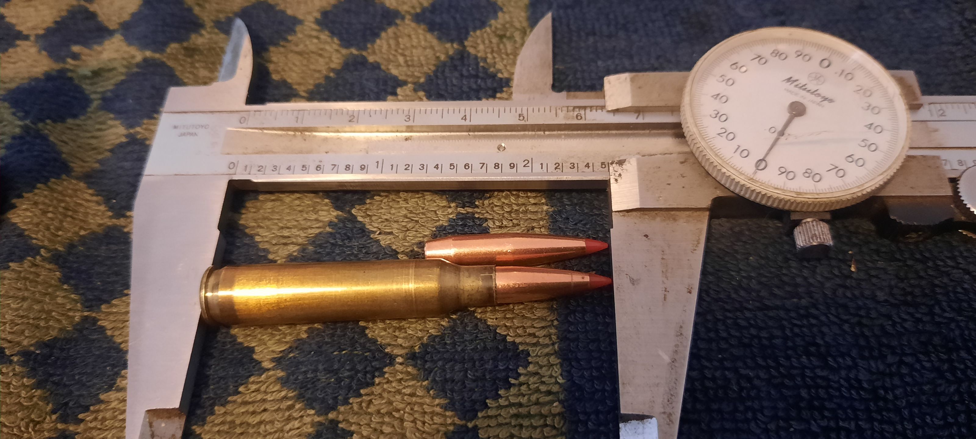

Fat fingers at play, 2.240 standard mag length should be 2.340" like Howa or Tikka plastic mags. As Blade said check your lands position but my experince with 8 twist Tikka/Sako barrels is they are throated long. 2208 can work in some rifles with the 80 grain bullets but you will run into compressed charge issues earlier.
Below is my own CTR setup for hunting loads, set off the lands at 2.500" and the 80 grain ELDX. As said above they are longer than the 80 MK.

On my CTR, it isnt the mag that limits my my max. COAL; it's the distance to the Lands (as others have pointed out).
COAL on the factory mag is 2.559" or therabouts.[Likely 2.6" in reality]
COAL on the Waters Rifleman mags (I bought 2 extra) is 2.4"
Using a comparator (measuring to the ogive), For a Hornady 75gn BTHP Match projectile, I get a max cartridge length of 1.881".
I also measured the max COAL at the same time; an average max Cart length[COAL] of 2.2934".
Still around 0.3" shorter than the COAL for the factory mag(and 0.1" shorter than the Waters mags can handle).
I get that the 80Gn Sierra MatchKings are going to be a slightly different profile/shape, but I'm betting you should be able to come up with a COAL that sits them just off the Lands, but still short enough to fit in the factory mag.
I can only strongly suggest you get some calipers, and a OAL Gauge with a .223 modified case to suit (I use a Hornady Lock n Load straight OAL gauge), and take an average of multiple of measurements, to get an idea on the Max length for your rifle.

No issue with ctr mag fit. Very happy with the outcome.

the length measured with the 22 cal hornady bullet comparator on was 1.900 inch for my CTR.
measured the max length with the hornady OAL gauge.
made a dummy round to see if it would chamber and extract before making a whole bunch of them.
