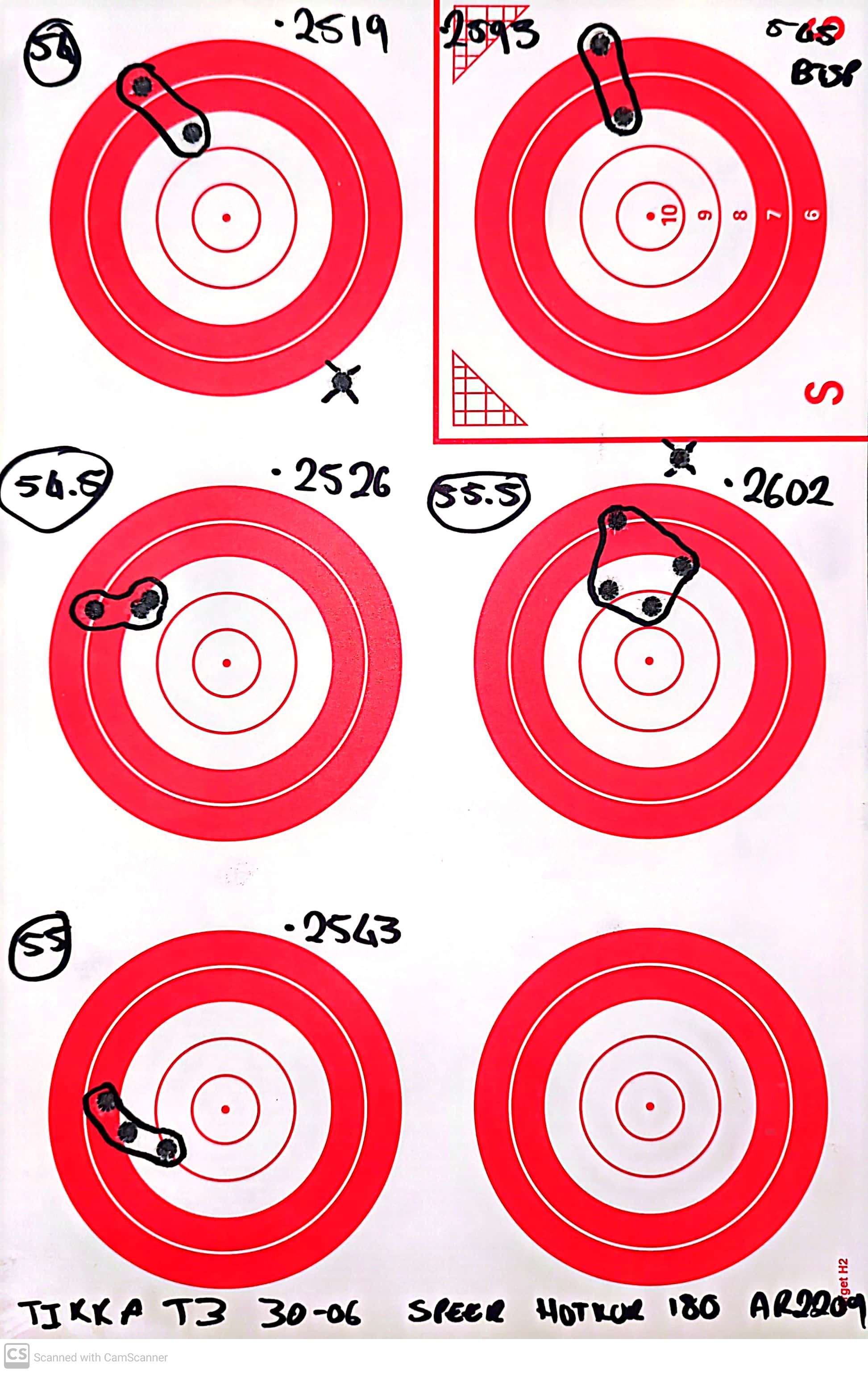

Post by SneakyPigeon22 » 17 Mar 2024, 8:12 am
I thought I'd dig this old cow out of the ditch with a recent experience of my own:
I reload 30-06 for my Tikka T3 Battue and started out with 180gr Speer HotKor (flat base) bullets, did my load development and settled on 54.5gr of ADI AR2209. Recently I changed to Speer BTSP bullets and also found that the BTSP bullets seated a fair bit deeper than the HotKor. I loaded them with the same 54.5gr charge and took the chrono to the range, and the difference in average velocity is around 70FPS with otherwise identical metrics (same cases, primers, env conditions). Also ran the data through GRT and saw that with the boat tails seated at 12mm, the projected chamber pressure was over 50k PSI. Still within safe limits, but creeping up from where the HotKor's were.
Below is the target from my range tests. Values in circles is the charge, and opposite 4-digit values are average velocities for the group.
Load Test Results for Tikka T3
Tikka3006_Chrono - Copy.jpg (336.54 KiB) Viewed 5578 times
