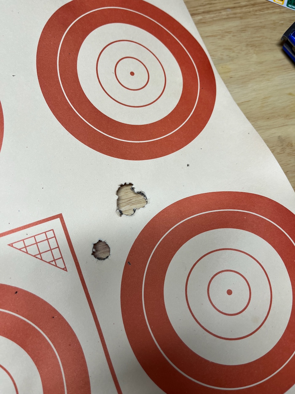

I don't know how effective this is as it's pushing the 300 grain very fast and kicks quite a bit but I doubt a pig will be left standing with this load
both were sub MOA at 100m so these primers are not bat at all, never had a misfire or install issue

Post by zbenga » 08 Apr 2024, 2:17 pm
did some more testing with these primers and got a load worked out, in order to get good accuracy I had to push it to 1950 fps (350 grain pills)
this is a the best and last group, 5th shot (last one) I now I pulled because my shoulder was actually hurting, haven't measured but it's probably around 1moa at 100m
shooting lever guns off the bench at around 2000fps is brutal
group is a big high was aiming for bottom right target, I think that's the difference between 1800fps and 1950 fps
so far I'm happy with these primers and have 3 good loads with them which shoot with same accuracy and consistency
300grain Sierra HP FN
350 Speer hotcor
350 Hornady FN
