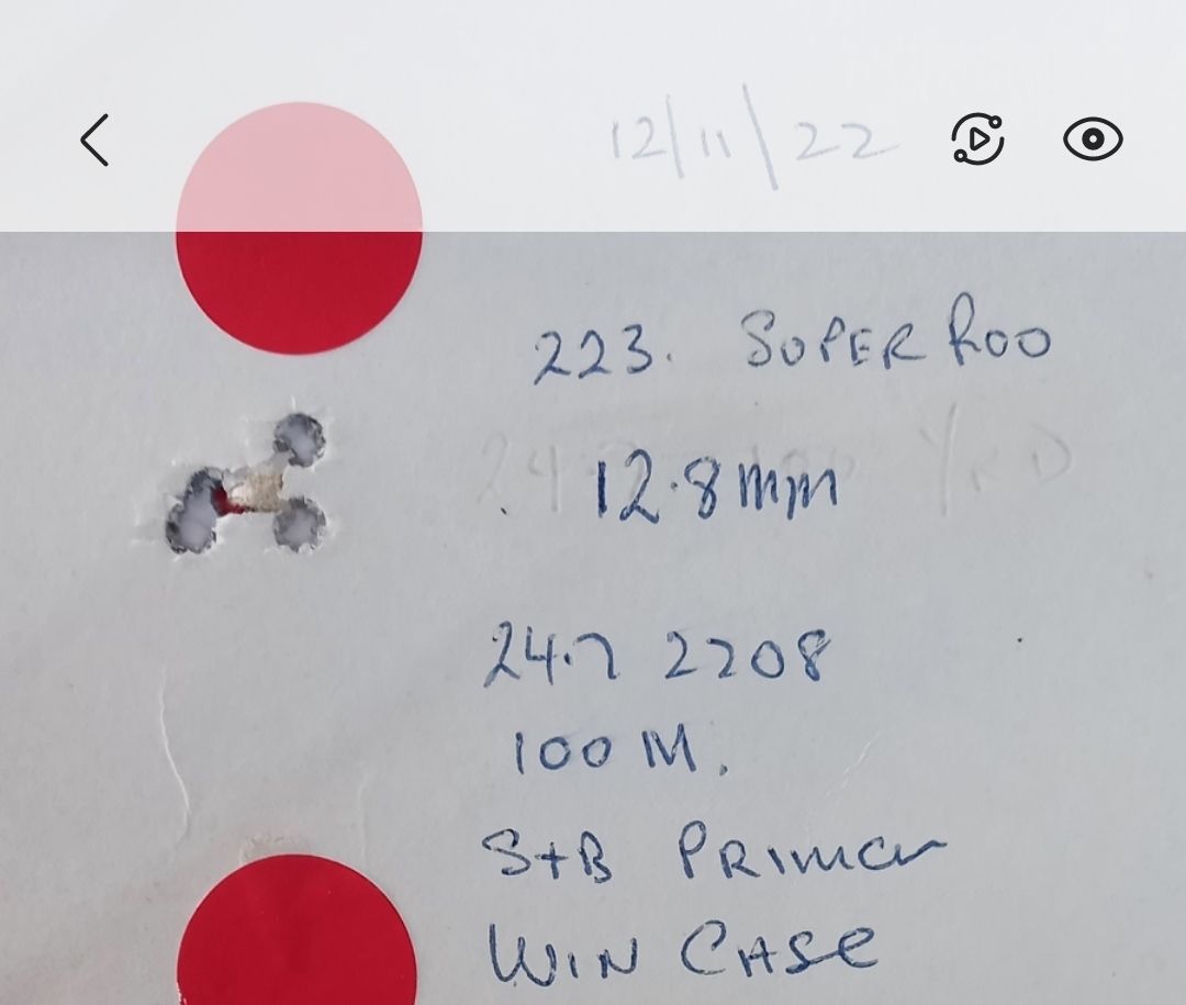

The load I recently worked up are Winchester cases. (see pic) This will be my new all round 223 load.

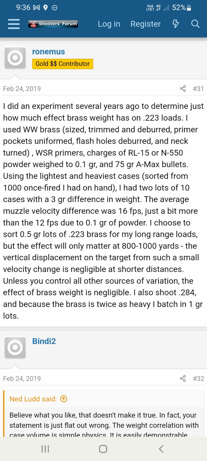

Post by Wm.Traynor » 18 May 2024, 7:22 pm
https://forum.accurateshooter.com/threa ... y.3972946/
Take a look at the reply by Bindi2 23-2-19 #10
Sounded relevant

Post by Oldbloke » 18 May 2024, 9:50 pm
deye243, looks like you summed it up well. Thx
WmT, thanks for the link. Interesting reading.
Seems weight variation doesn't correlate exactly with volume but fairly close. This was my initial guess anyway.
Seems up to about 3.O gr variation in brass weight does SFA. (223)
For interest, I roughly cut the neck off a 223 case. (Only had tin snips to it was rough. Lol.) About half of it weighed 2.5gr. So it's buggerall difference in volume.
I think reply #31 answered the qn best.

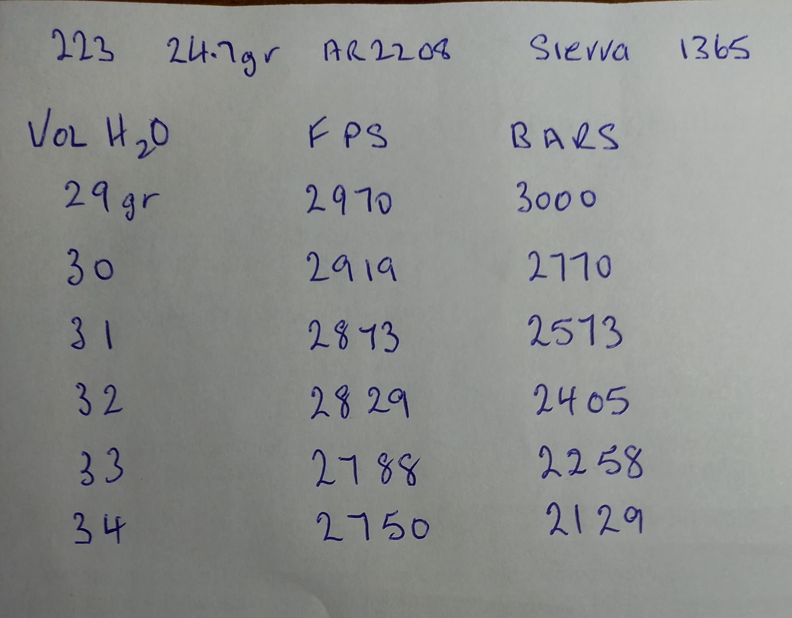

I thought I would run this through Gordon's Reloading Tool.
Same load 24.7gr AR2208 with 55gr Super roo bullet.
Only change made was case volume. 31gr was the default/ave.
At 26gr I got a pressure warning.
FILE DELETED
Thoughts?

Post by Oldbloke » 21 May 2024, 3:44 pm
GRT said average capacity was 31gr.
Your right, 5gr is stupid amount, 1 or 2 would be far more representative. I'll have another look, perhaps tonight.

Post by Oldbloke » 21 May 2024, 8:30 pm
OK. I've revisited the GRT and come up with more realistic volumes.
NOTE: Ideleted the previous image as I discovered some errors due to wrong powder entered.
Here is the new data. 31gr is the default or average given by GRT.
Thoughts?

Post by bladeracer » 21 May 2024, 9:19 pm
Oldbloke wrote:OK. I've revisited the GRT and come up with more realistic volumes.
Thoughts?
An additional 230fps for that last 1gn of H2O seems in the ballpark to me. I _think_ seating a .224" bullet another .160" (4mm) deeper into the case will decrease volume by 1cc (somebody might want to check that as I did it quick). I haven't tried adjusting seating depth by as much as that, as far as I can recall. But that's similar to seating an 80gn bullet at 2.450", then seating it at 2.290", on the same powder charge. I would definitely expect it to spike the pressure. I guess I could load some on a lighter charge at 2.290", and some on the same charge at 2.450" and see if I loose 230fps between the two loads.
If you compare the H2O volume with some powders, like AR2206H, the powder must have similar bulk density to water. My PPU brass holds 27gn of AR2206H filled to the case mouth, Tikka holds 26.35gn - but I didn't note if they were fire-formed to my chamber when I measured them. If you compare Berger's 80gn load data (they load to 2.260") to other people's load data (more likely in the 2.450-2.500" realm) perhaps there's a grain difference between them.
Thoughts?
Nah, more like 1/4cc. 1cc is about the size of a dice.
I noticed that too. If max load is say 27gr and water capacity is 31. Must be much the same.
Thoughts?
Yes, that sounds more like it :-)
