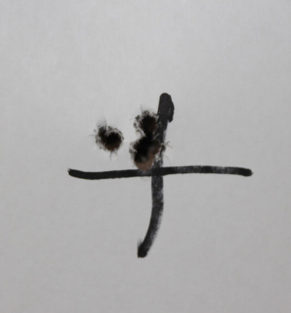

Thanks Billo
Judging from the group above, which was the minimum load of 22gn 2208, with very little tinkering they'll be like the 62s I tested earlier. That group above was in a 25-30kph wind at ~80° right, they don't seem to notice the wind that pushed 55gn RooMax up to 4" left at the same range.
The pic below is the 62s at 100m with 24gn of 2208

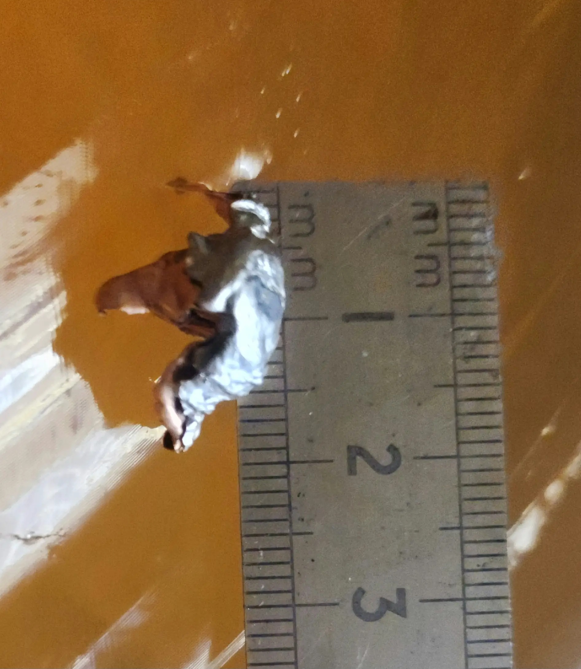

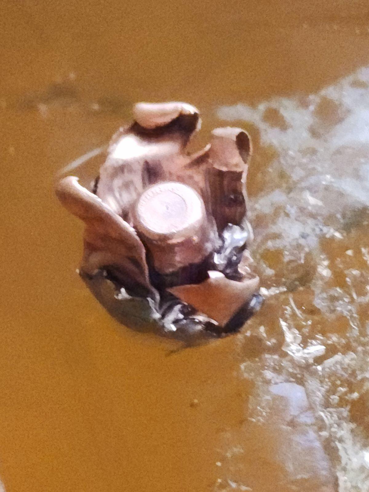

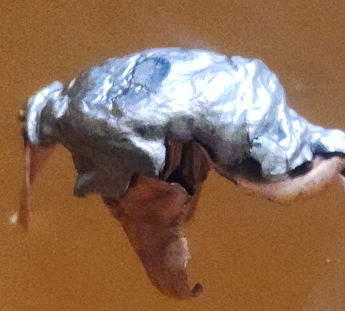

Geez thats a tidy group for 200! Also I saw the damage to the gel block on youtube/facebook and I doubt much would trot off after that. Jeepers.
I have some Rexem's as well and shoot like a laser!
Just freakin brilliant.
And yes they are about to release a 6mm 105-110 gr projectile. I think they are releasing it this or next week?
Thsi was my favourite picture you posted of the projectile's expansion.
Rexem 80 expansion

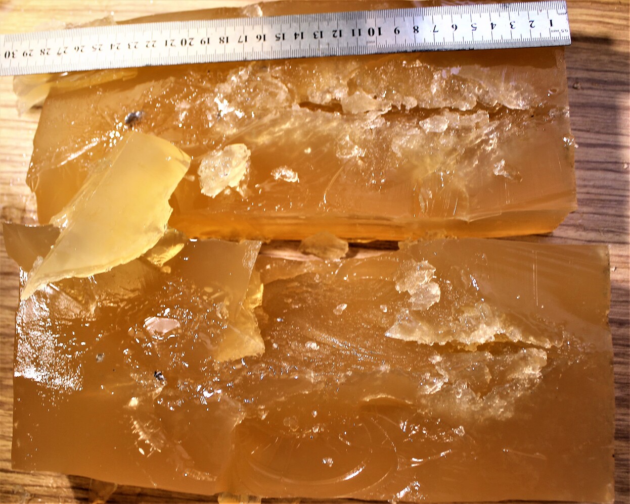

Ta
There's so much to like, eh?
When I tested the 62gn F-Bombs, they actually blew the 30kg block in halves, and given this, I fully expected the 80s to obliterate the block and go about its business.
The fact that it actually dumped the majority of its kinetic energy into the gel in the first couple of inches and actully stopped is a pretty graphic indicator of terminal performance in the field.
This is the permanent wound cavity from the 62gn F-Bombs, the 80gn hammered the block so hard I couldn't do my normal autopsy.

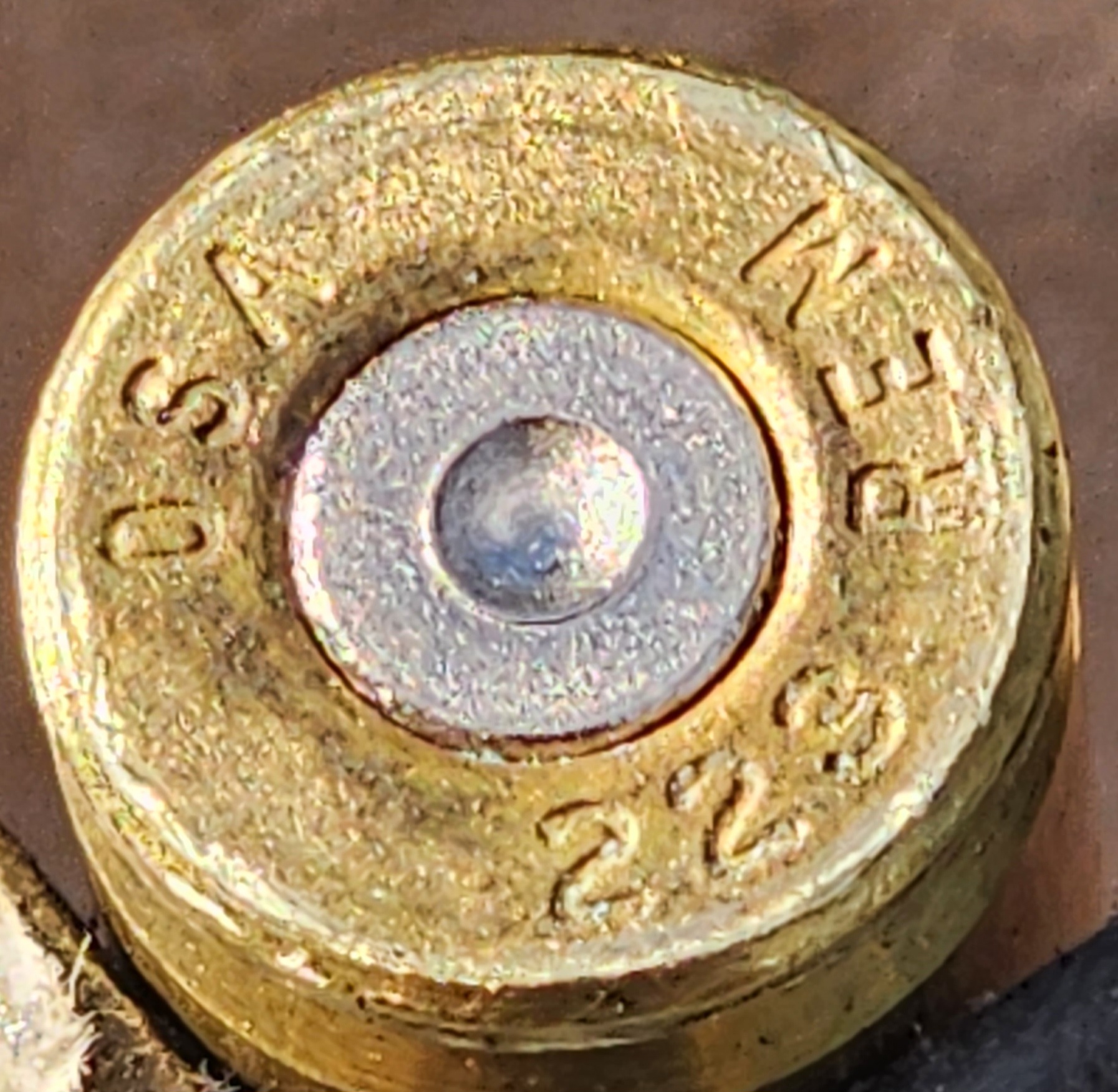

When I tried 24.5 behind the 80s today there was just the beginning of pressure sign
Not enough to be a worry, but a caution against going further.
