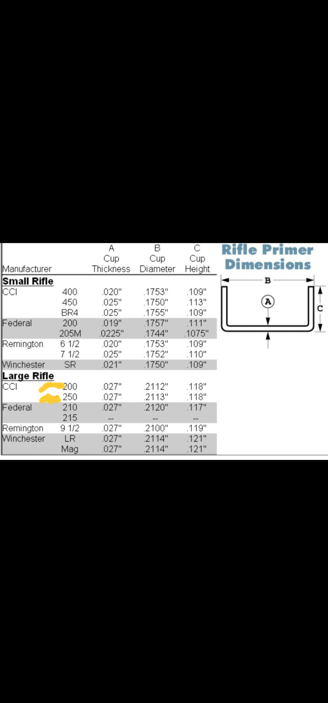

Post by deye243 » 21 Aug 2024, 11:35 pm
Cci 200 and 250 primers have a primer cup that is 0.027"
Posts: 2774
