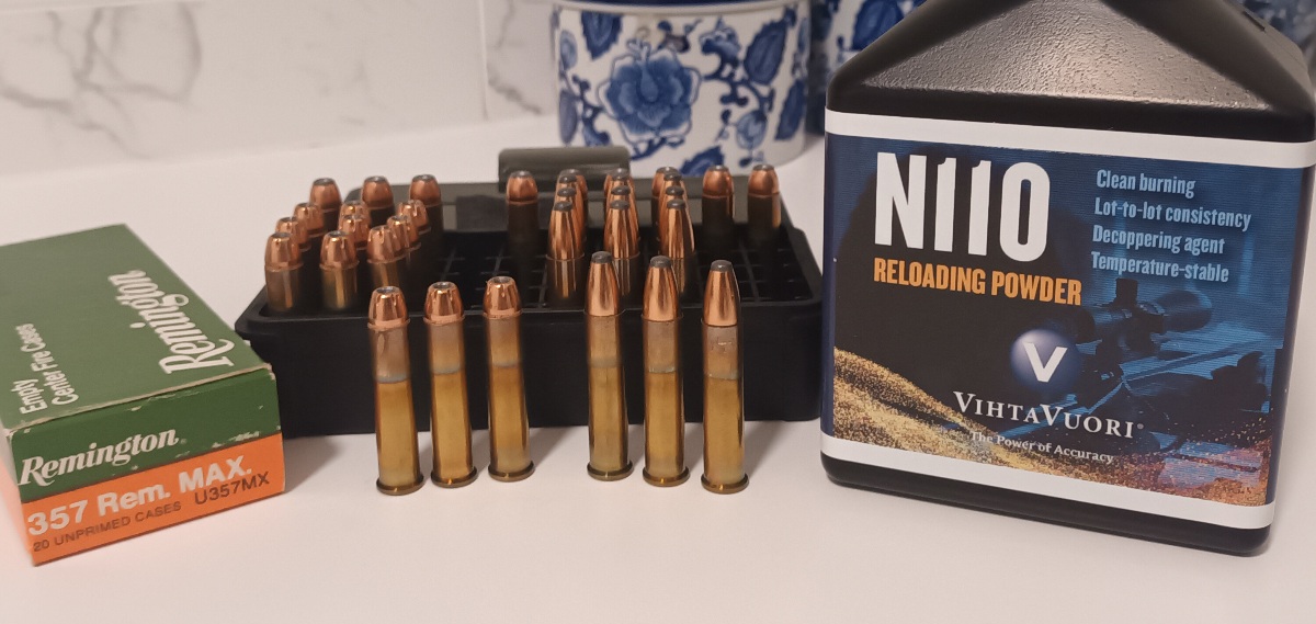

A mate has been playing with a 357 Maximum rifle recently and wasnt super happy with his loads so I offered to have a crack, Its an interesting cartridge and 1 I had considered building previously on a Martini cadet.
Rifle is a Bergara 357 Magnum thats had a 357 Maximum reamer run in it. Plan is to have a range session next week :drinks:
Anyone had any experience with the 357 Maximum ?

Yeah there is a real cult following of the 357 Max in the US, Michael Bellm has been a driving force
https://357maximum.net/
WHen load up with a long throat 180grs Speer FNSP can be driven at 2300fps which puts in into the 35 Rem category and overtakes the 44 magnum :drinks:
