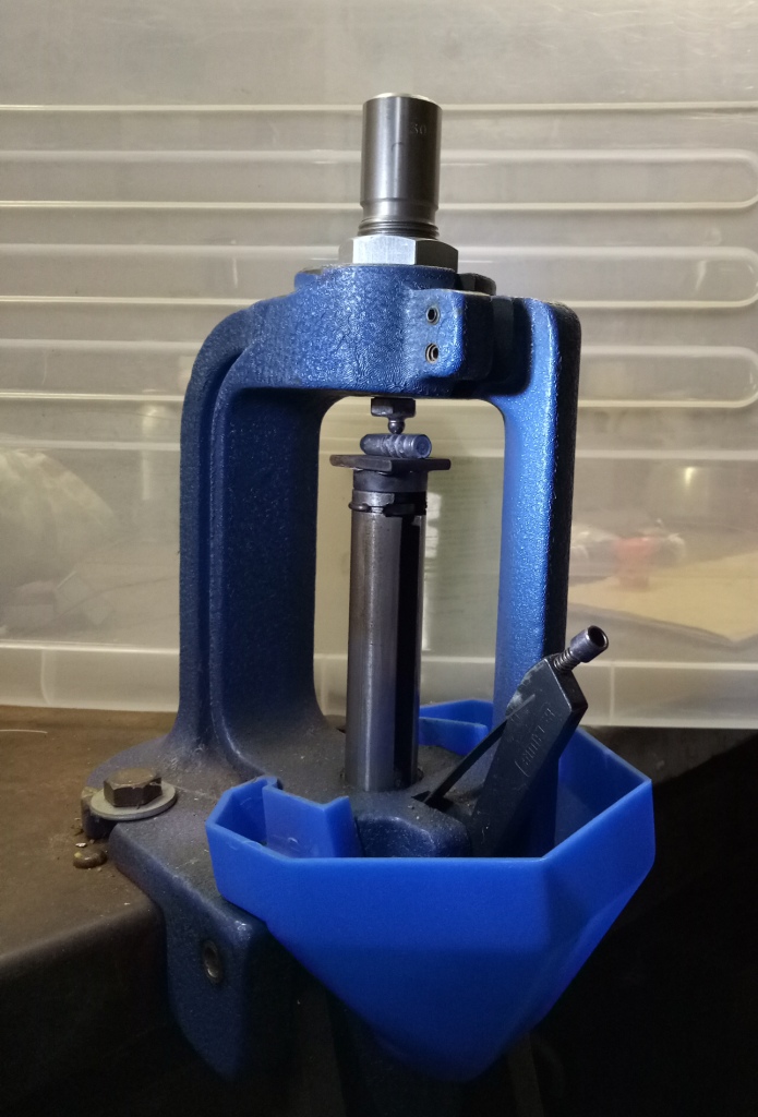

Here it is in use. You cannot see the 5 kg weight hanging off the press handle. After 30 seconds I take it out & I then measure the dent using a vernier with a magnifying glass and punch the number in to a spread sheet I was sent from the other web site. (if anyone wants a copy PM me with an email address & I will send it.) The cells in red will need to be changed to suit your press.)

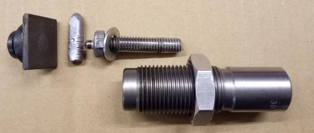

The parts are simple a 3/16 ball bearing soldered to a bolt. When in use the bolt is slid into a lee 308 bullet sizing die to hold it in place and give me some adjust ability. And a piece of 3mm steel cut to size and soldered to an old case holder, this acts as a seat/table for the projectile or material being tested.. see below.

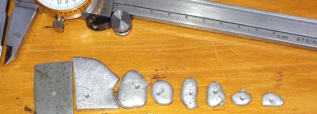

It works a treat. I did the test on a piece of roofing lead as a control as you will see result was BHN 4.9 .....Lead is 5.0 Weight on press arm is 5kg So the system is certainly in the ball park. I guess the biggest error will come from the measuring. To measure the dent I just rigged a magnifying glass and used a set if metric dial calipers. A spread sheet completes the calculation.
I got most of the info I needed from here.
http://mountainmolds.com/bhn.htm
Results on the range lead I was given by shootermick.

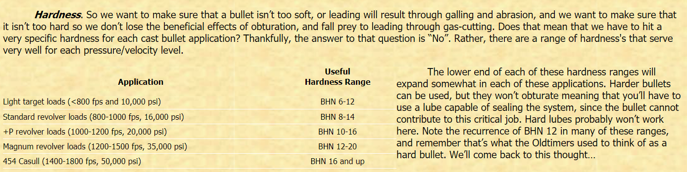

10.0 10.4 10.4 10.0 8.4 9.2 8.4 Too soft for me so I will need to add some wheel weights or tin to increase the hardness to about BHN 16 or more.

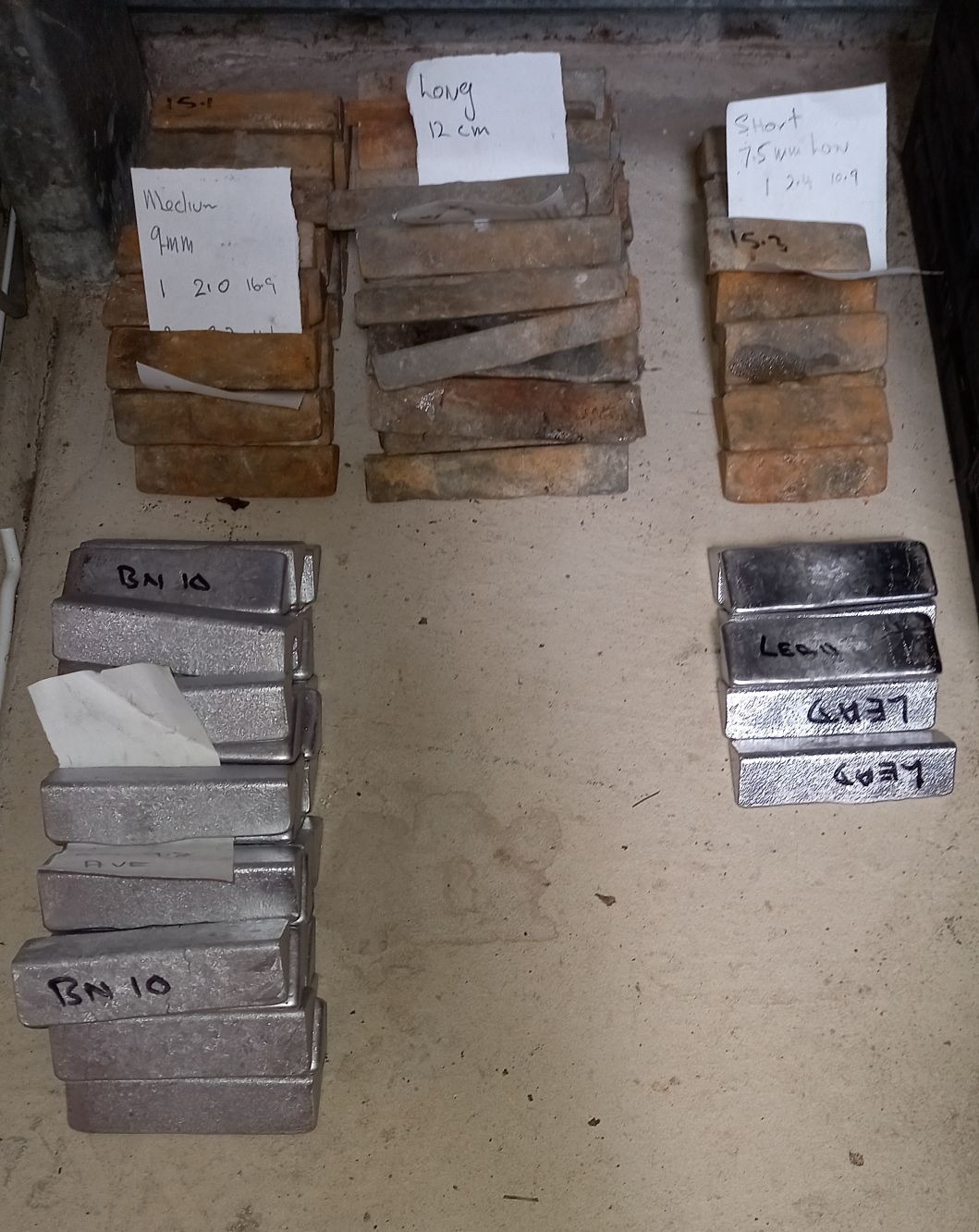

Well I had a fair bit of alloy stashed behind the shed but never labled it. Lead/wheel weight mix.
So, took a few random samples today and did the brinell test. All sorted and labled now and inside near the reloading gear too. Now I can blend it when I'm casting and know what hardness I'll end up with.
