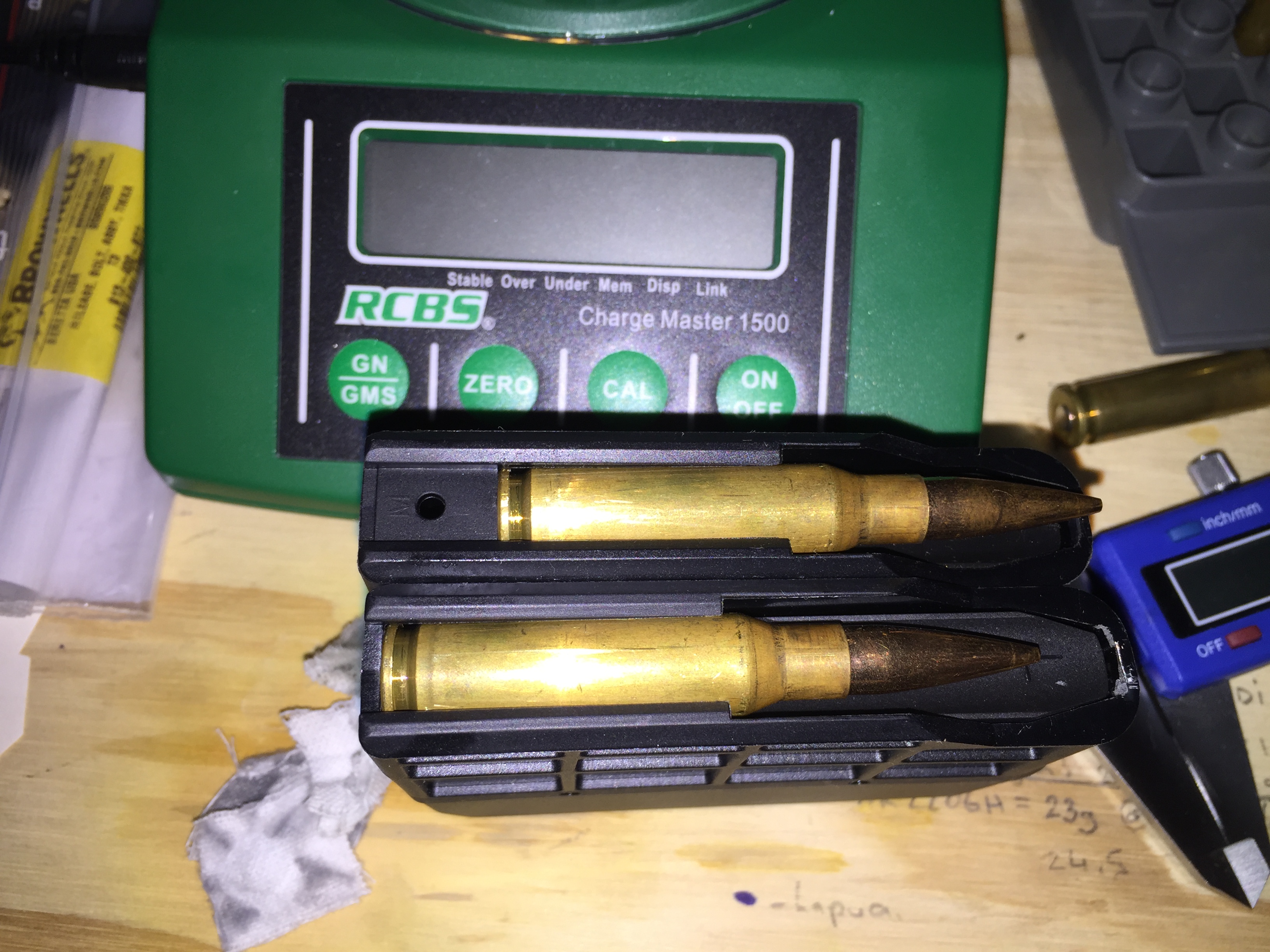

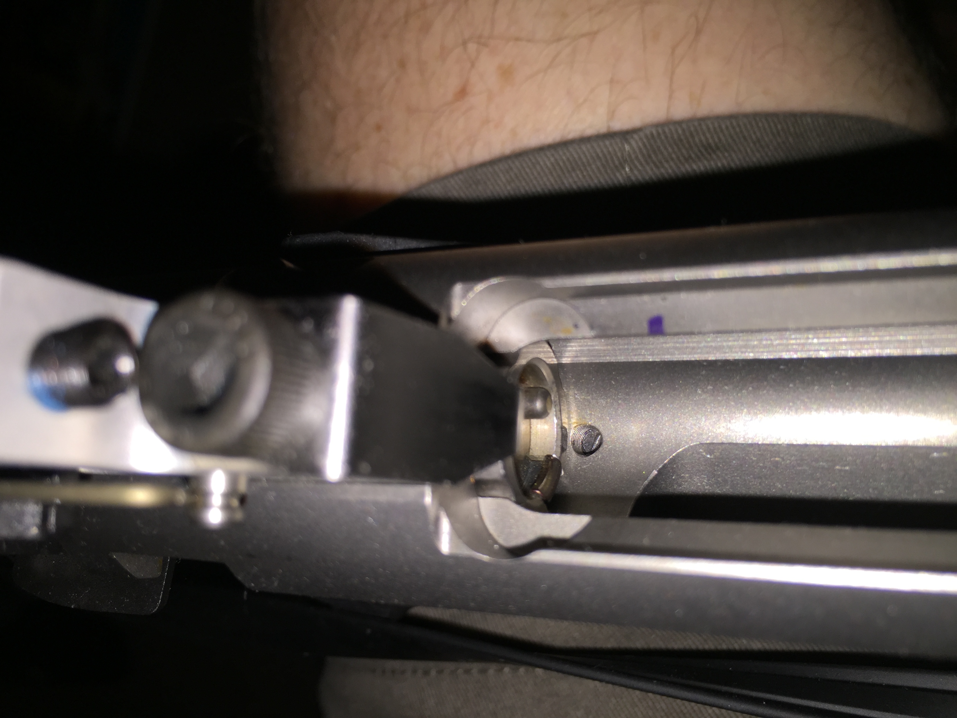

Tikka T3 Varmint 308w & long OAL fix. 2.900"+
I been wanting to seat my projectiles out to the lands but couldn't find any defiant fix. I didn't want to hack up my mag or chop my bolt release. So I just bought a tikka 30-06 mag and a long action bolt release assembly pack from brownells in the US sent to aus for about a $100, & mag was $130. The rounds feed and eject like normal. There's a vid on ytube on how to swap out the bolt release easy as. I've attached photos of the mags side by side with 2.900" oal bullets, also the under side of the bolt once I replaced to new bolt release button
Cheers John Rambo

Re: COAL for Tikka mags
Post by RealNick » 17 Mar 2016, 1:25 pm
Nice workaround :thumbsup:

Post by hughston » 17 Mar 2016, 5:53 pm
The main reason I changed the action length was to experiment with Berger match projectiles, if seated at standard length 2.800" I'd loose on case volume. When speaking to full bore shooters some seat closer to the lands and some don't bother. From my short experience with hand loading I haven't noticed a great difference, but the Berger match projectiles have made a big difference with accuracy and I'm sure other projectiles with the similar ogive style would shoot the same. My tikka also probly isn't suited for fine tuning ammo but it's an interesting hobby
hughston
Posts: 17
Post by Korkt » 18 Mar 2016, 2:31 pm
Good solution for the Bergers. Those buggers are looong.

Post by winton » 08 Apr 2018, 4:34 pm
If you notice in the third pictures from hughston above, the 30-06 magazine feed lips is shorter than the 308.
Is it possible to take out the back stop on the end of the 308 mag and use the 30-06 follower in that mag instead to take advantage of the longer feed lip?

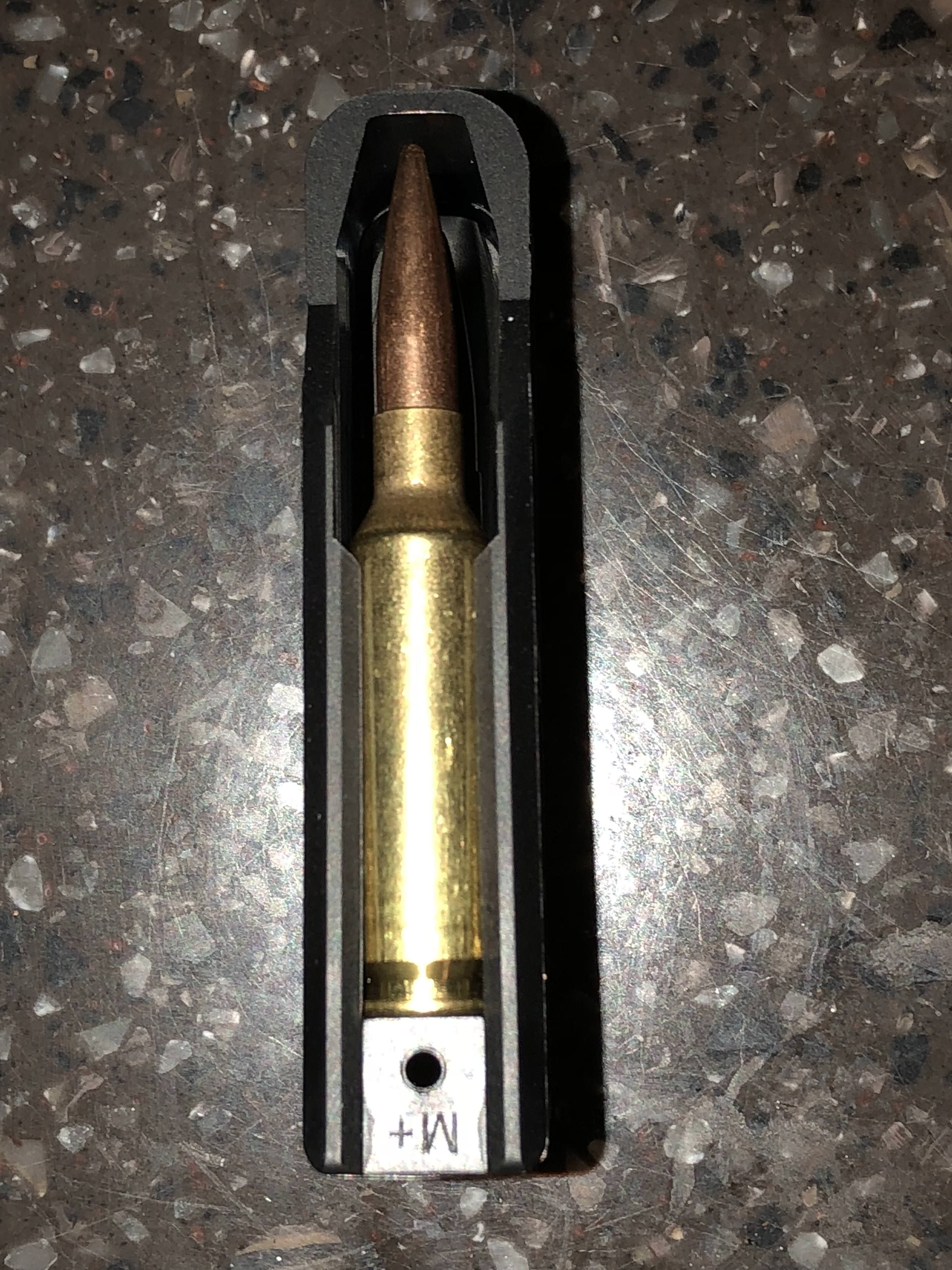

Post by Nigel » 29 Apr 2018, 12:19 am
Tikka now makes an 'M+' magazine that they are shipping with T3x rifles chambered in 6.5 Creedmoor. They are the same as the 'M' size magazine except they have a shorter spacer in the back and longer follower to suit. It should be possible to buy these and swap out or modify the bolt stop to suit as discussed in hughston's post above.
I have been looking into this topic. The internet consensus on T3/T3x magazine internal lengths seems to be roughly as follows:
M (308) 2.83in (71.8mm)
M+ (6.5 Creedmoor) 2.98in (75.7mm)
LG (30-06) 3.37in (85.6mm)
CTR 2.92in (74.2mm)
There is also 'SM' for 223 and similar size cartridges.
Nigel
Posts: 63

Post by steadyeddy » 03 May 2024, 2:16 pm
Just for those interested, you can use the M+
mag without swapping out the bolt stop, the rounds feed okay, well they do with my 7mm-08
