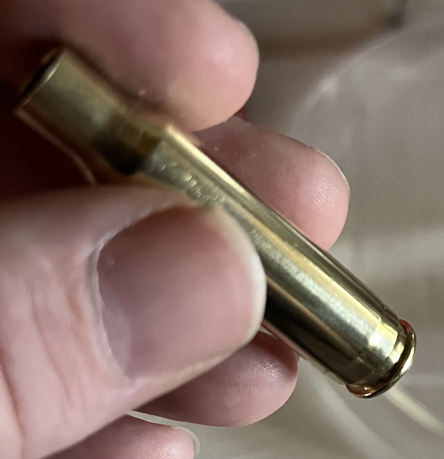

Post by Robin » 11 Mar 2025, 10:41 am
I found some once fired Winchester brass at home , it’s mine so I know that only I have handled it, after giving it a bath and then i ran it through a full length reloading die , after I finished all of them, I did my inspection and noticed this ring around the bottom of all of by Winchester brass , all of them have this ring around the same place , would you say this is ok or is it a throwaway , if it had happened on only one , then I would have tossed it but on 30 , I’m a little concerned.

Post by stihl88 » 11 Mar 2025, 11:23 am
It's like it wants to be a belted magnum cartridge!
More than likely where the sizing die smooshed the case back into spec ~ https://www.reddit.com/r/reloading/comm ... _resizing/
Maybe sacrifice one and sand it down half way to inspect case thickness at that spot.
Does the chamber look co-planer, no proud spots? Wouldn't be the first time a chamber has been reamed poorly.

Post by Tinker » 11 Mar 2025, 11:57 am
I had a similar issue with some 6.5CM brass I found at the range, after full length sizing they all had a shiny ridge just forward of the case web. This wasn't present before resizing. This of course is a warning sign of impending case head separation in rimmed cartridges like .303. I cut one in half lengthways with a dremel and found there was absolutely no thinning of the case wall at that level. It was just due to the FLS die. I've since reloaded them several times with no problems.

Post by Robin » 11 Mar 2025, 3:33 pm
Tinker wrote:I had a similar issue with some 6.5CM brass I found at the range, after full length sizing they all had a shiny ridge just forward of the case web. This wasn't present before resizing. This of course is a warning sign of impending case head separation in rimmed cartridges like .303. I cut one in half lengthways with a dremel and found there was absolutely no thinning of the case wall at that level. It was just due to the FLS die. I've since reloaded them several times with no problems.
I just cut one open and the bottom part from the crease down was slightly thicker then top part

Post by Oldbloke » 11 Mar 2025, 5:15 pm
It's normal. Caused by a variation in manufacturing tolerances

Post by on_one_wheel » 11 Mar 2025, 5:33 pm
Perfectly fine ....
Basically the the walls have expanded to prety much match the chamber (it does spring back ever so slightly) but the head of the case is pretty solid and has (Should've) remained the same size.
The area you are concerned about is a high stress area, especially if you full length resize regularly, it's definitely worth watching out for cracking there as that's exactly where they go.
Often you'll see that ring more pronounced on one side especially on first firing, that's due to the fact the brass will sit in the bottom of the chamber leaving most of the gap at the top, upon firing the brass expands upwards to fill the gap.

Post by Robin » 11 Mar 2025, 5:54 pm
Thanks, I thought I might have stuffed up. In regards to full length resizing, the Hornady resizing die does that when de-priming , is it not recommended to use that each time.

Post by Blr243 » 11 Mar 2025, 6:11 pm
I recently noticed some marks on my spent 4570 cases Do rimmed straight walls cases be prone to sep at the bases ? I thought this problem was more likely in bottle necked cases that have been FLS in a longish chamber

Post by Wapiti » 11 Mar 2025, 6:45 pm
308 Winchester brass, in all our rifles, does that after the initial firing and sizing.
Awhile ago I sectioned a few brands we commonly use, and the Winchester brass is noticeably thinner. It expands in a size relationship to the chamber it's fired in, and the most noticeable area is just in front of the solid head. Don't worry about it.
Just keep in mind that, if your Winchester brass, or any other brands that's thinner, will not last as long as the thicker brands, especially if you are someone who adjusts your FLS die to contact the shell holder as the instructions say, you will be oversizing (probably shortening the case) and when fired like that each time, will not last as long as thicker brass will before separating.
That's not very good practice no matter what brass you use.
Solution is to check out the other thread on just bumping the shoulder back just enough to close the bolt with just a little "feel". This is actually better than just neck sizing because a full length sized case, when it enters the die first-up, actually gets a bit longer.
Then, when you continue to size and just lightly "bump" the shoulder back just enough to chamber, the tapered design in the case will actually "centre" the cartridge perfectly in the chamber... like a countersunk bolt in a chamfered hole.

Post by Gamerancher » 12 Mar 2025, 7:54 am
Most factory full length sizing dies when fully adjusted will take the case back to minimum SAAMI specs.
If your fired brass won't rechamber easily, you can play around with your die to just size enough to suit your chamber by backing it out then incrementally sizing your brass until it fits your rifles chamber. Of coarse it needs to be resizing the neck enough to grip the projectile.
Blr243, yes it happens with straight walled cases, it just means the head and web of your cases aren't the same diameter as your chamber.

Post by wanneroo » 13 Mar 2025, 2:36 am
You can do the paperclip test. Unfold a paper clip, bend it as such you can insert one end into the case with a slight angle on it so you can drag the end of the paperclip along the inside of the case. Drag the end of the paperclip along the inside wall of the case from bottom to top. If the case is all good, it will be a nice straight, smooth clean pull along the interior wall of the case. If case separation is impending, as you drag the paperclip along you will feel a divot or click and if it doesn't feel smooth you've got a problem.
That is just a cursory check, keep in mind case separation can happen at any time, sometimes out of your control.

Post by stihl88 » 13 Mar 2025, 11:05 am
Also don't hesitate to use a borescope if you have access to one https://youtu.be/mPkaqimrohs?si=0B_vFkB1zWUZdgh7&t=185
Should be able to determine if these are normal sizing marks or the beginning of case separation.

Post by Wapiti » 13 Mar 2025, 11:33 am
Don't rely on the paperclip test. I've had enough separations where I've checked using a spring wire tool I made a small couldn't feel a thing. Sure was obvious when they f,ew out of the chamber in two though.
I'm not saying don't use it. It's just not the sure thing people say it is across the board.

Post by on_one_wheel » 13 Mar 2025, 7:35 pm
You could mess around testing for cracks with some dye penetrant if you want experience the joy of staining the s**t out of yourself, everything you're wearing and everything you touch.

Post by wanneroo » 14 Mar 2025, 2:46 am
Wapiti wrote:Don't rely on the paperclip test. I've had enough separations where I've checked using a spring wire tool I made a small couldn't feel a thing. Sure was obvious when they f,ew out of the chamber in two though.
Nothing is a sure thing when it comes to ammo or reloading.
Better than nothing though, I have found brass that on first inspection looked fine but the paper clip told otherwise.
I have no sentimental feelings about brass. If there is any suspicion I have about a piece of brass that is not right, I just toss it in the recycle bucket, no hesitation at all.
