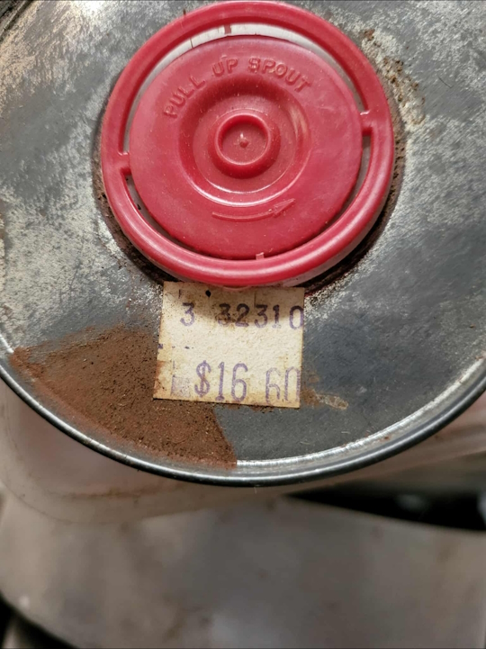

I was offered two and a half one-pound cans of Bullseye, which I don't use. I poured some of the open one into my hand and it looks good to me. I can't smell so can't test it by smell. Thinking I might load five rounds of .38 Special and shoot them over the chrono to see if it is still good.
I need to pass it on to somebody that uses it but we don't know what a fair price is for it. It was $16.60/lb back in the day, the seventies I'm guessing, but what's an unopened can worth now? I had a look at used guns and this stuff was advertised for ludicrous prices during '22-'24, but with pistol powders back on the market I'm sure it's selling for more realistic prices now. Three years ago a one-pound can was advertised for $535!

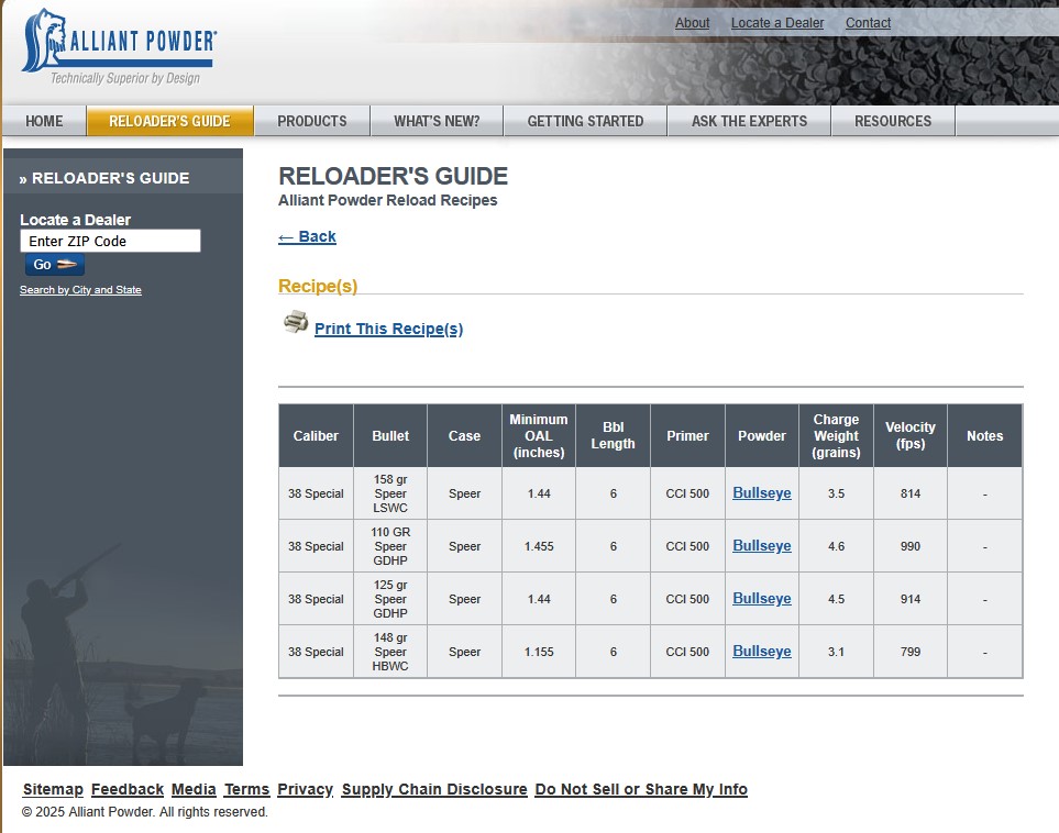

I'll chrono some and compare to Alliant's data.

It's too valuable to waste, and the chronograph will give me a more accurate idea I think. If the book says a 3.5gn charge should make 814fps out of the 686, and I see 780fps I'll consider the powder to be good. If I see 650fps I might have to consider it suspect, in which case I'll keep it myself and use it for Cowboy loads.
