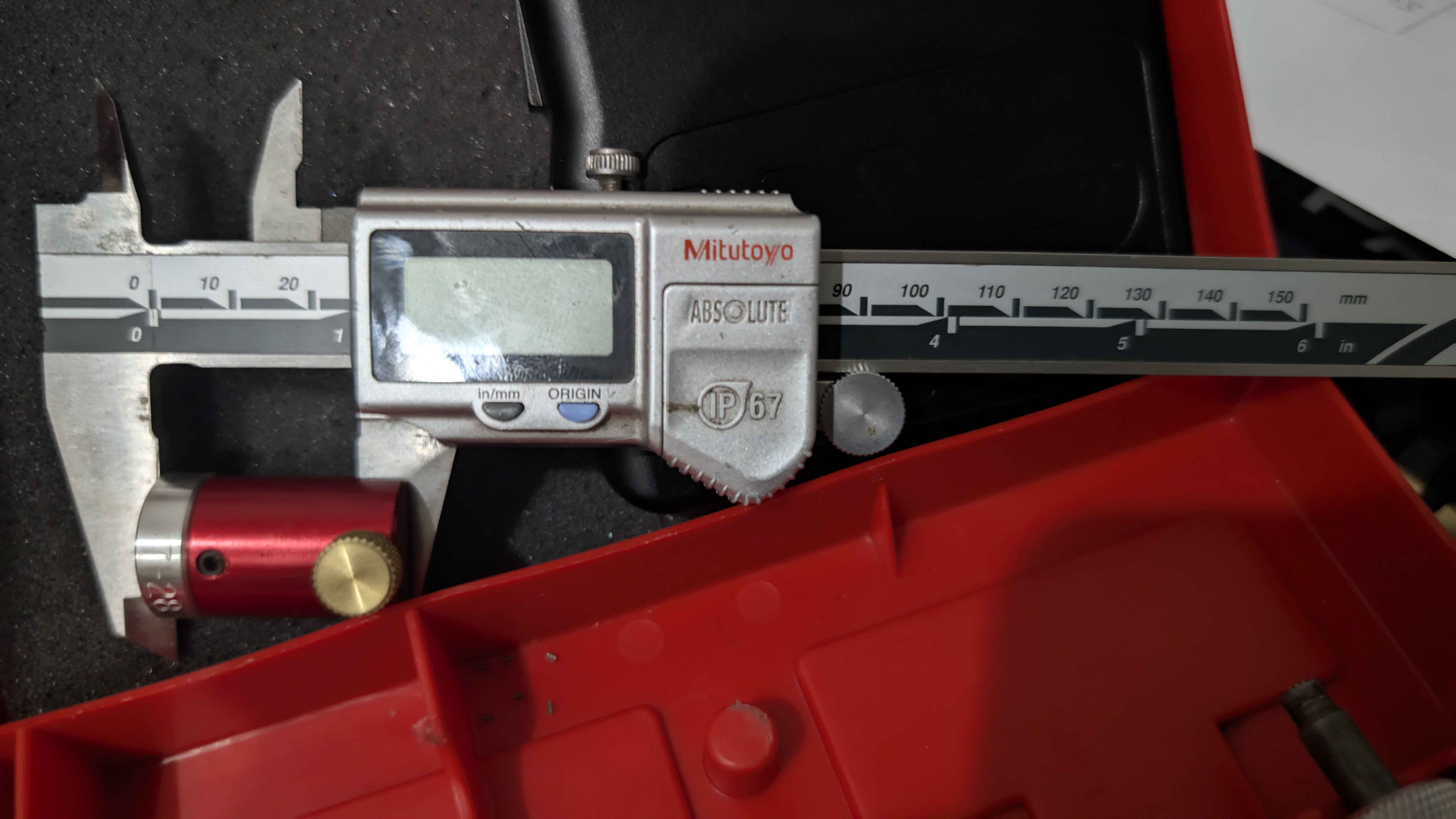

I do have a pair of digitial calipers, this pair is a little old but still goes ok (Mitutoyo 500-752-10).
The results I tested were repeatable, hence why im confused. Each one was pulled out and checked again 4 times and matched the written down measurement (I even mixed them up for the hell of it and knew what each one was because it was the same).

Found the problem after measuring 70 projectiles, I'm the problem. I had dropped two Sierra TMK 69g in the Hornady ELD-M box. Turns out its ~0.040" difference between the two projectiles. I'm red/green colorblind so the tips didnt alert me to my stupidity and I never put a "good" one next to "bad" one, then it would have been obvious with the length difference.
Might be time for me to clean my bench and keep things more separate when working :crazy:
Sorry for wasting everyones time, again.
