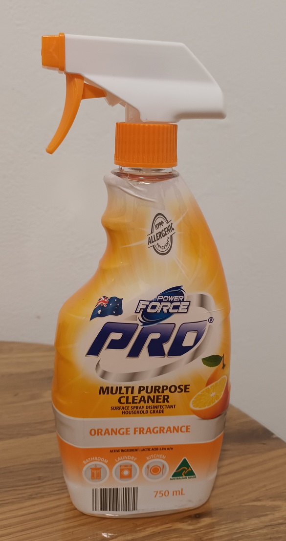

Post by Billo » 25 Sep 2022, 6:34 pm
Recently squirted some Aldi Orange Blossom into my Ultrasonic cleaner as is contains 2.4% Lactic acid. Also a few caps of white vinegar and lemon detergent with hot water.
Brass came out the cleanest I've ever done in only 6 mins. :drinks:

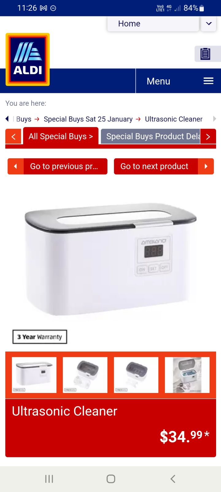

Post by Oldbloke » 23 Jan 2025, 10:35 am
Aldi have them again.

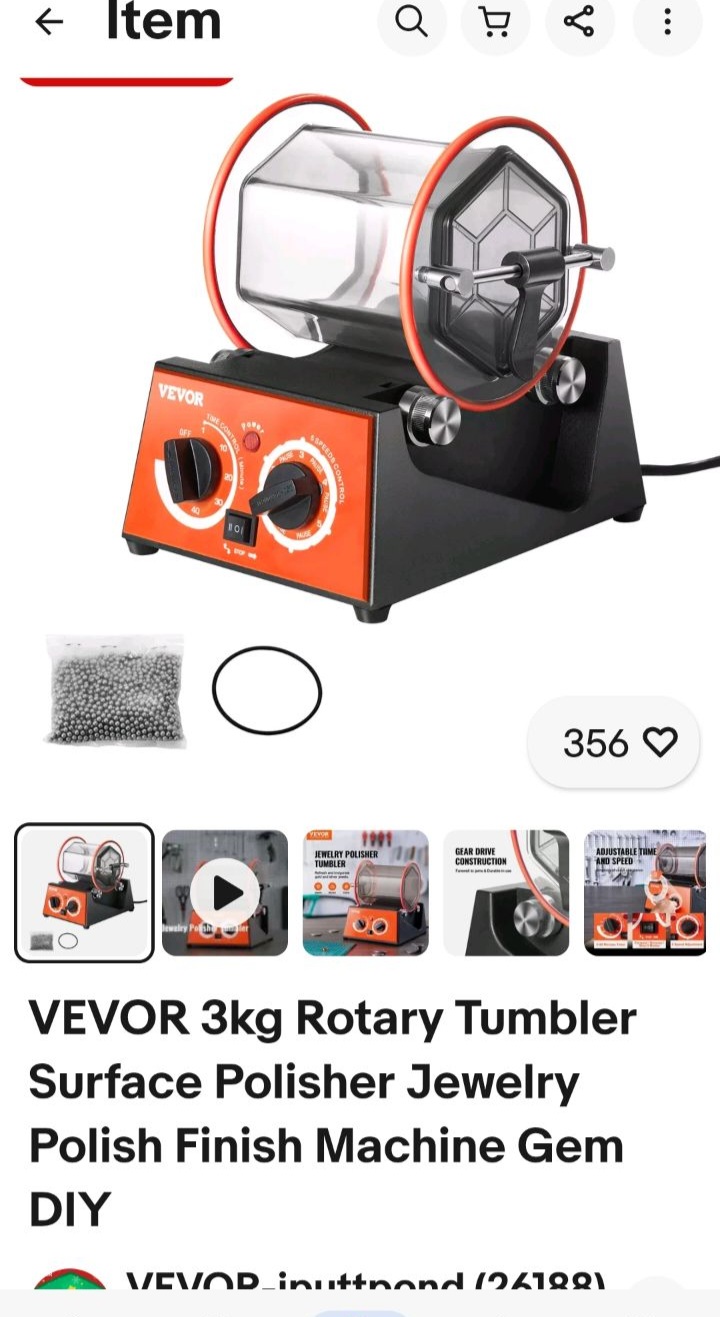

I just gave up and tumble all my decapped brass, using SS pins, a teaspoon of citric acid, and a squirter of commercial car wash 'n wax. This stuff stops the cases spotting or corroding afterwards too.
Decapped because the primer pockets are perfectly cleaned too, not a speck of carbon or crap anywhere.
Yeah I know, tumblers cost way more than Aldi ultrasonic cleaners. But the results aren't what I'm after, at least I can't get them. Maybe my troglodytic misdemeanour prevents me from solving life's issues.

Re: Ultrasonic cleaner
Post by Oldbloke » 25 Jan 2025, 10:35 am
Ebay $80

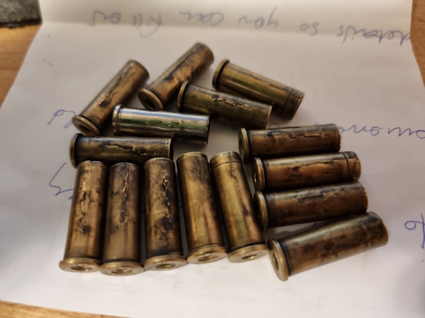

Post by bladeracer » 25 Jan 2025, 12:27 pm
Robin wrote:Is a Ultra sonic cleaner worth it.
Depends how you look at it. 1,000s out there never clean or tumble. Some swear it's important.
IMO it's mostly bling but does help to see faults, cracks etc. I just clean in an Aldi one if it looks grubby these days.
How much do you pay for brass if you lose it hunting? How much less will you lose if it's shiny?
I think tumblers start at about $100. Some buy cheap ebay tumblers.
I've never cleaned brass, not even IPSC brass which really gets filthy. I'm shooting .38's every week and just reloading the same ones each time so they're getting worked hard. I'm losing several every time, and the rate is increasing as the loads add up. I culled three or four that I don't think will hold a bullet any more but this batch is getting loaded for another go.
I used factory ammo in a Cowboy shoot last week and lost six cases in the grass. This morning I fired 76rds of 9mm and came home with 75 cases, not too bad. I clean up my .22 brass every time I shoot so I don't mind having to fossick around hunting them.
