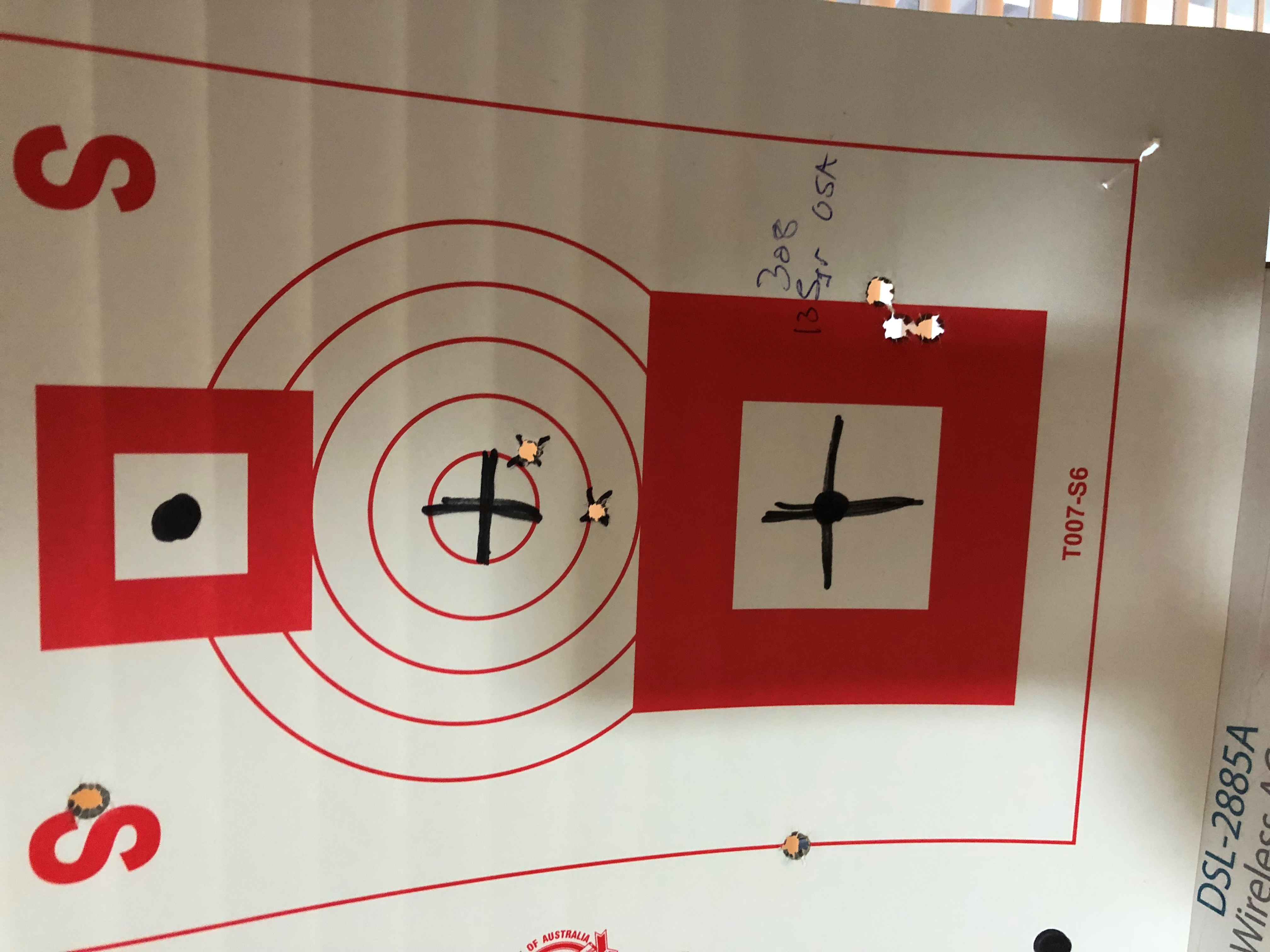

I found that when I did load development with these projectiles, that my loads were slower than the pre-loaded ADI offerings. I think they use "Proprietary' powders.
If you aren't going to shoot lots of them, perhaps the pre-loaded stuff from ADI may save you a lot of stuffing around with load development.
I found the pre-loaded ADI 135gr were giving mw about an inch at 200 meters in my rifle. See pic below.
135gr ADI 308.JPG (370.92 KiB) Viewed 39 times
