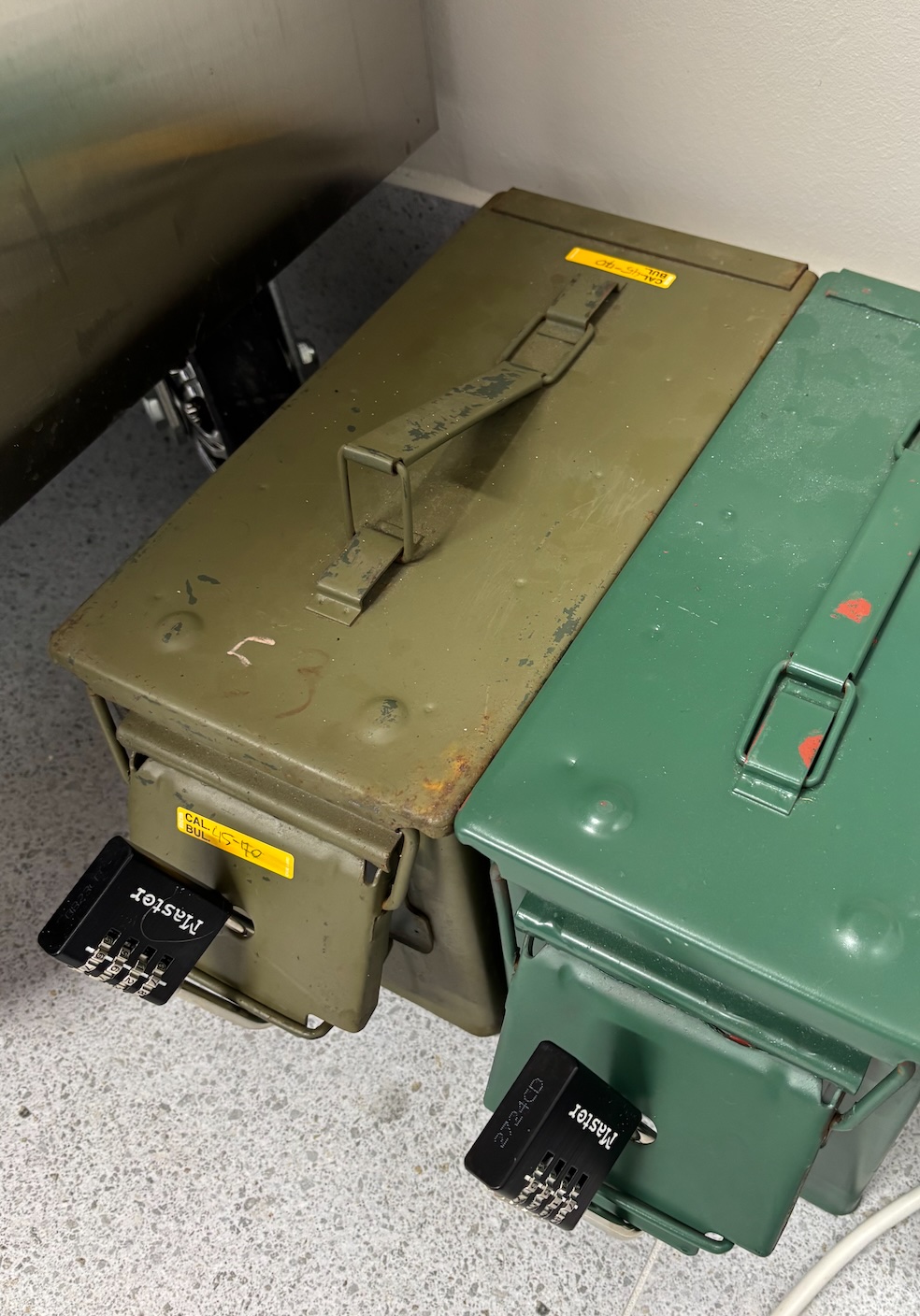

I think most shooters should invest in the 50 call ammo boxes to store primers and rounds, check them by closing them and submerging them in water for about 1 hour to see if water gets in or if there are bubbles, if not it's a good can (have not seen a bad one yet), and yes throw a few silica gel packs in there if you really want to, make sure you put them in the oven for a few hours at say 40 degrees (plate warming function if you oven has one) and happy days.

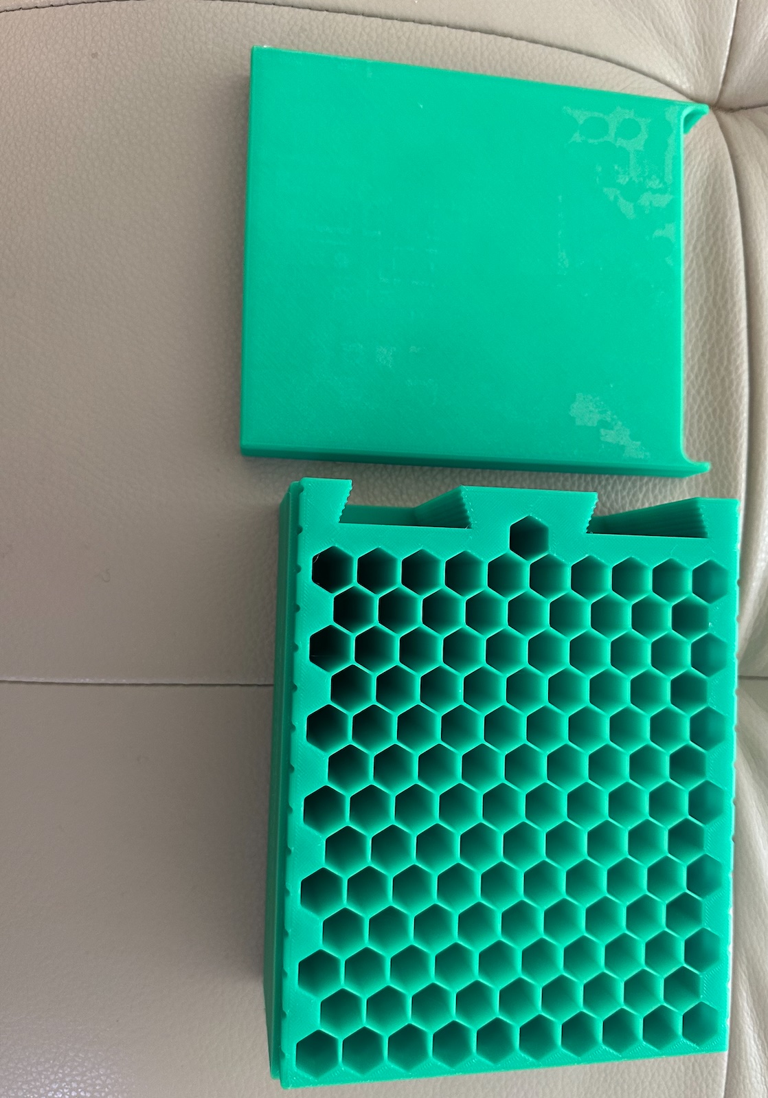

3d printed some honeycomb insert into the 50cal box, can fit 125x .308/6.5 creed rounds in very very little space, I think 400 rounds easy with some room to spare
Those 50 cal and 30 cal ex military ammo boxes are fantastic to store thinks long time, just use a long shank lock, see image
